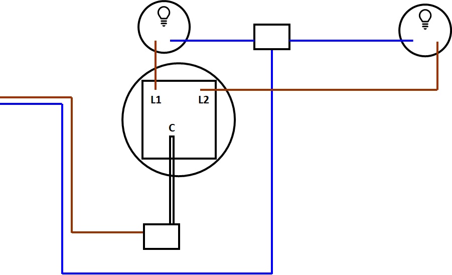

Hi all
I currently have one light in my loft operated by one pull switch and I wanted to add an extra light operated off of the same pull switch.
I've managed to wire it up so that both lights work, however when I pull the switch it turns one light on and the other one off. Another pull does the same but in the opposite way - mening that at least one light is always on(!) :oops:
It's currently wired up as per the diagram. How do I fix this so that one pull will turn both lights on and off together?
All help appreciated :giggle:
