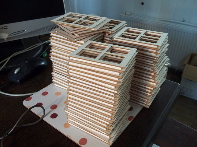

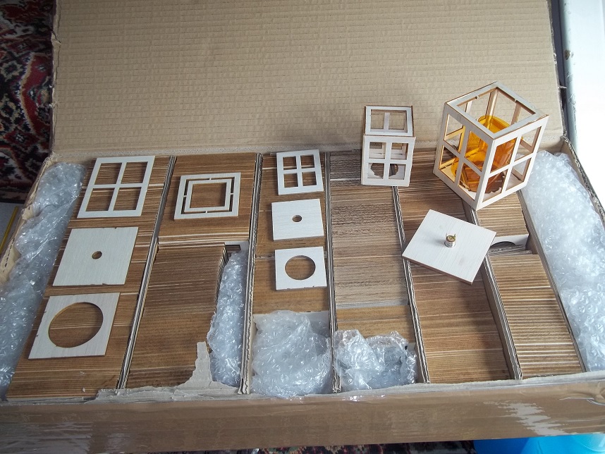

For my daughter's wedding I am making 100 lanterns. The parts which have been laser cut from sheet balsa wood arrived yesterday. The two assembled laterns are the prototypes to prove the design before the 100 sets were cut. The larger lanterns will have 3 watt 12 volt lamps and be hung around the trees at the venue. Some of the small lanterns will be "hand held" on wands with an LED lamp and battery in the handle. Others will be 2 watt 12 volt.
The "glass" is thin slightly diffusing plastic and 400 pieces have to be cut by hand.
8 larger 10 watt lanterns for the BarBQ area will be hand cut from ply wood.

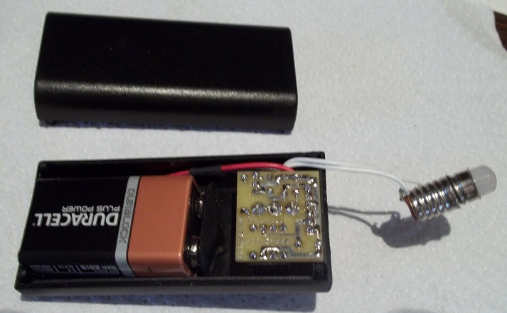

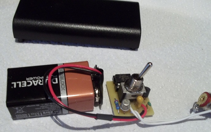

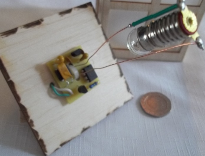

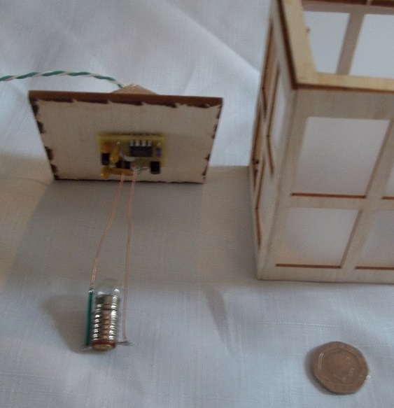

The battery saving circuit for the hand held lanterns has been tested and it will give over 4 days flickering candle effect from a PP3 battery. Uses a PIC processor to create pulse width modulation with a pseudo random number generator controlling the PWM value. The lamp is a MES 12 volt LED warm white but still needs a bit of amber filter to add a tinge of yellow to the "flame". PCB is 0.85" by 1.025" so fits in the handle with the battery. Just need to get them made and then assembled.
The same PWM circuit but with a bridge rectifier and a fuse added will be used to flicker effect the 12 volt 200 mA incandescent lamps in the lanterns that will be hung around the trees in the orchard. These will be fed either from mains via wound transformer if cable route possible or a car battery
Using different maximum and minimum values for the pseudo random number generator allows the same hardware to support the different needs of the LEDs and incandescents. Processor is the 8 pin MicroChip 10F200

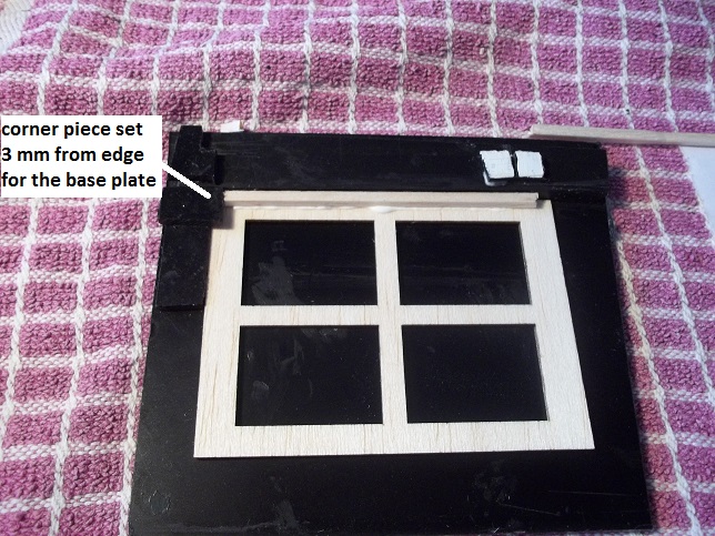

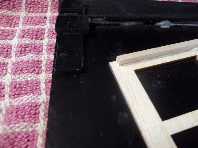

Corner piece fitted to a side panel. The 3mm offset is to allow the base plate to be fitted
almost 160 side panels with corners fitted

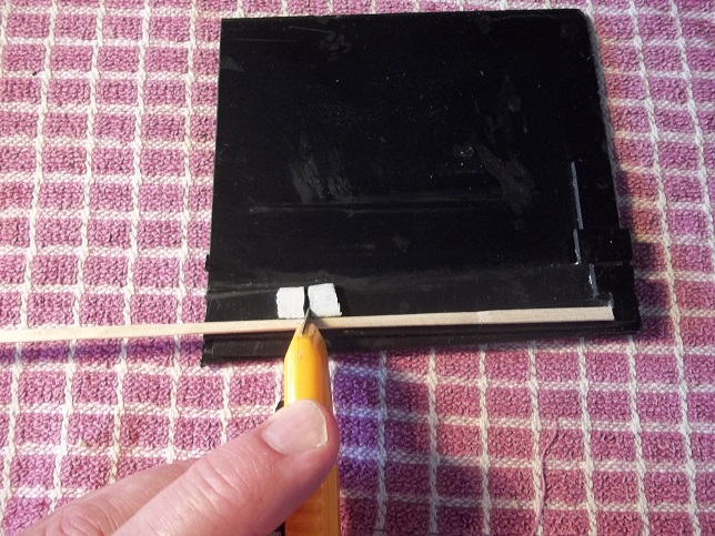

this jig to set the 3mm was worth the effort to make it
the white bit is the knife guide to cut the corner pieces accurately

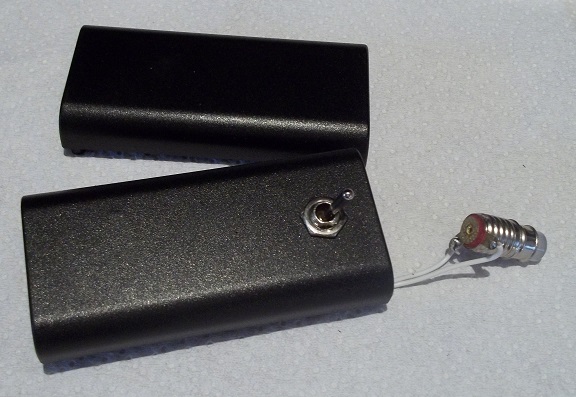

The battery box for the hand held lanterns.
This PCB controls the LED lamp to create a flickering flame effect.

The battery boxes will be the handle at the end of the wand.

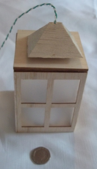

A small oversight was how to cut the pyramid tops for the lanterns. Too much attention the electronics and not enough on the final assembly. ( Hence the thread looking for mini mitre saws that wouldn't cost the earth ).
After some experimenting I have decided to use my large mitre saw to cut the balsa pyramids to a few milli-metre over size and then sand down to the right size. Hopefully the ragged cut edges will not be more than a milli-metre or two and dis-appear during the sanding.

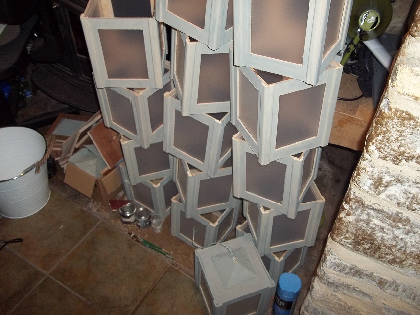

The next task is lamping the 15 large lanterns to be used around the venue grounds

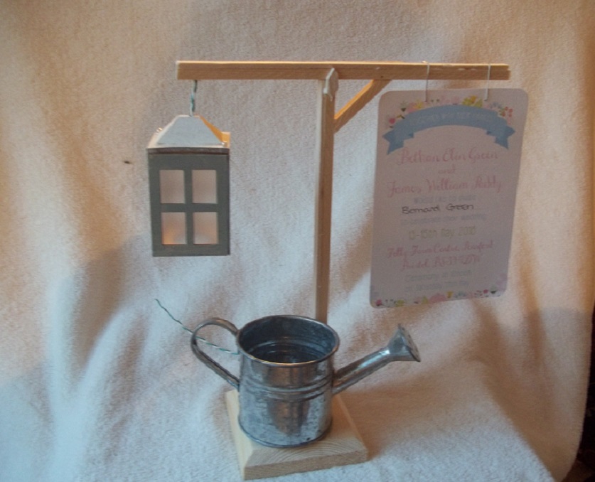

The prototype table decoration, A battery fitted into the base powered the LED and there were flowers in the watering can. The signs were the table names on the day
