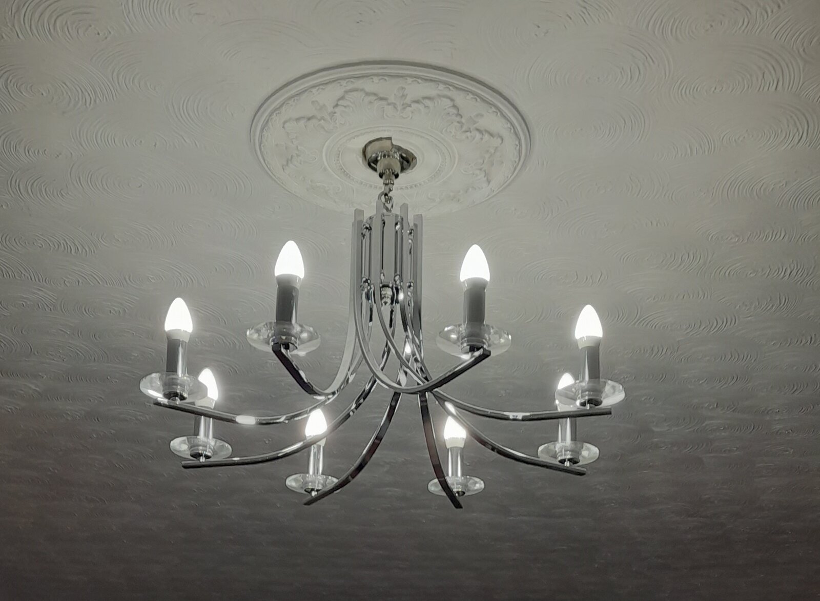

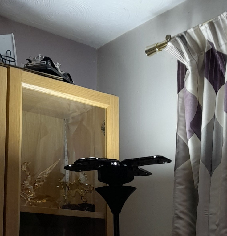

My wife wanted more light, and got this 1739454792869.png the arms fold so can direct the light where needed, seen here used as an up-light, the problem is the old tungsten bulb directed light in nearly every direction, but the new LED directs most of the light away from the base, so a chandelier like this Ceiling light.jpg shines up onto a white ceiling, giving a good spread of light, but with the bulbs other way up, most the light is absorbed by the dark carpet.

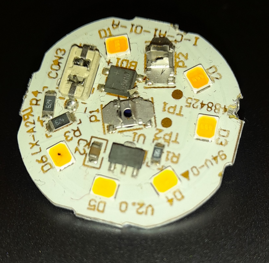

Talking about lumen is great, but only if the light goes out in the same direction, inside one of those chandelier bulbs we have bulb inner1.png so even if the cover is shaped as a candle, the light is defused a little by the cover, but most of the light goes away from the bulb base.
