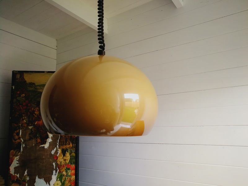

Second, having that hanging over a table - assuming this is domestic and not a banquetting hall - you will not be wanting massive light output. We still have a 70's rise and fall big ball, over out 9ft long dining table. Initially I used a 100W bulb but it was far too bright, we now have a 60W and dimmer.

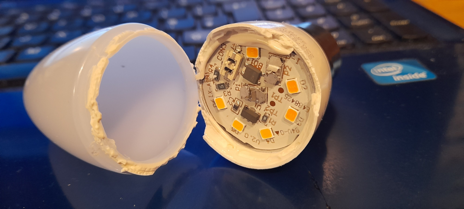

So the same fitting with LED, CFL, and Tungsten will get hot in different areas, the pearl dome of the LED candle bulb is likely empty, 1663197914090.png the chips are before the dome, so the base gets warmer and the plastic which replaces the glass runs rather cool.
Look at a range of LED bulbs and the lumen per watt can vary from 60 - 110, so one LED bulb can end up twice as hot as another with same rating.
But if the shade says 25 watt then that is the limit be it LED, CFL, or Tungsten, it is watts that matter not the lumen.
