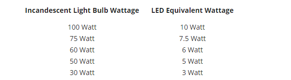

I have a question about bulb suitability for a chandelier ceiling light.
The chandelier uses 3 candle type bulbs. It says on the chandelier Max 40W.
However, now that bulbs are LED the wattage is different to the older type of bulbs. i.e a 25-watt LED bulb is similar wattage to a higher wattage bulb previously.
Would 40-watt LED bulbs be suitable to use in the chandelier or would the wattage be too high?
I'm not sure anybody makes a 40W LED in a candle lamp format.
120W of LED would be 'worth' around 800W of 'old' filament lamp (in round terms of 15W LED = ~100W incandescent)
Or do you mean LED equivalent of the 40W filament - that would be more like a 5W LED candle.
Found this table on the net....
much to high
5.5W is approx the equivalent to a 40W

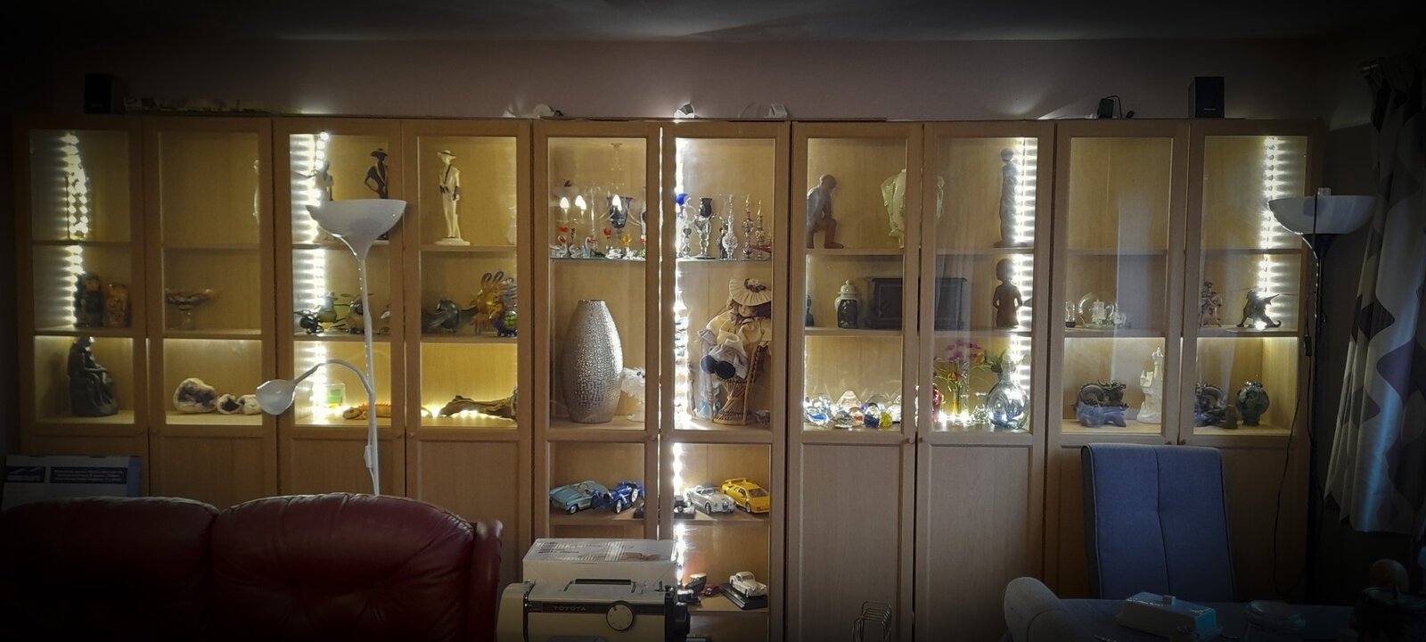

Moving to LED went for 8 x E14 bulbs, and to look reasonable need to be candle design, 6 watt seems around max size available. However not enough light, so supplement it with three 22 watt smart cabinet lights, I can turn these down, but in reality I am still using 100 watt with LED there has been no drop in power.

And what on earth are these "22W smart cabinet lights"? Are they so 'smart' that they emit far less light than one would expect of a 22W LED, and hence are suitable for use in cabinets? !
Oh yes well below 22 watt at lowest setting, in fact just looked and outer two rated 17 watt inner one is 22 watt 20230227_163006.jpg although primary to light the ornaments, turned to white and set high, they light the room well.
Oh yes well below 22 watt at lowest setting, in fact just looked and outer two rated 17 watt inner one is 22 watt although primary to light the ornaments, turned to white and set high, they light the room well.
Fair enough I must say that I would have thought that 2W, let alone 22W, would be far too much light to illuminate ornamets from a few inches away!!

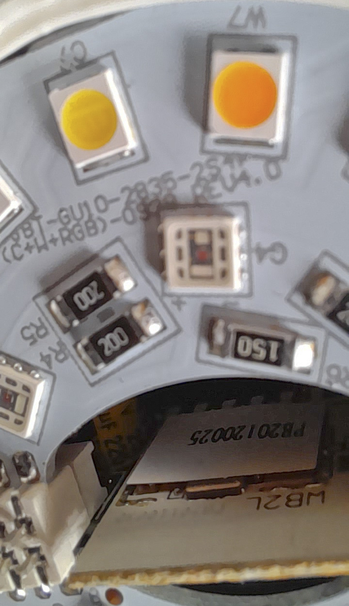

...although if they are RGB strips, their efficiency producing 'white' light is significantly reduced, over an RGBW strip.

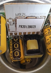

Not really looked at the TCP ones, but the Livarno has three sets of LED's, one colour, one low temperature white and one high temperature white. So when on white light the colour LED's are not lit, and as you adjust the colour temperature of the white light one set dims down and the other set goes brighter.
The strip can produce way over the rated 22 watt, but the controller will not allow both the low and high temperature LED to be fully powered together. It is likely the same with bulbs, but the defuser plastic over the LED's does not let you see what is there. 20220603_113543_1.jpg This is a GU10 I ripped open and it seems to show the three chips in the same way as with the strip lamp. The control circuits seem quite complex 20220603_113820_small.jpg which may explain why I have more failures with smart bulbs than standard bulbs. However the old idea of a dimming switch no longer works, as when you dim an LED the colour temperature remains static, so to get the ambiance it needs to be a smart bulb so you can also change the colour when dimming.
