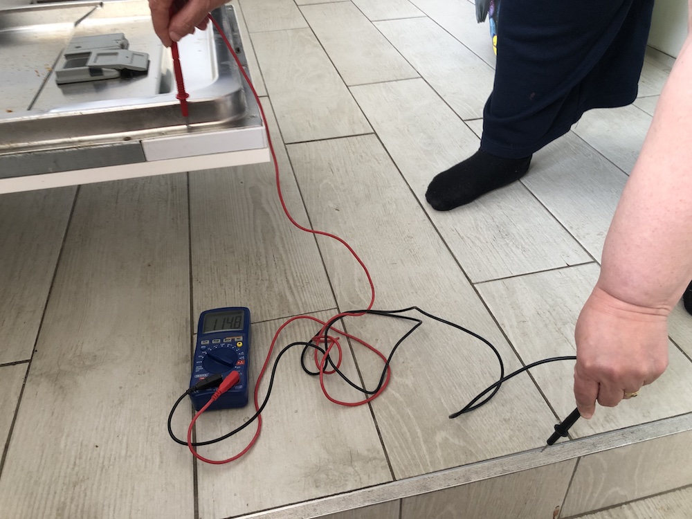

I was lying on the floor trying to inspect the bottom hinges of the dishwasher door, as it was sticking, and I suddenly felt like I'd had something jabbed into my leg by the tile edging. I couldn't see or feel anything on the edging that would cause that, so I went back to what I was doing, and it happened again.
Cut to the chase, it was only happening when I had my hand on the metal inner of the dishwasher door and my bare leg was touching the edging.
My multimeter appears to be showing 115V AC between the two.
So how does that happen? How has the edging apparently become part of a circuit?
EDIT - I've also confirmed that there's 115V between the door and the washing machine, and the door and the sink. We've been living here for a year now, and I've only discovered this by pure chance.

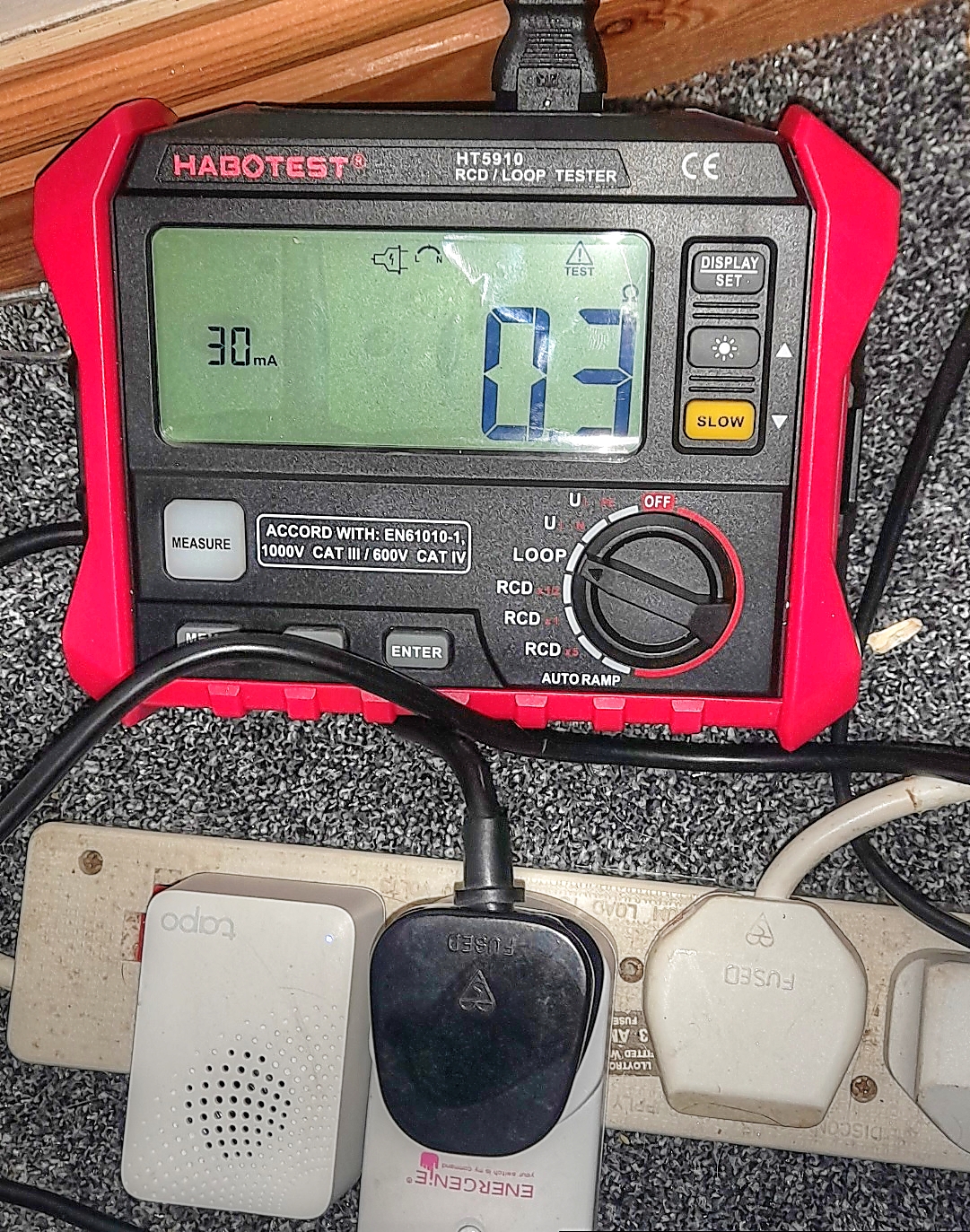

But as to DIY repair, not so sure? I would plug my tester into the socket supplying the dish washer Loop-test.jpg do a loop test, and also RCD test, but most DIY people will not have a meter to do that with. I would also test earth pin to neutral pin on the dish washers (not line as that may be switched off) with this meter VC60B.jpg but same as with loop impedance and RCD tester, how many DIY people have an insulation tester, I would test on 250 volt range, as there may be a filter which could pass on 500 volt range.

However I am not happy trying to instruct a DIY person on how to safely measure this. Even a plug in tester 1748872308252.png may be enough to work it out, but even they have a £54 price tag, and a proper tester 1748872458543.png only £13.71 more, so seems daft to get a tester which is not rated for use on ring finals.

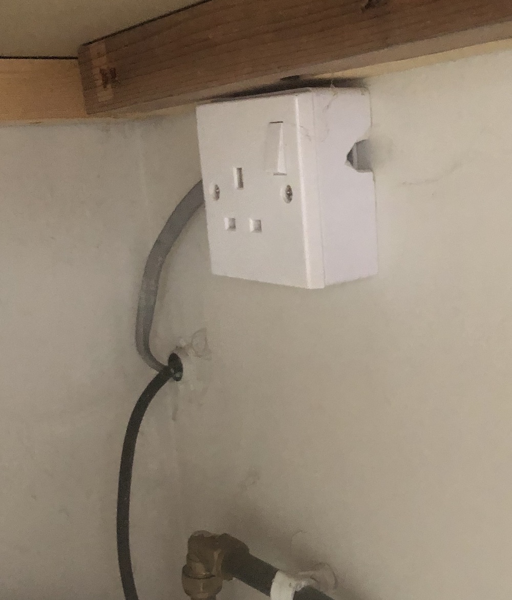

Thanks all for the input. I picked up a socket tester on the way home from work, and confirmed that all the kitchen sockets are fine except the dishwasher one, which has an earth fault.
It does rather look like the dishwasher socket was fitted as an afterthought by Uncle Bob rather than a professional; the others are all chased into the wall. In the photo below, the black cable coming out of the conduit is the dishwasher mains; the unit itself is on the other side of the brick pillar the socket is attached to.

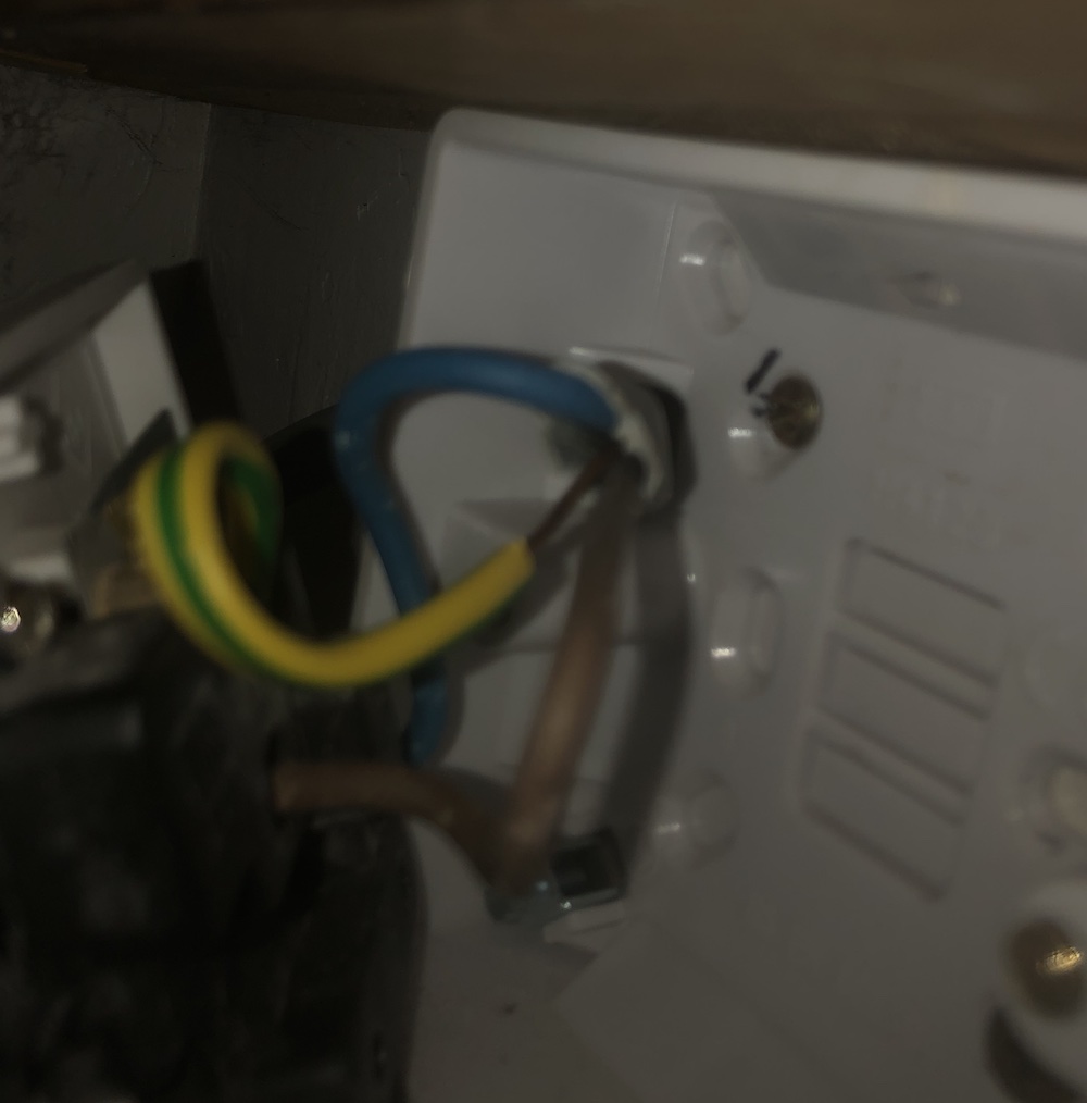

Having opened it up, the earth wire is connected, so presumably it's either a break or an ungrounded other end. I can't get to that other end because I haven't worked out how to get the dishwasher out from under the counter without breaking anything. On closer inspection, the insulation on the earth wire stops before it disappears into the main grey sleeve, which is a bit disconcerting.
For now, I've got the washing machine and dishwasher on the same socket, with instructions to the family not to run both at the same time. I've measured, and there are no unpleasant voltages hanging around any more.
It's not particularly abnormal. In this country "twin and earth" cable has a bare earth wire, and the "done thing" is to sleeve it at terminations to identify it as an earth wire, and to reduce the risk of accidental contact with live parts, but the sleeving and/or the cable often moves around a bit leaving a gap.
