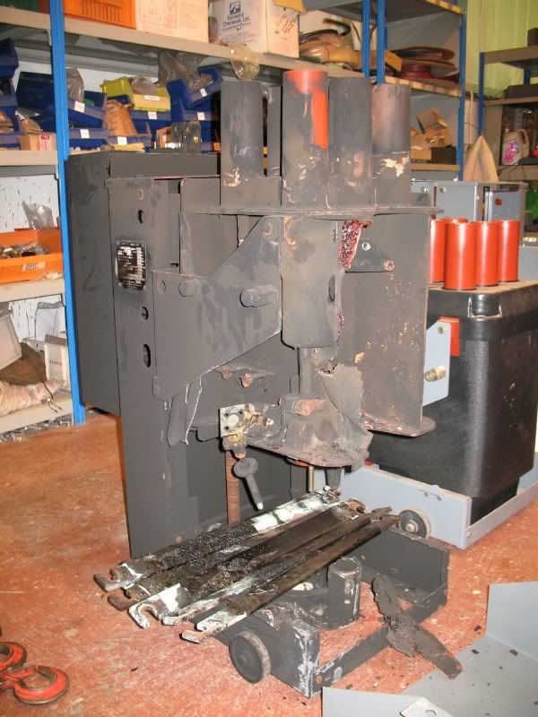

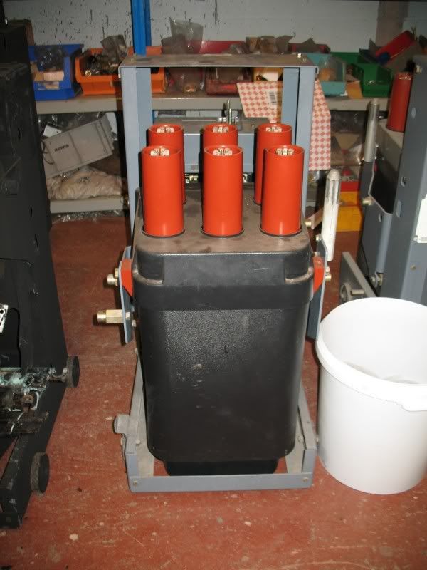

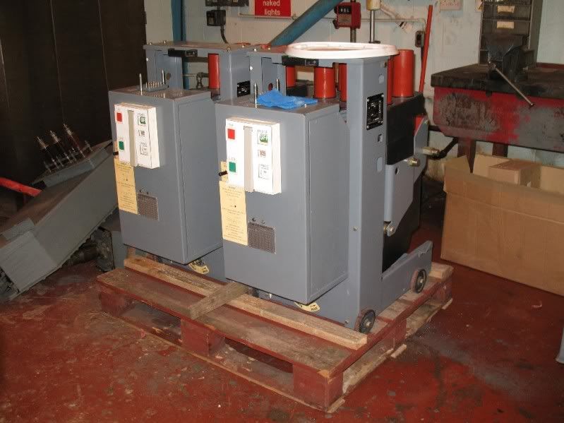

Heres a pic of a Healthy 11kv Vacum Circuit Breaker....

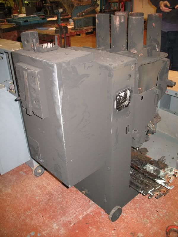

and heres a pic of what happens when one decides to let go!!!

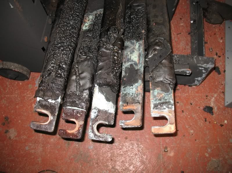

The actual contacts have all gone, and the ceramic pots and associated insulation parts too and even the 11kv Busbars have had a good toasting!!!. Not too sure what caused this yet!!!

Hermetically Sealed?
Holmslaw, thats what I am suggesting as we used to call some DB's by that abbreviation when I used to build them years ago.
It may mean something else in this case.
Lets see if wingcoax agrees.
Wingcoax is spot on, they are the Busbars that interconnect each HV panel, one per phase
So you have 3 phase, 1 Ntl and 1 Earth.
looking at the one on the left, the 'locking' mark, (where they have been bolted), is elongated compared to the next 2.
Possible it was inverted on installation and 'worked loose' thereby dropping down and shorting out the panel?
