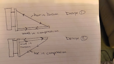

A rigid bar is also an option.
Yeah except that bar is going in the wrong direction
if your gate is the same as the posted picture I dare say it'll cease sagging if you cut it in half and have two gate posts..
Do the braces attach securely (bolted through) every horizontal bar?
Depends on the design. In simplistic terms gates are structurally designed in one of 2 ways and then infilled to act as a barrier

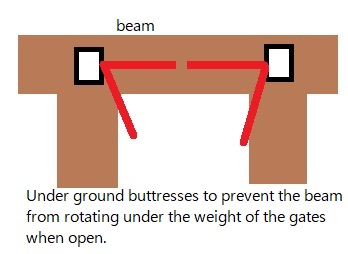

This was the poured concrect foundation required for a pair of posts where soft earth had previously allowed the posts to move in the ground

As with any gate of such a span, bloody great posts are essential.

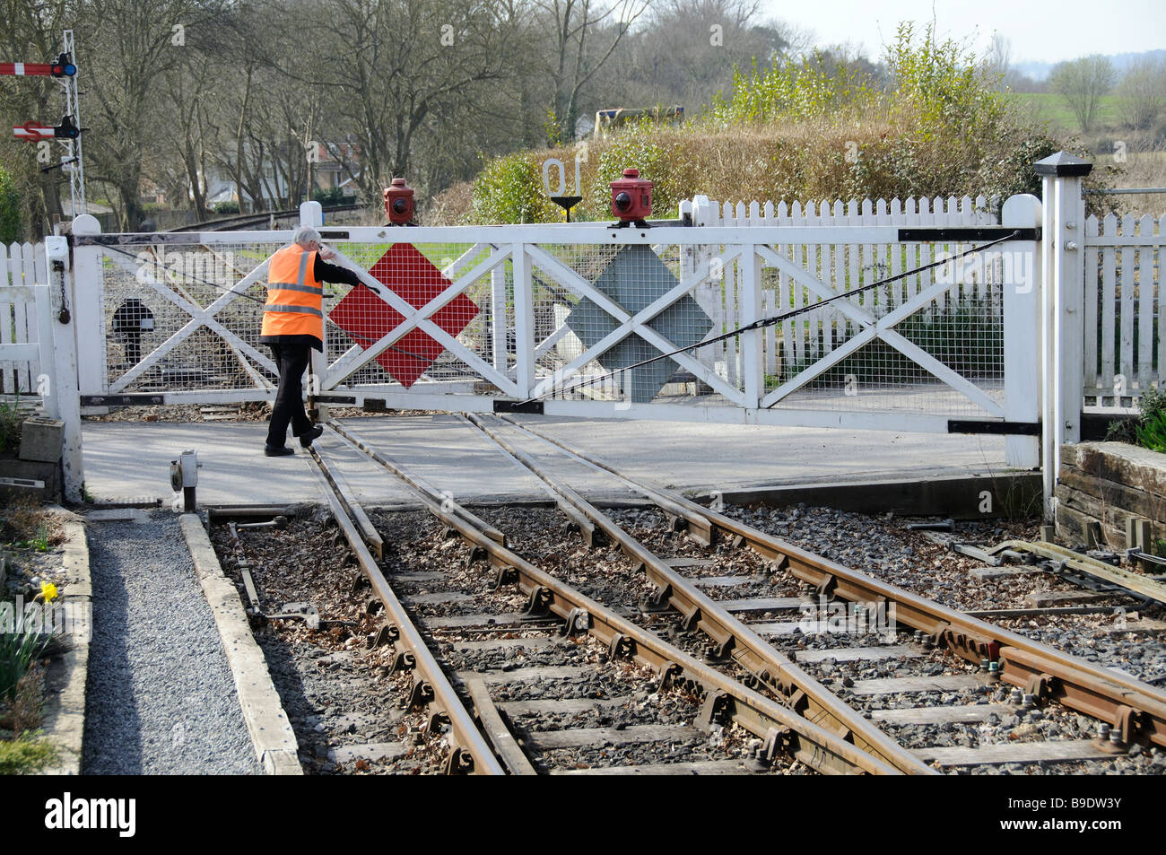

I think old railway crossing gates were made with steel rods in tension across the diagonals, with a nut to adjust them.
