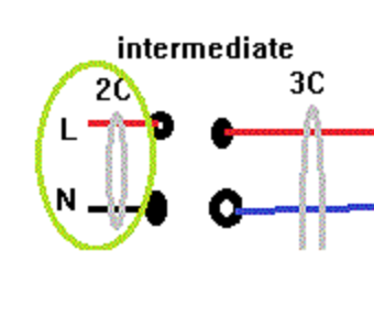

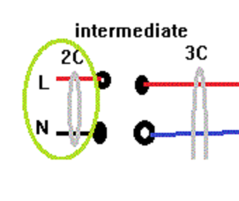

Yes Example from last year:
This was a very old office with some recent additions, I've added the green circles where the 2 sets of L&N enter the system. ignore the filing room lamp and switch as it was wired wrong (that was the fault and the reason I was looking).
This is NOT a good idea. An intermediate switch can put transient short circuit across the strappers as it is switching.
In your diagram this could be a short between L and N
This is not something I've ever encountered, and i've quite often seen standard intermediate switches used to reverse 3ph or DC motors.
The only problem encountered in the above system was the 'Filing Room' didn't always work (Moving the brown wire from the intermediate switch to the brown/red junction resolved it).
Same here, and given that they cannot know for what purposes they might be used, I would be surprised if manufacturers (at least, 'responsible' ones) would make intermediate switches which potentially suffered from the issue which Bernard mentioned.
