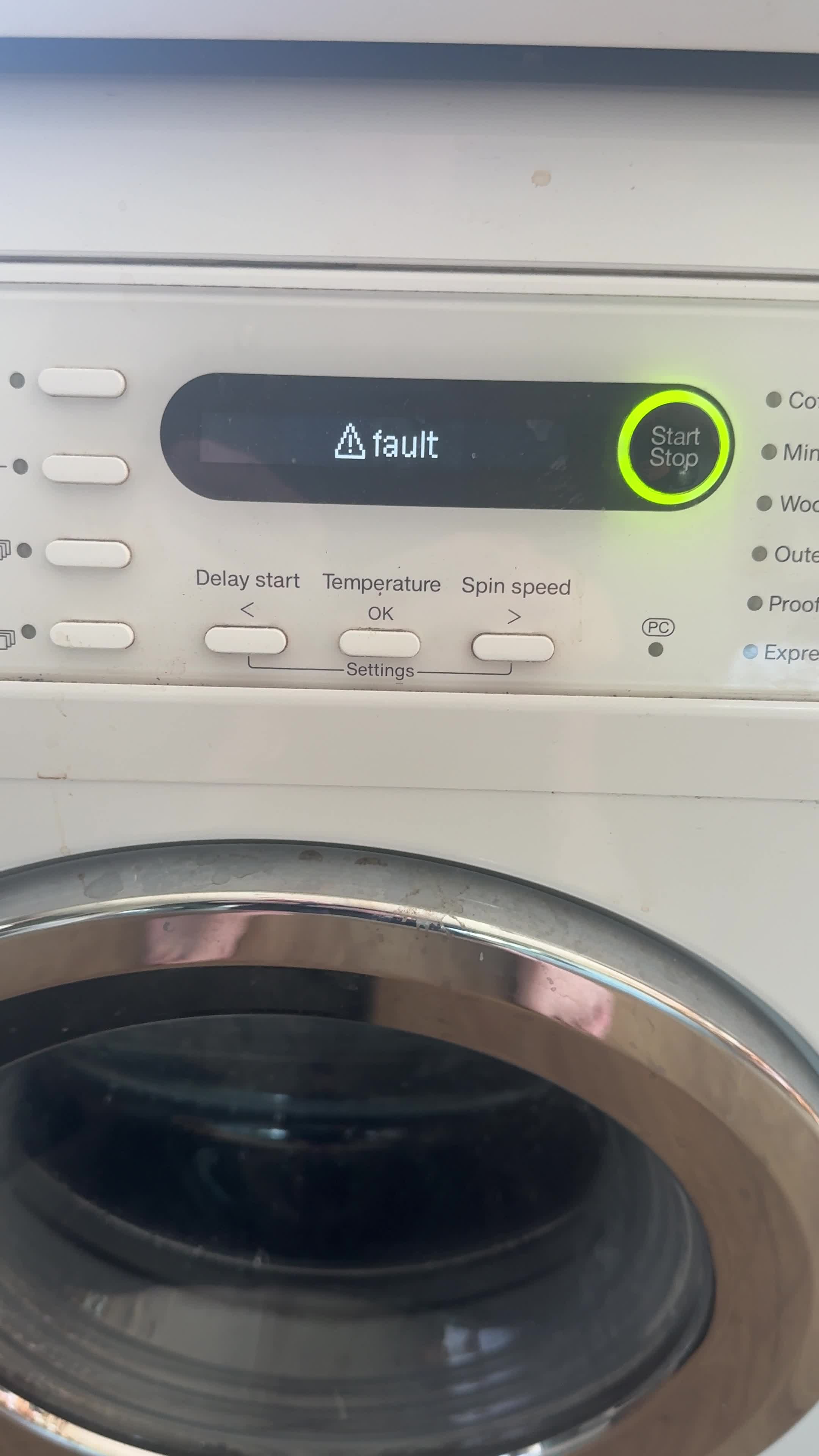

Our 14 year old Miele washing machine is playing up. Works fine but when draining on a wash or rinse programme, it pumps the water out as normal (can hear the rushing and gurgling in sink trap) and then while it’s pumping the last 2% of water out, it pumps for a while and then an alarm comes on and it shows up 'drain fault' on the display. Having the trap door down and the pump cover removed, I can see the pump running and it still says drain fault.
Cleaned out the filter and checked drain hose and sink connector is not blocked. Only thing is, pull back the seal and there is a ton of heavy limescale all round the seal/drum. Gawd knows what it’s like inside!
I might try stripping it down when we get back from holiday but I don’t want to pay £189 plus parts from Miele or £299 for a fixed price repair due to the age of it - I’d rather put that towards the price of a new one.
Any ideas? Is cutting my losses and buying a new one the right thing if I can’t see anything obvious when I strip it?
Because you can hear water rushing into the sink and can see the pump impeller spinning, the pump motor itself is getting power and working. However, the machine is failing to clear that final 2% of water quickly enough to satisfy the timer. [1, 2, 3]

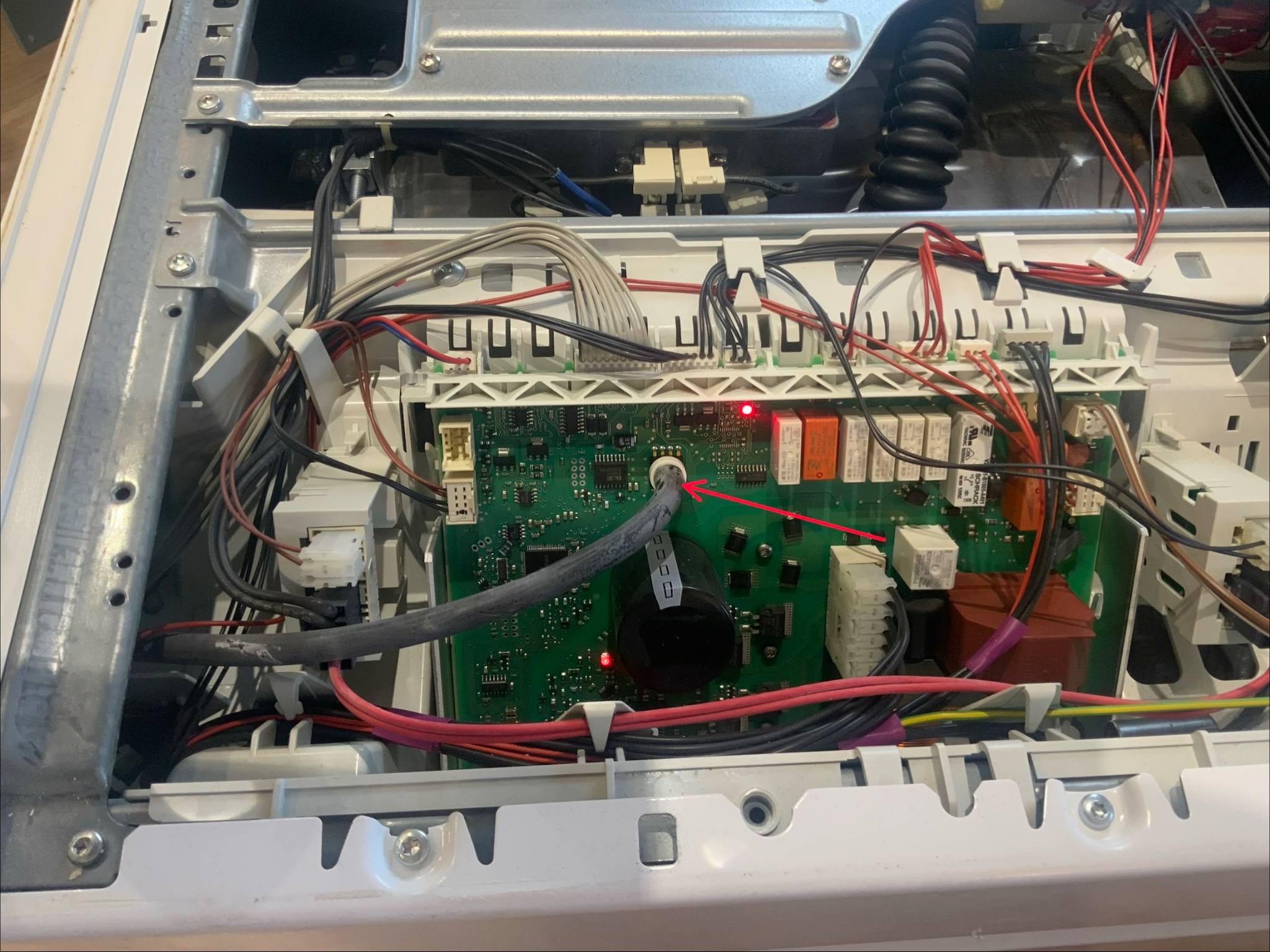

Thanks Andy. I think I’ve only gone and fixed it! I was Googling away and came across one of the possibilities in that list. Nothing to lose and if I fùcked it up it wouldn't matter as we are expecting to replace it anyway. I do remember having a problem with some sort of vacuum hose about 7 years ago while it was still under its 10 year warranty - it was filling and emptying at the same time. Anyway, the Miele engineer came out and fixed it under warranty.
I pulled the machine out, took the top off and right in front of me was the circuit board with a vacuum hose on it. I pulled the hose off and blew and sucked (ooh err!). Initially it was blocked both ways. Then I was able to suck and then blow. Completely cleared something from down the bottom of it. Put the pipe back on and it was pumping out and stopping with no faults. Got a load being washed now but I’m pretty hopeful. I’d have been gutted if I paid a Miele engineer £189 to come out and do that!
