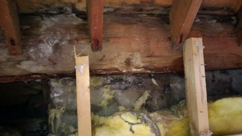

On gutting the place we discovered a mixture of suspended timber and solid floor and a mixture of block and red brick walls.
Further exploration shows some of the suspended timber floors have a concrete lined void other are soil. Those with soil have rot (wall plates could be snapped by hand!) and the red brick walls are solid, not cavity.

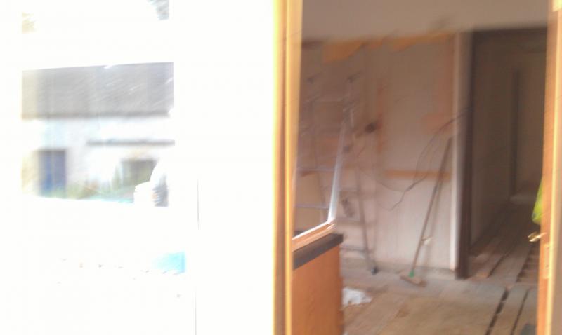

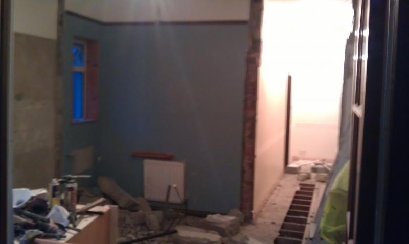

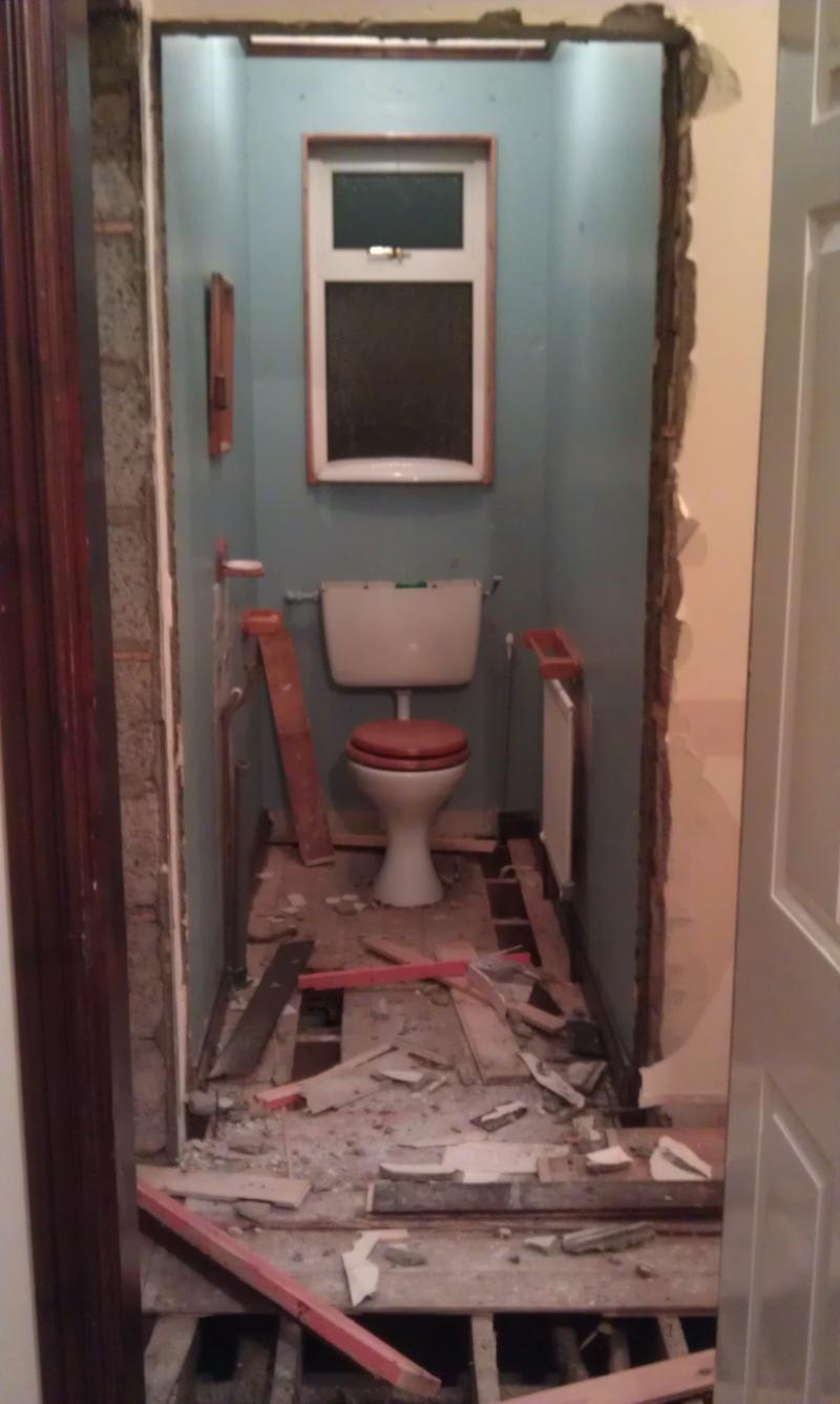

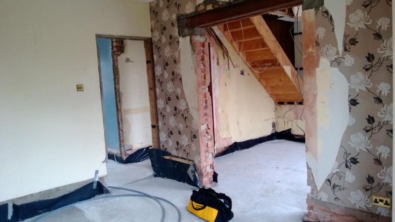

1.Take down wall between kitchen and WC (non supporting) to open kitchen up (done)
2.Create double door opening through supporting wall between 2 reception rooms (done)

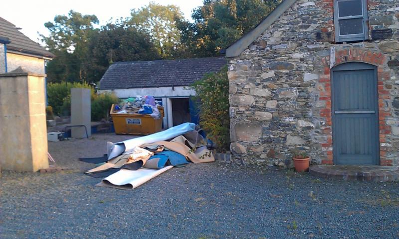

Clear out1
Clear out 2

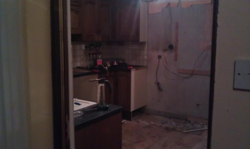

Old kitchen coming out
gone
Old WC
New larger kitchen

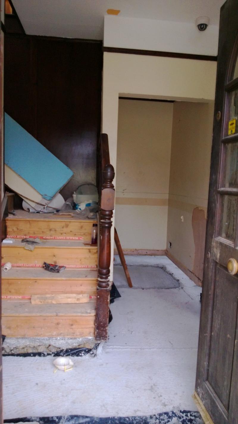

We have had to fit beams to support an internal wall for a doorway so have filed a building notice to get that signed off but werent getting inspector out until concrete is in. I was just about to post a question if changing floor construction is classed as notifiable works? Also worried when they are out they wont fail to notice the stairs and ask questions lol.

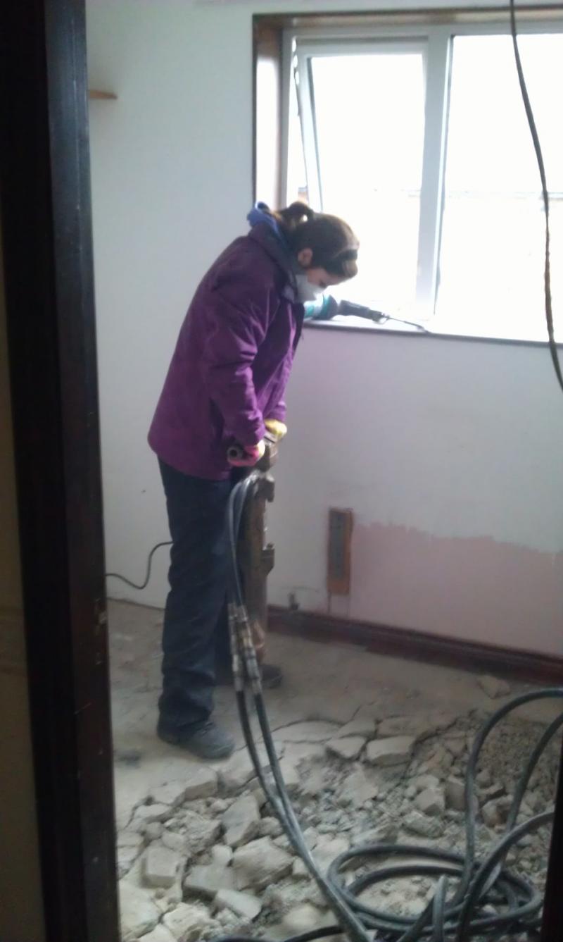

Have made a bit of dent in it since last update :D

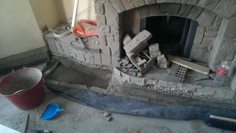

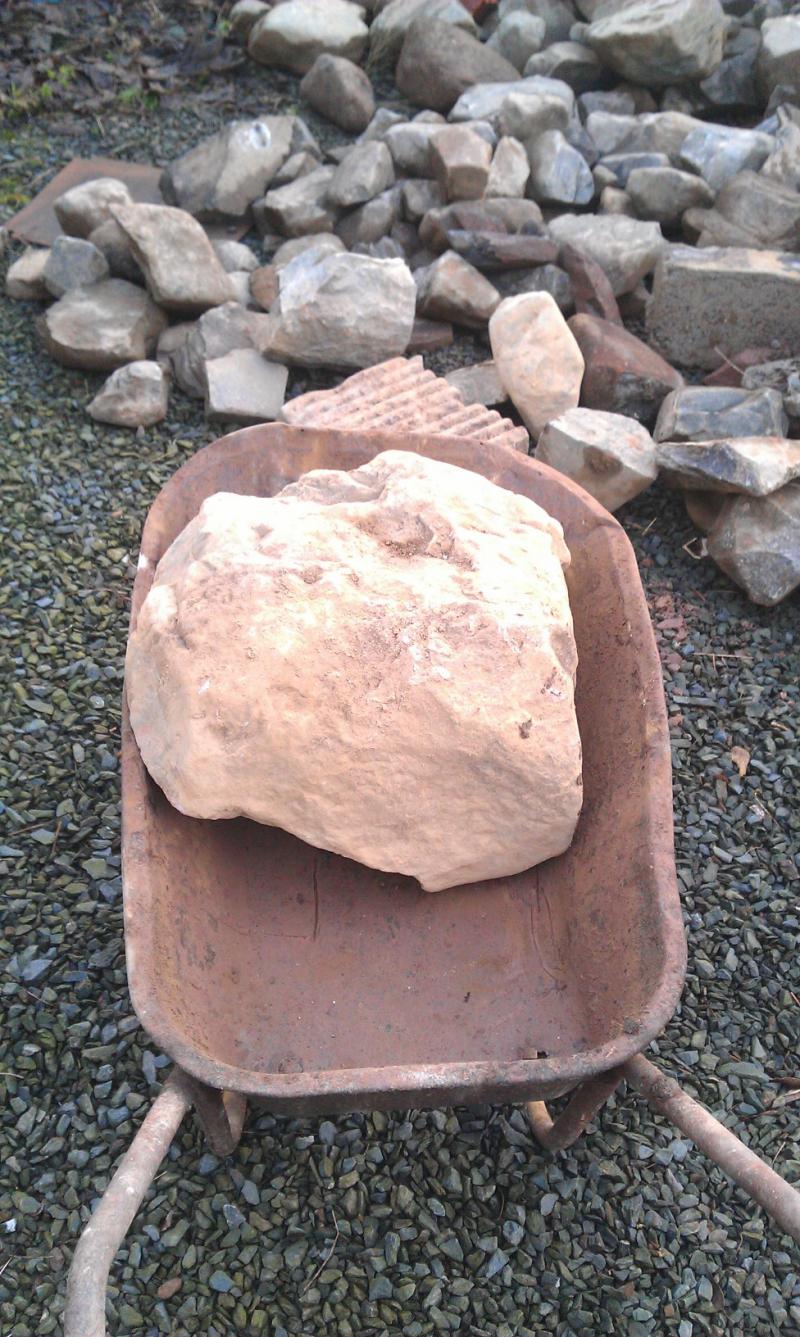

Floors removed and dug down as required -Other half getting her hands dirty
Some BIG stones to remove
House broken into :( alarm re-comissioned and CCTV installed :D

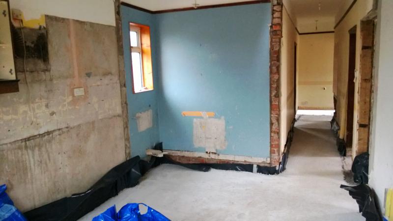

Concrete poured for sub floor

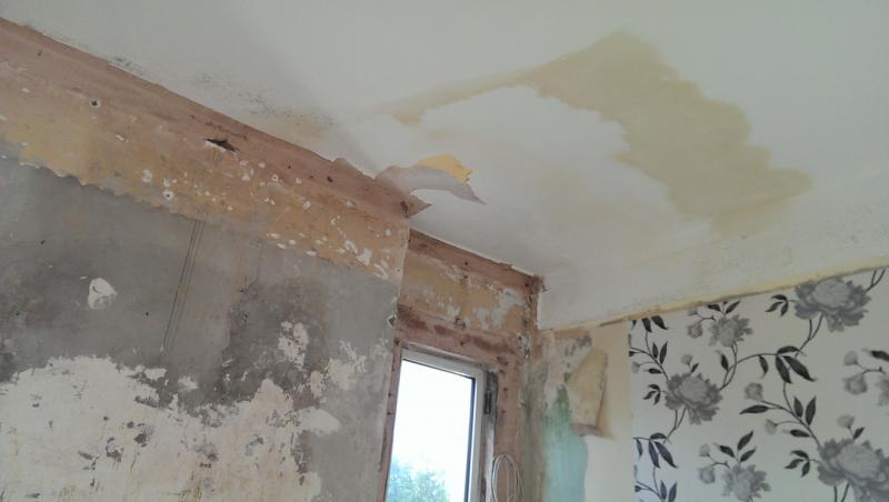

Discovered a crack in a chimney that letting in a fair bit of water, seems to have been there a while, crack sealed up for now hopefully dry this out a bit before we can repair it properly once the weather cooperates.

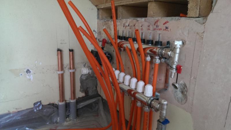

Working on first fix plumbing now so we can crack on with the insulation and UFH, finally get our screed in and hope to be liveable by end of March :D

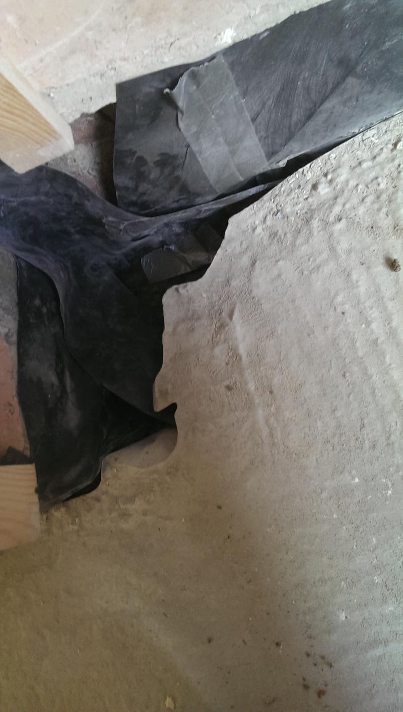

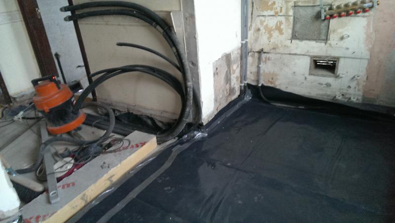

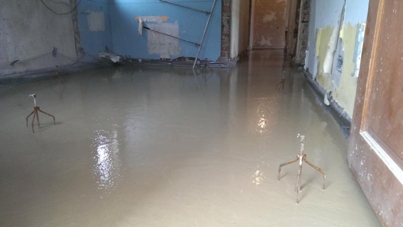

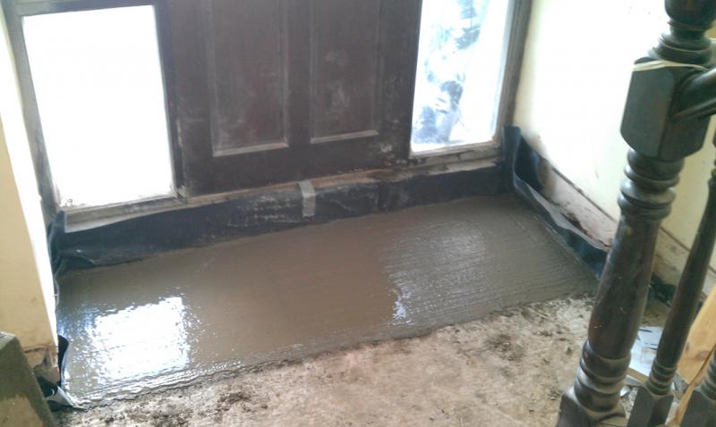

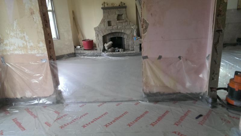

Had a lot of rework to do to the subfloor to get it to the spec i had asked for from the contractor :(. DPM had been pulled tight in a lot of places creating voids around the perimeter and very thin concrete, all had to be broken out and voids filled.
Wasnt level in places, upto 50mm from where we wanted it!
Meaning removing bit of floor we planned to keep

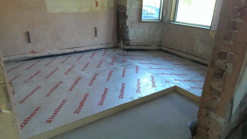

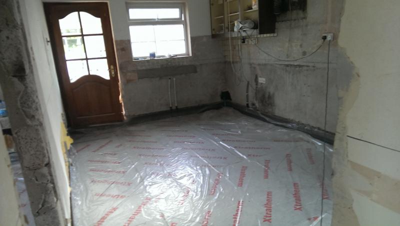

Floor wasnt very flat either causing the insulation boards to rock.
This required 9 bags of SLC to get to a point where the screeder was happy to warrenty his final floor.

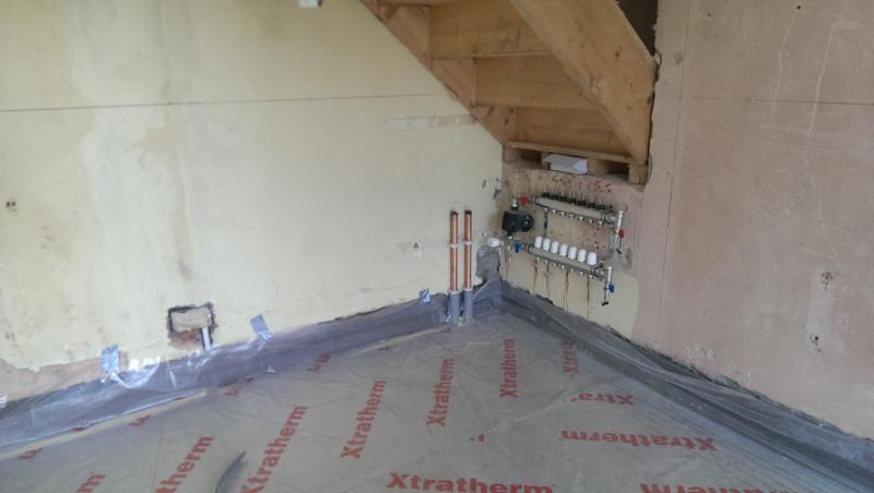

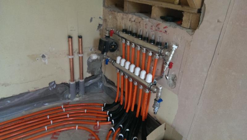

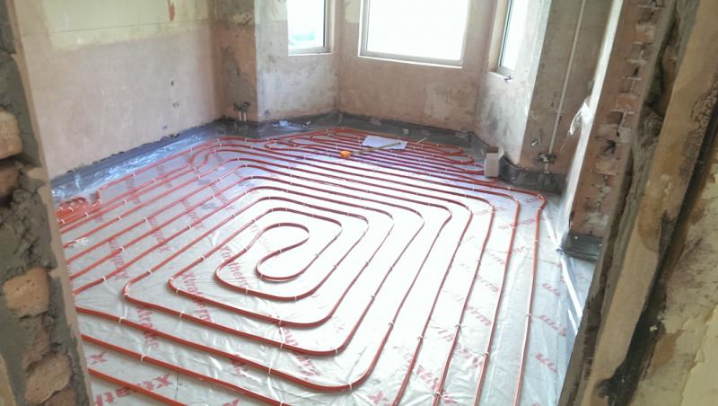

Insulation going in
some more rework
BBQ weather late June :D
tanking and edge strip insulation

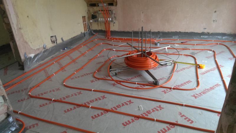

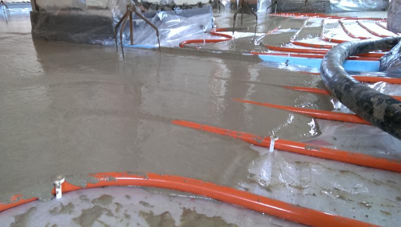

starting ufh install

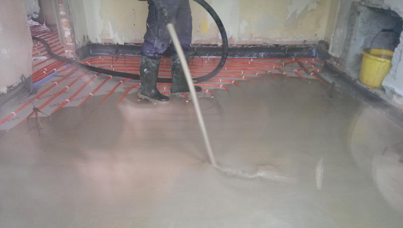

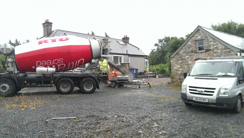

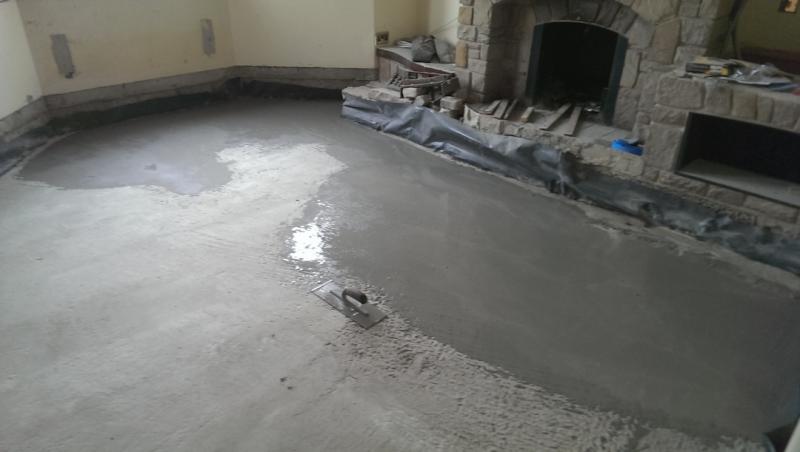

Screed going in :D
Now getting on with wiring the heating system and getting final positions for new sockets and switches etc before the spark comes back to finish off.

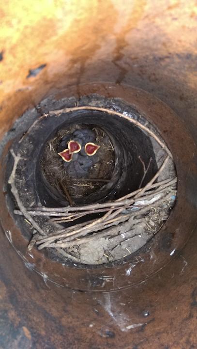

Still have the issue of the bad chimney
Causing this
Current plan is take it down and the close the roof off, but there is an over head electrical supply from a pole on the gable wall meaning scaffold access is at best extremely dodgy, waiting on quotes to move supply undergound.
