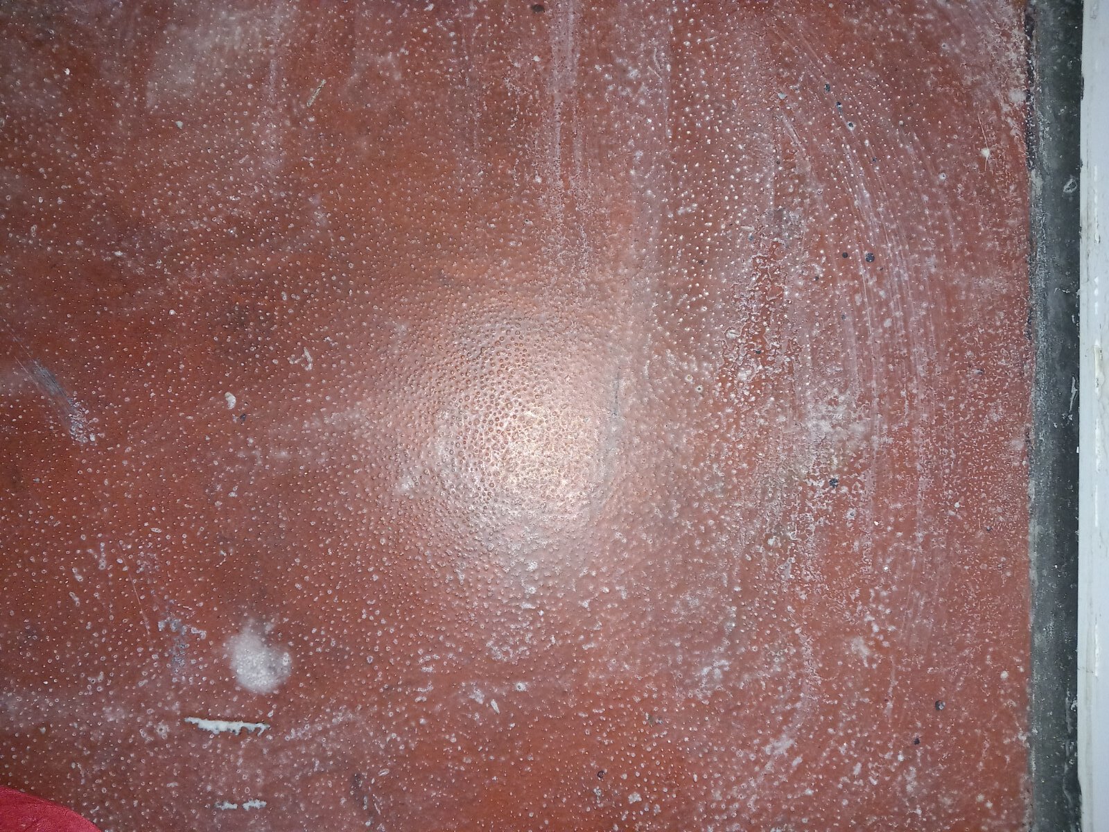

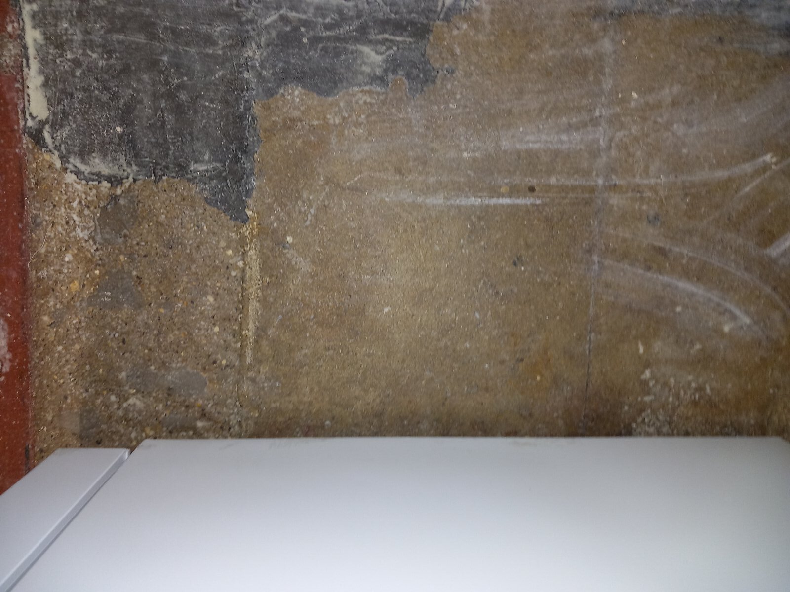

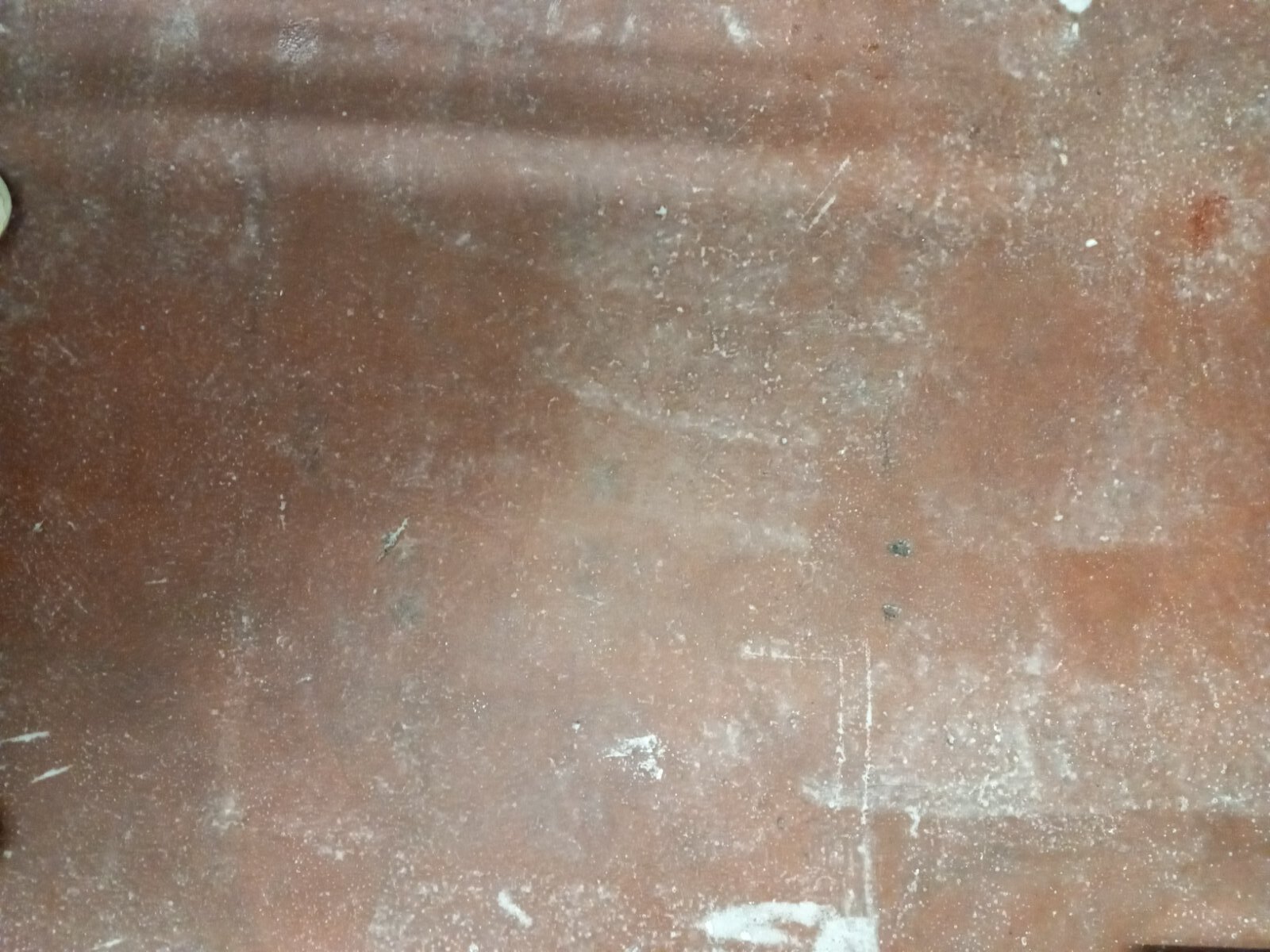

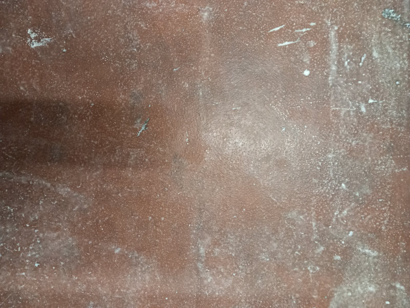

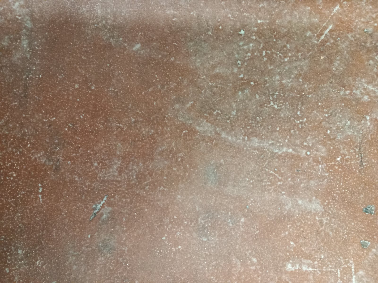

Hi, I am a new diyer and trying to install 600mmx600mm tiles on 1950 1960 red concerete subfloor in kitchen. Previous vinyl flooring was all removed and solid concerete was exposed. I have applied sikabond rapid dpm and now lost what to do as I planned to apply mapei primer g but just got to know it's water based so it won't help with mapei ultraplan 3240 self levelling. I will be tilling 7.7msq. With 600mmx600mm porcelain tiles using mapei super flexible s1 grey wall & tile adhesive. I have already purchased all mapei products.
I have attached some pics of how it looks like. It's no grity and slippery if water is dropped on it(doing what dpm is meant to do)

It’s hard to see in the photos. Could be magnesite but it would fail quick now you have a moisture suppressant on it. You should have used epoxy really.
You be best using a moisture tolerant compound now. Ardex na , fball 1200 pro , bosmtik cl955 advanced
Hi, thanks. Can I not use kiln dried sand to make it grity and work with those products? Or will this fail too?
