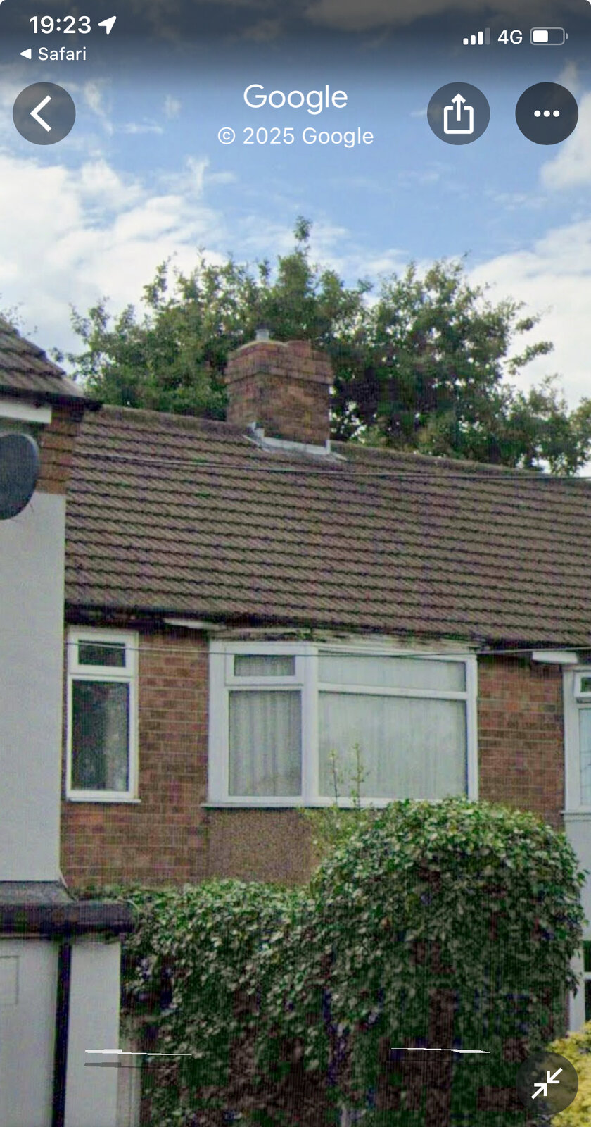

Hello!
Can somebody please suggest if and where asbestos might be found in the property below:
It’s a 1950s build that’s been left vacant for nearly 20 years. Refurbishment to be done DIY over many weeks, with an original external contractor for remedial stuff in the upstairs area (I suppose if qualified trdesperson they will be aware of potential hazards? A survey is not available for the
Property; Hoping to avoid invasive survey but want safe practice.) Any suggestions/comments much appreciated! If you would do it yourself what would you be mindful of?
Thank you!

Textured wall and ceiling coatings can often be tested and come back positive. The soffits were usually sheet asbestos cement up until the mid 70's when a big fuss was made about asbestos. Sometimes pipe lagging was fibrous asbestos as were linings of airing cupboards. Then be wary of any outbuildings with a corrugated roof that is not obviously metal. Sometimes garages were made from sheet asbestos, so be careful with anything you are not sure about. Bags for removed asbestos are commercially available, but check with your local authority for legal disposal sites.

The roof looks like this; no garage or outbuildings. The gutters are metal, black painted heavy looking.
You mean the floor tiles? Can they be removed diy with suitable protection do you think? I remember reading they were a low risk item

The roof does appear to be a proprietary concrete tile (the pattern is a well-known Redland one), so no problems there. Floor tiles could be asbestos based, so if concerned, dampen the area you are working on and wrap everything removed.
From the sounds of it you're not familiar with working with Asbestos. Best thing to do is go on a non licensed removal course. It's a couple of hundred pounds but well worth it. Re disposal, do not even think about putting it in a normal skip. Asbestos is the 2nd most regulated industry in the UK, first is Nuclear. Local tip may take some waste of they have a special skip but only if it's your private home. If this is a house flipping project and not your private home you will need to get a licensed waste contractor. Oh and if they fly tip it, you're liable for that so do your due diligence.
