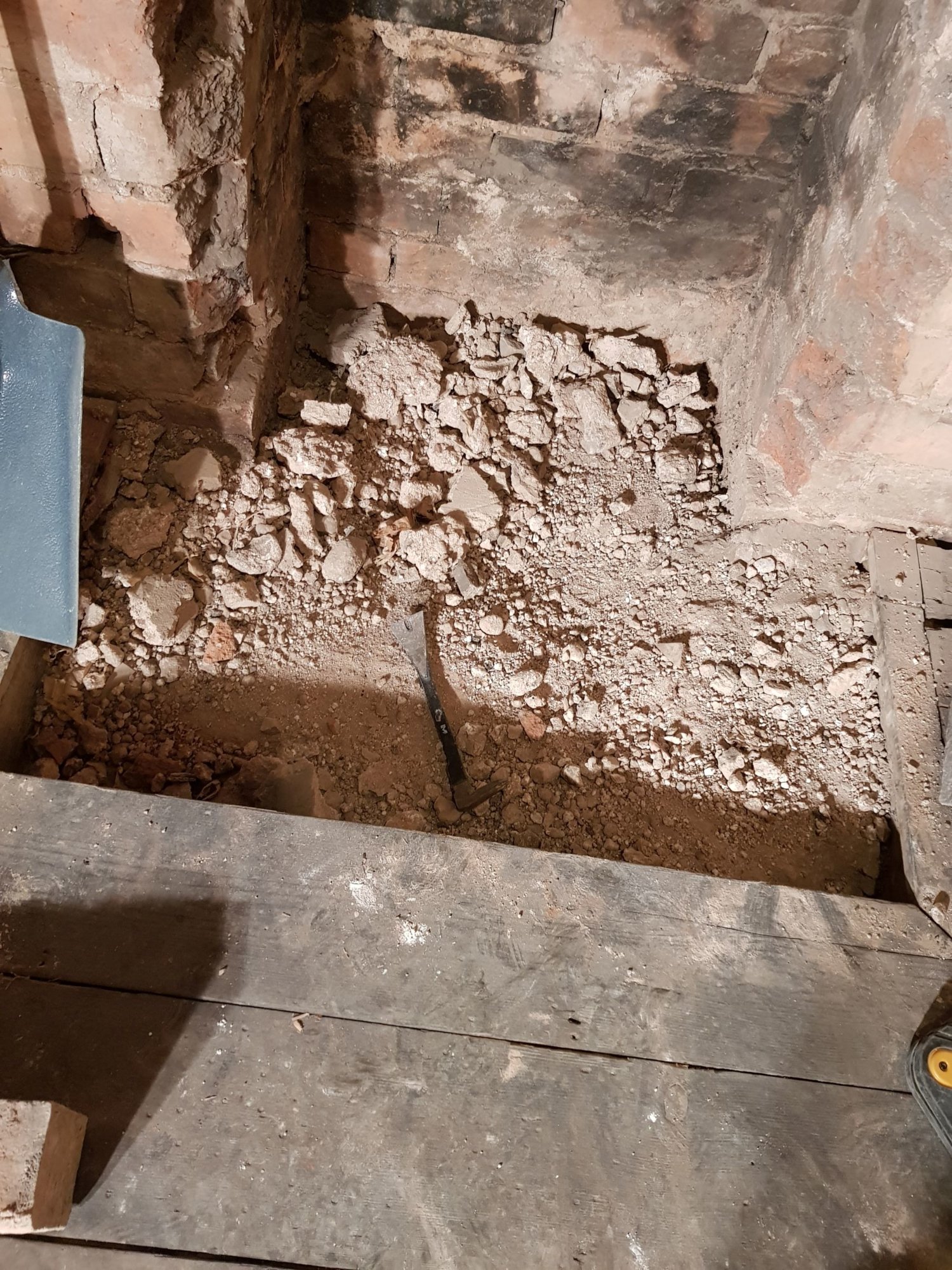

Thanks for the response, managed to get the picture working now as well. Cleared the slab and some of the rubble away but it looks to be framed in on three sides so can't really see a way I can sister the joists without cutting the frame away also?

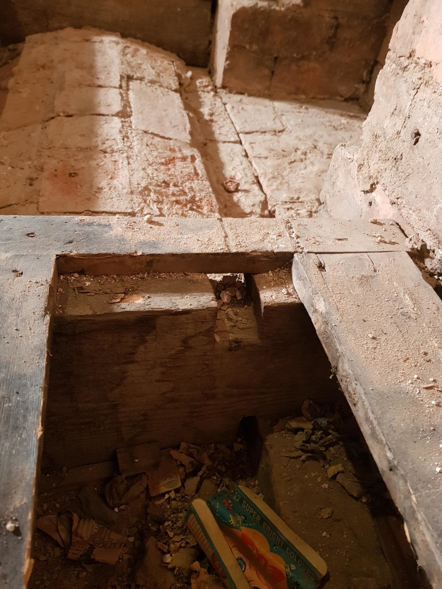

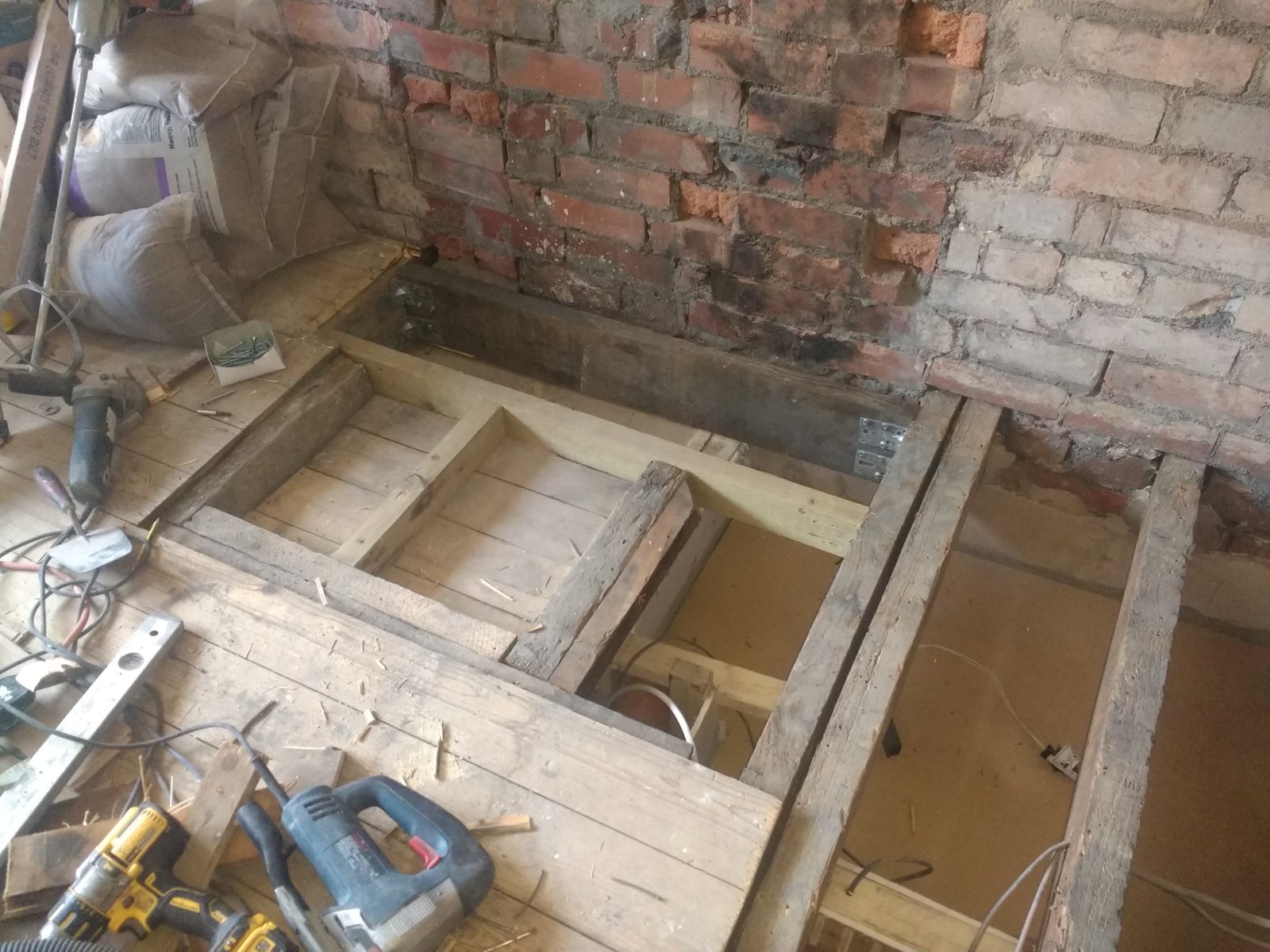

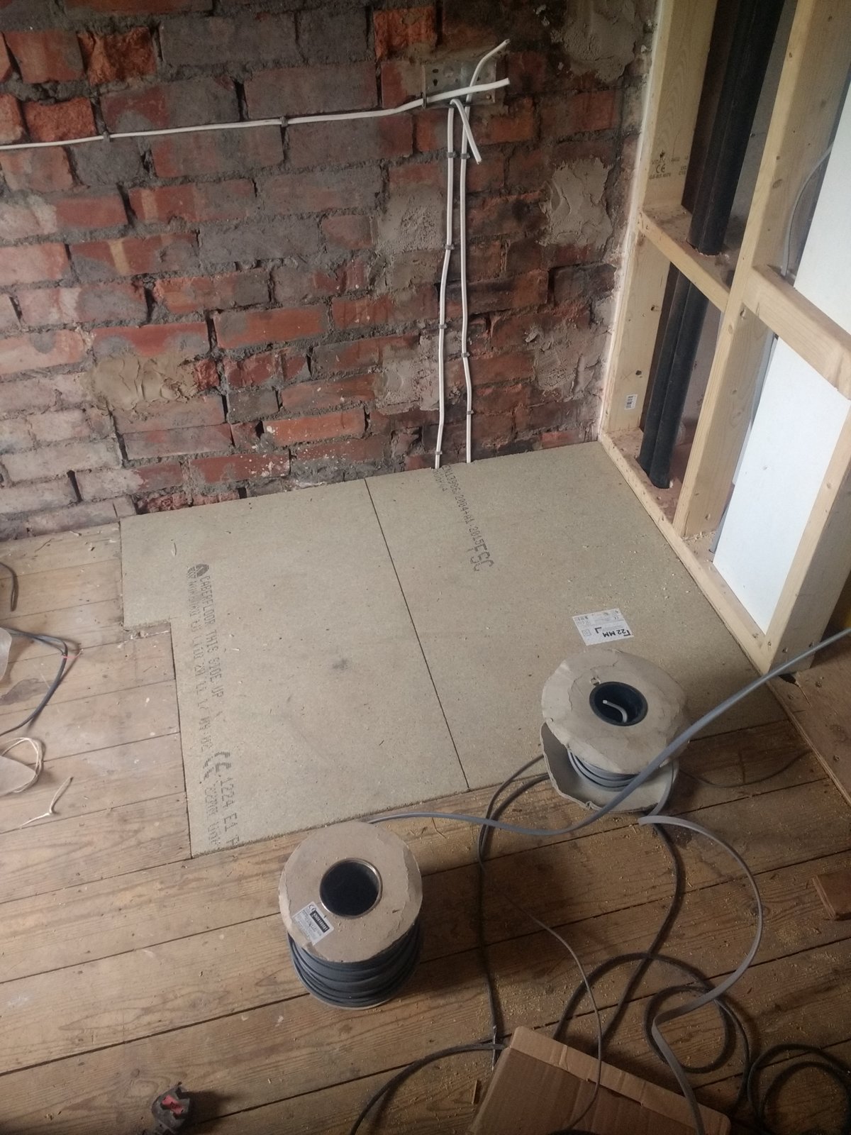

Here's mine done recently:
Before:
And after:
I took the breast out as well so a bit more making good needed. The bit with the sunken floorboards was what my hearth concrete was on. It's nothing structural - just building up to the right level to put new flooring on:

Agree with Cdbe.
I had the same in my house. I saw the pile of rubble as being a cheap thermal and fire proof material that the original builder installed 20yrs ago. In answer to your question, in my case this two builder buckets of rubble was siting directly ontop of the ceiling below. Its weight presumably okay for the ceiling that it was sitting directly on top of, as any extra load was then taken by the hearth stone onto the adjacent joists. So I would not recommend standing directly on the rubble or capping it with concrete and then standing on that as you may end up going through ceiling.
I removed as much of the rubble as I could, and put in Joists to bridge any gaps, and put new floorboards across the hole (in my case reclaimed boards to get correct (old) thickness, or use new floor boards or sheet with thin bits of wood on joists to bring up height).

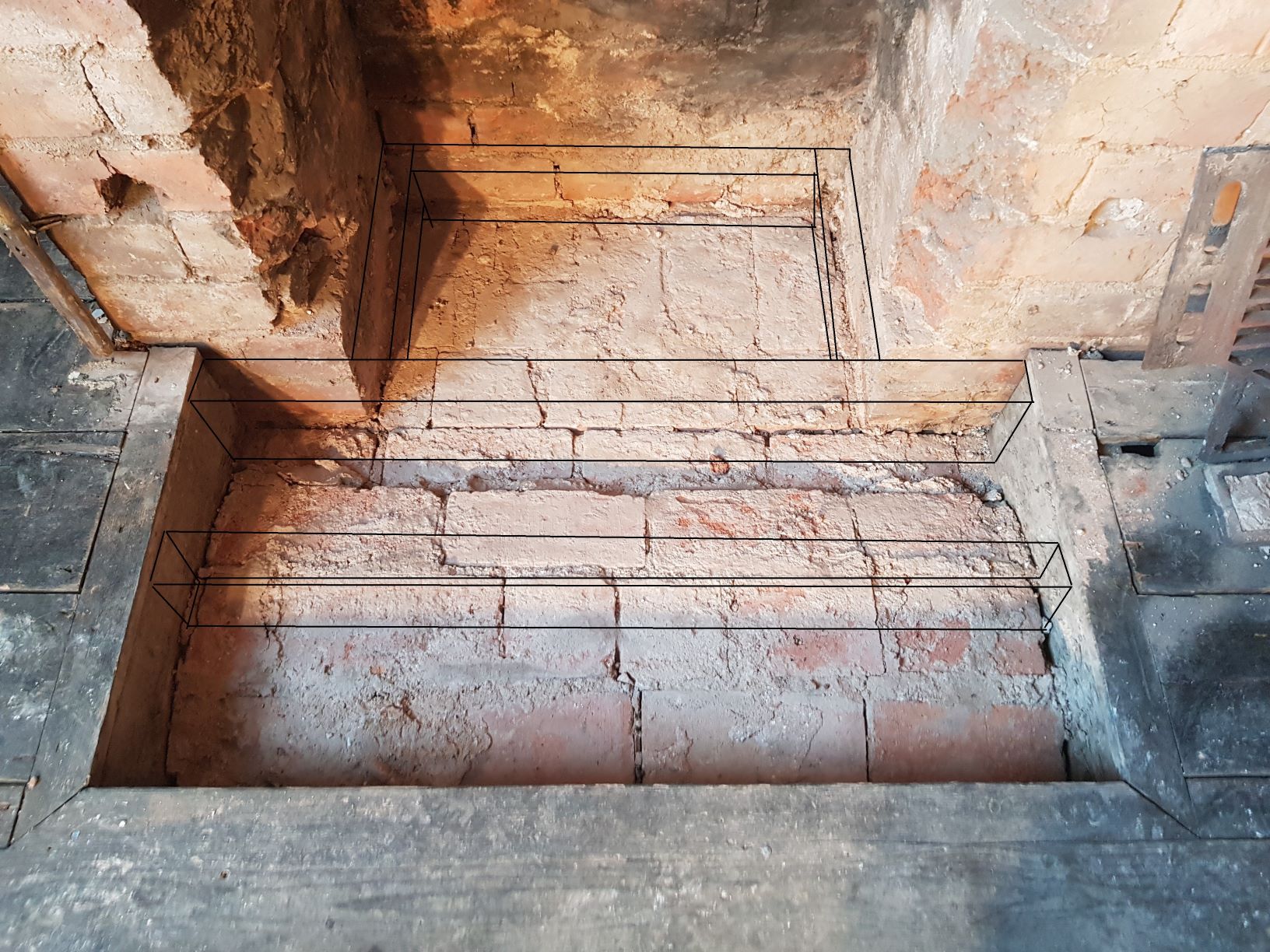

So bit of an update, carried on clearing the loose rubble that was under the slab, now down to a brick layer, with an interesting brick arch built which presumably goes some way to explain how the weight was being supported.
So question is now> a) carrying on going, dig/smash out the brick that's there, or b) Get some wood made up and put across across (as per my dodgy paint pic), remove the mitred edging and then just board over the top?

Civhback,
Looks very good and tidy.
Your option B) looks good option.
Also rather than having joists from left to right, you could put two joists from front to back.
But when I did it I was wanting to make sure that there was nothing on the ceiling below, so that if I ever took ceiling down (or it fell down), or the joists I put in flexed I would not also get a pile of bricks in lounge below.
For me the front section of bricks was simply on top of my ceiling, there was no other load bearing at all underneath. And the back part was solid and loaded onto chimney below - so I did not touch that.
So as I wanted full thickness (or is that depth) size joists, and did not want joists to sit on bricks or ceiling below at all, I removed (from your front section) everything down to expose the ceiling . Then put in the front two joists a little bit above the ceiling below. At the back section I actually put a layer of concrete as I knew that the chimney was other side of bricks and wanted to make sure it was sealed and no smoke could get in to room above.
So I guess it comes down to what is downstairs. If the Chimney protrudes out downstairs to take in that front area, leave and do as you suggest. But if the front brick as sitting on ceiling, I would remove the front bricks and put in bigger joists. I would not touch bricks at the back as you may enter the chimney itself.

the joists on either side of your hearth are supported by what?
they both seem to end by buttin up to the brickwoek?
remove all the bricks an the ceilin should be revealed..
wheres this arch you mention?
i previous mentioned be careful an now you want to smash out the hearth bricks?
i also mentioned no double joistin needed - none at all.

Thanks, thinks that's pretty spot on to what I've got and I'll be looking to do the same, remove the front bricks and then just put frame support and flooring ontop.
New picture shows the bricks as being part of the chimney breast downstairs, and then just a gently arch extending out - just seems to be rough cemented in place/on top of the front of the breast. (Bottom right of new picture is line of chimney breast).
Sorry didn't explain my post properly! just the front section that extends out the front of the fireplace I intend to remove rather than the existing chimney!, existing joists are supported by chimney breast from downstairs, no double joisting - just framework to support new floor board.
