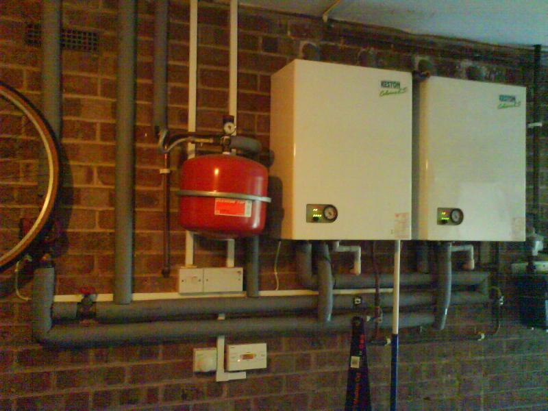

We live in a large 1930s chalet bungalow and our gas consumption is equivalent to 50,000 kWh/annum (was 63,000 before double glazing). When we moved in 7 years ago, we had the heating upgraded and that included two Keston Celcius 25 boilers (25kW condensing system boilers).
Each of the boilers has its own circulating pump but the installers put these on a short circuit "to ensure adequate flow through the boilers" and fitted a third circulating pump to the cylinder and radiators. I have the hall radiator and one radiator in the lounge controlled by the room thermostat (valves always fully open) and TRVs on all the other radiators. I have a Flowmaster Titan 300 litre unvented hot water cylinder.
I have recently read that condensing boilers are more efficient if the mean temperature is kept to a minimum. My concern is that the current arrangement will have high (non-condensing) inlet temperatures.
With the three circulating pumps, I'm wondering how far I can safely close the gate valve on the short circuit?

That should be an automatic bypass valve. (see the boiler instructions, which I believe will specify one, even if the Building Regs didn't) YOu'd just set the pressure for sufficient flow through the boiler(s)
I hope there's non return valves in there somewhere, otherwise when one boiler's off...

Condensing boilers are more efficient when they are condensing. To do this the return (inlet) temperature has to be below 55C. The system, however has to be designed for this temperature as the output of the radiators will be affected.
My concern is that the current arrangement will have high (non-condensing) inlet temperatures. With the three circulating pumps, I'm wondering how far I can safely close the gate valve on the short circuit?
The temperature differential is determined by the pump speed (high speed = small differential and vice versa). According to the Installation Manual: "The optimum pump speed is also detected and automatically selected by the boiler".
I would leave the gate valve alone for the moment.

If we assuming that your chalet bungalow is a two storey detached house, 10m x 12m, with cavity wall insulation, DG plastic windows and minimal loft insulation, the heat loss, using the calculator I pointed you to, is only 22kW!
Did you employ Drivel/Water Systems?
It's a primary/secondary circulation system; leave the valve alone.
ISTR that Keston do some publications on linking their boilers, have a look at those to see if it explains it. I haven't studied this and do not claim that I have understood how it is meant to work. From the comments above, it looks like the system could operate adequately with one boiler.
The recirculated water (if the primary flow is greater than the secondary) will heat the return and reduce the boilers' efficiency.
That is what I was worried about.

Not having been in paid employment for over 2 years, I'm not in a position to splash the cash right now. Up until recently we had a reasonable maintenance contract with the installers, so the unreliability was more of an inconvenience rather than a cost. I think a single system boiler (30-40 kW) with weather compensation is the way to go. I may have to wait a little while for another breakdown to justify it.
Looks more like a simple Lead/Lag set-up to me. What ever it is, it's over-kill.
