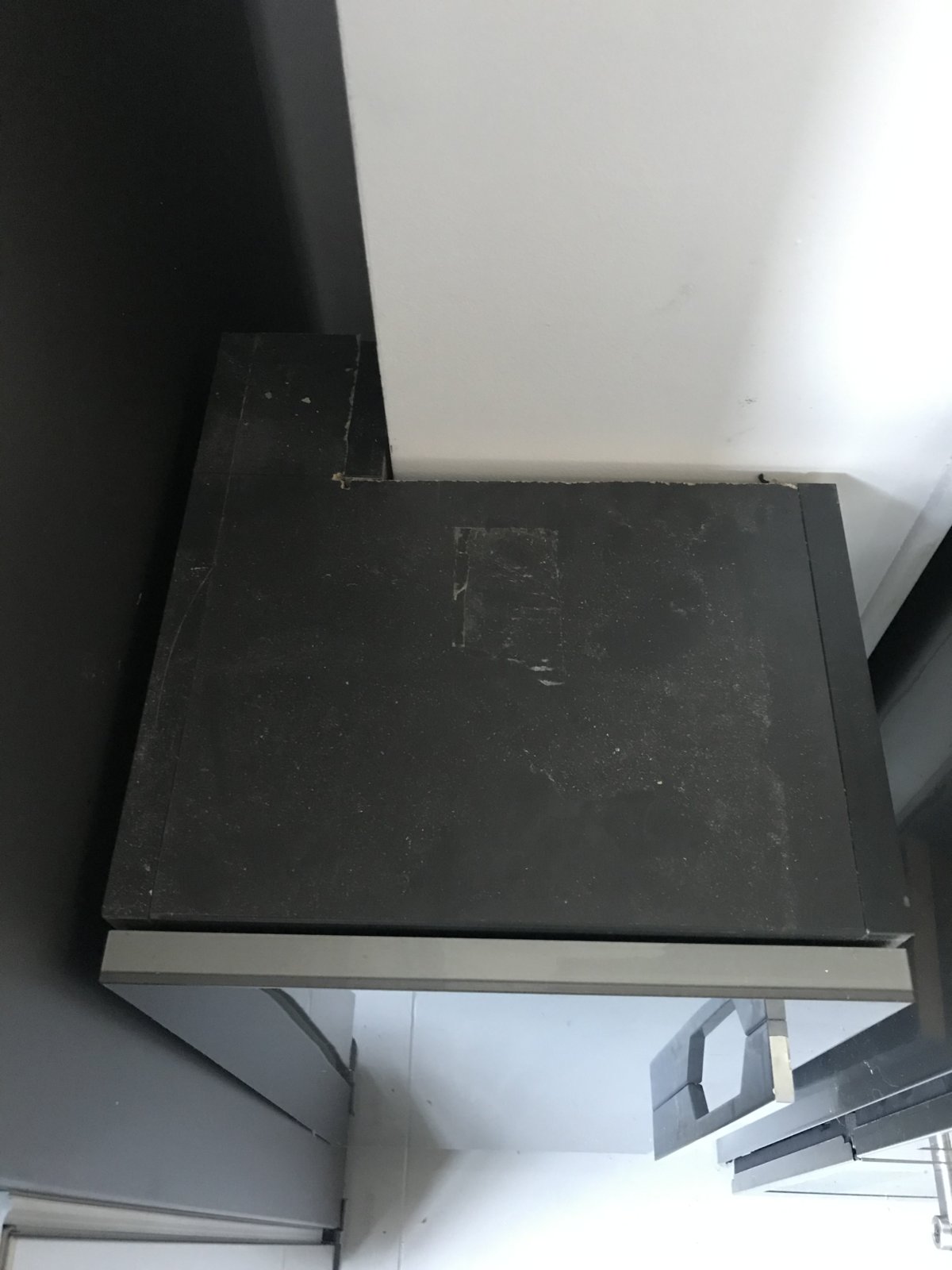

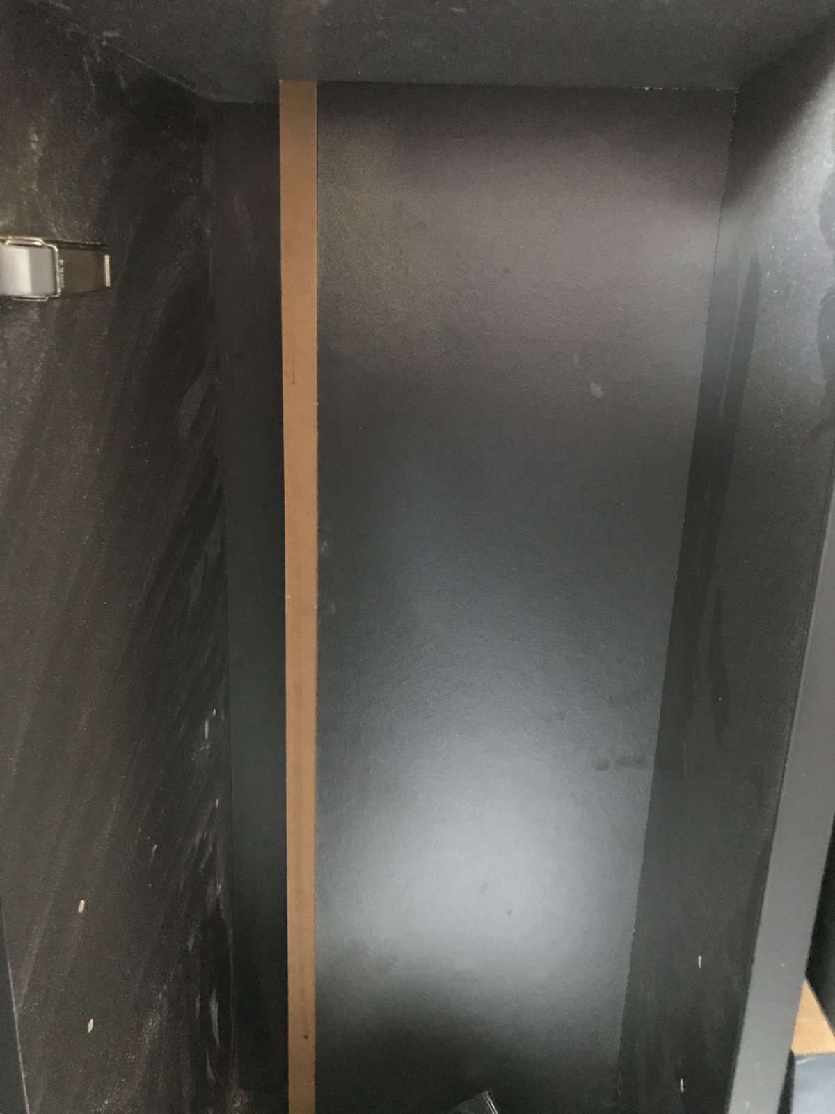

If the wardrobe sticks out further than the chimney breast you could cut a square out of it, turn the off cut round, fix it back to the wardrbe and it would fit.
I did it to a kitchen unit that overlapped a chimney breast.
