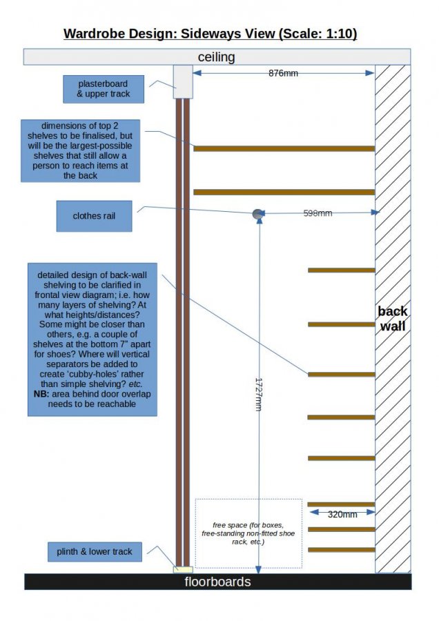

Hello, I am stuck on how to go about a project so thought I would see if I could get some ideas here.
The master bedroom in my house includes an alcove with dimensions:
  • Width: 1570 mm (i.e. requires 2 sliding doors to cover)
  • Height: 2430 mm (i.e. the height of the bedroom)
  • Depth: 874 mm
The intention is to fill that alcove with a bespoke sliding door wardrobe, such that the sliding doors are flush with the main wall (i.e.: ~874mm from the very back of the alcove.
I get help with DIY projects from a family member who has vastly more DIY experience than me, and thus he leads the work, with me helping with the labour etc. So: as the first step, we have successfully installed the two mirrored sliding doors on their tracks. These are easy to take down, which we've done to focus on the next step: fitting the interior.
This is where we have come unstuck on a very fundamental question: what will the design of the interior be?! i.e. how many clothes rails, hung where? How many shelves, of what size, placed where?
My wife and I do currently struggle with inadequate storage in the house and so a key goal of this project is to maximise the amount of storage within that alcove, whilst making it still possible to reach the items; whether this is by a person being able to step inside at one side of the wardrobe (but this would reduce the amount of storage space?), or alternatively open doors and reach inside.
I've found it hard to get my head around this. I think that there could be many different ways to do a design, and I don't want to end up with a 'bad design' that doesn't store a lot of stuff and/or makes it hard to get at items.

I'd be temped to put shelves or even drawers all up the back wall, and the clothes rail in front. Yeah you'd have to reach through the clothes to get to the shelves (like visiting Narnia), but how often would you be doing that, really?
do not place drawers in the central section without working out the area clear off the door overlap
you can have cubby holes full height at the back about 320mm deep behind the hanging rail

The 2 identical sliding doors are 765mm wide. We built a wood frame off each wall, about 2 inches thick on each wall, as the doors would have been a little small for the opening otherwise.
Good point that anything smack bang behind the door overlap would be hard to reach and therefore likely a waste to build. I will need to open each door and measure/feel for what is 'easily reachable'.
This sounds a likely bet, the key advantage seems to be that it's maximising the storage space. Reaching through clothes won't be too hard as long as the clothes rail isn't so chocka you can't move them along - and if it is, just fold some of the clothes and put them on the shelves/cubby holes at the back.
Rail at front, storage behind it (while watching for overlap area between the doors) seems the way to go. I'll try to knock myself a diagram up shortly...

in the area off the door centers you could have side on storage with a blank wall one side and cubby holes or shelves or even use this area for swapping /storing winter/summer clothes as its only around 6 inches it wont be too bad
The attached sketch illustrates the concept of this design. I'll need to work out just how big the 2 shelves above the clothes rail can manage to be; and the detail of what the back shelving will look like - i.e. how many layers, what heights they are at, and whereabouts vertical separators should go.
At that point I'll have what design I would ideally like; it may then get tweaked once I start to look at what materials might most economically give something 'close enough' to it.

remember you will need 1or 2 intermediate vertical supports for the shelve if its supporting the hanging rail
if you had 3 doors you would have 2 vertical sections at 1/3 and 2/3ds about 525mm apart
but with only 2 doors it can get a bit crowded as 1 intermediate will struggle to hold the weight off 780mm off rail without a middle support and an intermediate partition each half would be very intrusive and undesireable
certainly dont rely on 15mm melimane or similar to support any load underneath on a 780mm unsupported run
Frame should sit just in front of doors to maximise the door travel, avoiding dead spot at the overlap.
