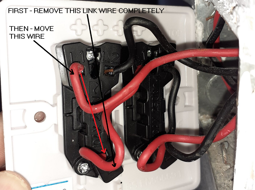

2 Gang 2 way switch
Then, tell us what happens.
Hi mate,
The switch on the right side above switches on and off the light which should only be controlled by this switch.
Nothing happens with the left switch for the 2 way. This light doesn't come on with its other switch at the end of the kitchen either.
Ok.
Put the red wire you moved back where it was, and then
connect the link wire between the two bottom terminals of each switch, one end in with the other red that is already there.
