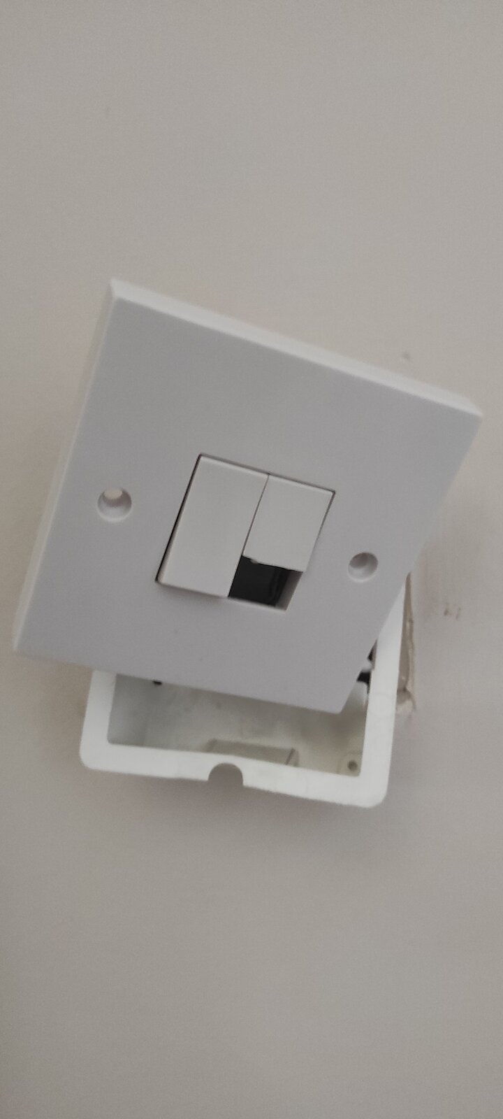

I'm replacing a 1st floor 2 gang switch as one of the physical switches has snapped.
The left hand switch controls the landing lights on floor 2.
The right hand switch controls the landing lights on floor 1 (same floor as the switch).
The landing lights on floor 1 can also be controlled by a switch in the entrance hall on the ground floor.
All works perfectly but just this 1st floor switch needs replacing due to being snapped as mentioned above.

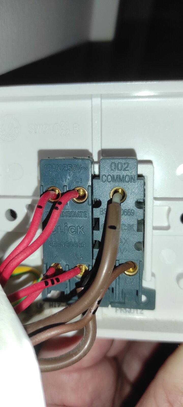

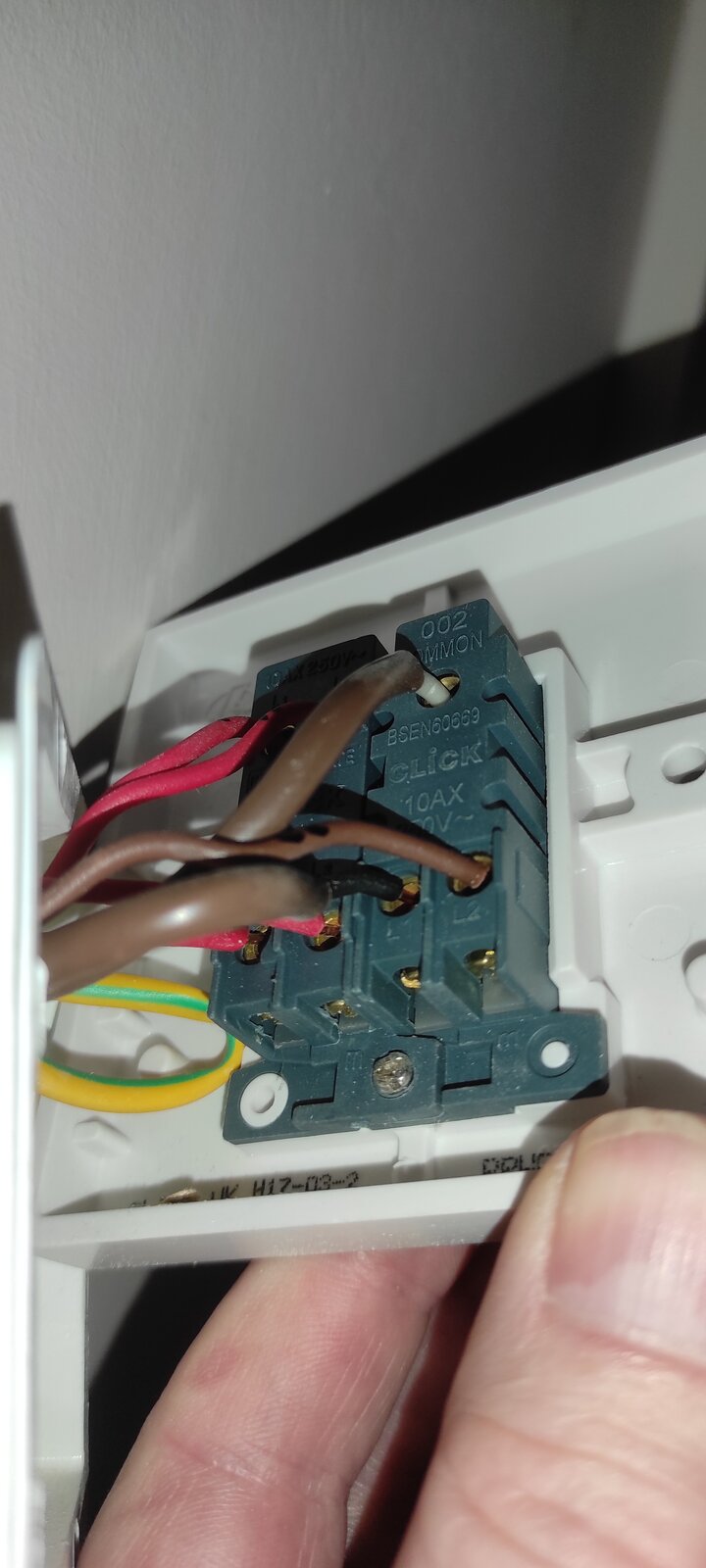

I'm guessing the labelled wires on the photo of the original switch should go to the following holes on the new switch (photos below).
But there is 1 less hole in the new switch so (according to my guess below, wire 3 has no new home :(.
Is below correct please and if so - where should wire 3 go on the new switch?
Many thanks for your help.
Wire number Correct hole in new switch
1 L11
2 L12
3 ?
4 L21
5 L22
6 COM1
7 COM2

The left hand switch is an "intermediate" switch.
You will need to buy another switch with an intermediate switch and a two-way switch, or
one with two intermediate switches which you would be able to use.
Thanks for the reply. Oh no - so I've bought the wrong replacement switch!
If anyone has time post a link to the correct replacement switch (hopefully with exactly the same connections as the old broken switch so I can just reconnect like to like) that would be much appreciated.
Thankyou.
but in reality all you need is a replacement intermediate switch toolstation code 83157 that is unless you want to replace the whole asembly with nice shiny new switches and face plate
Awesome - thankyou very much - I didn't even realise the individual switches were modular.
I've ordered just the intermediate module as everything else is OK, arriving tomorrow.
Thanks again.
