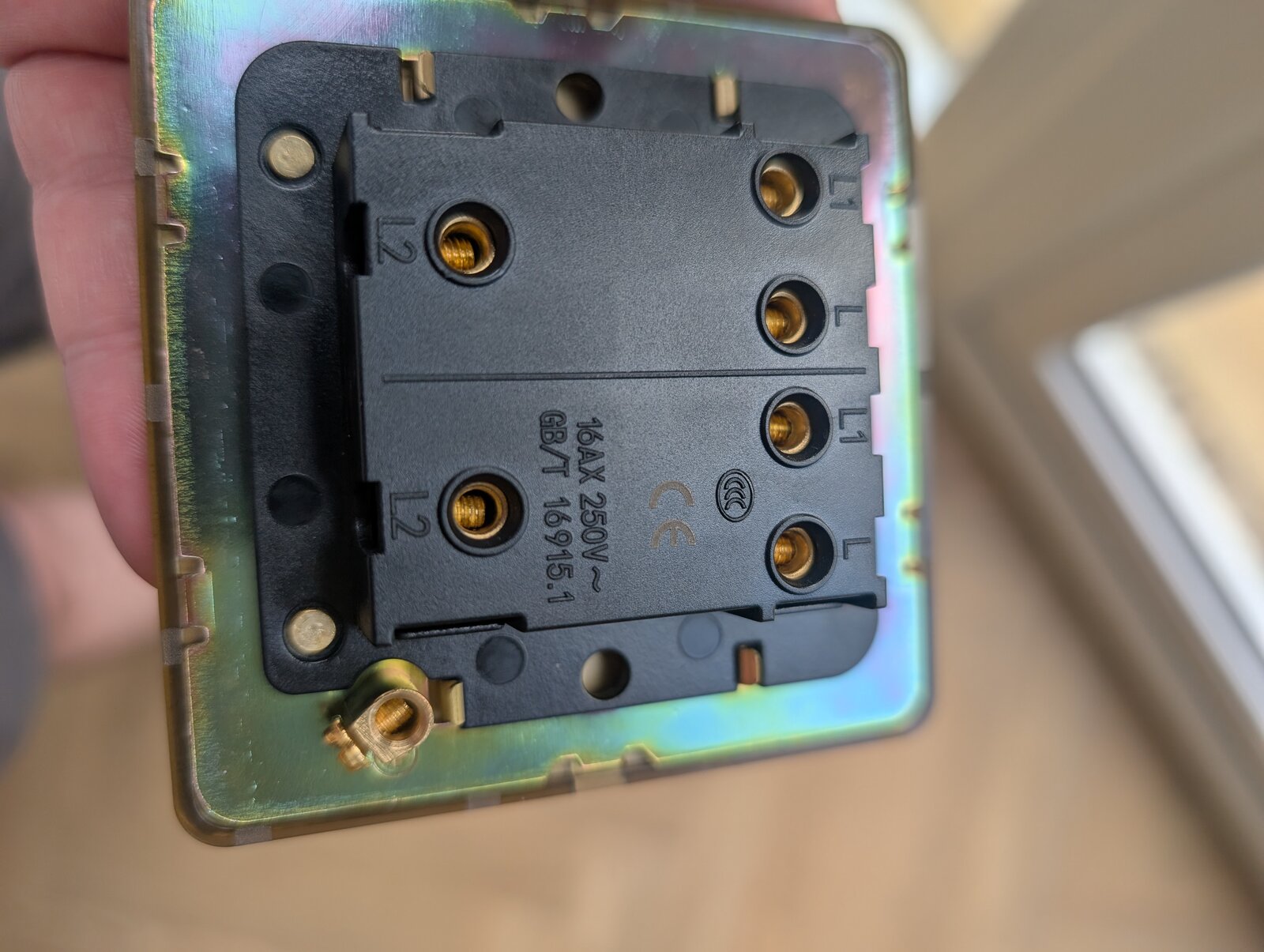

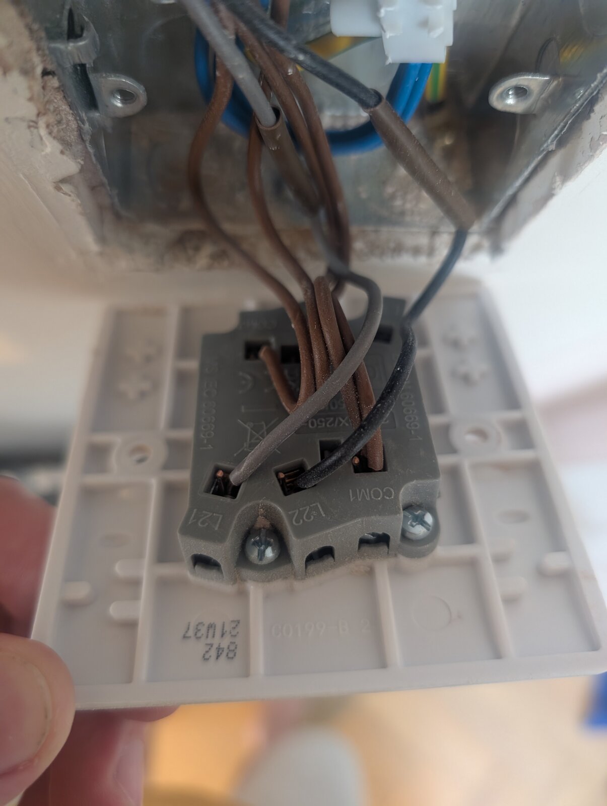

I'm looking to replace a new build 2 way switch in my kitchen and I want to confirm my logic.
I will need to take the current earths to the metal back box and then to the new metal switch. ( I know the screws should do that but I guess it's an extra layer of safety.
Then to replace my current plastic switch which. Currently uses l11,l12 ECT
Gang 1:
L Connect wire that was on COM1
L1 Connect wire that was on L11
L2 Connect wire that was on L12
Gang 2:
L Connect wire that was on COM2
L1 Connect wire that was on L21
L2 Connect wire that was on L22
