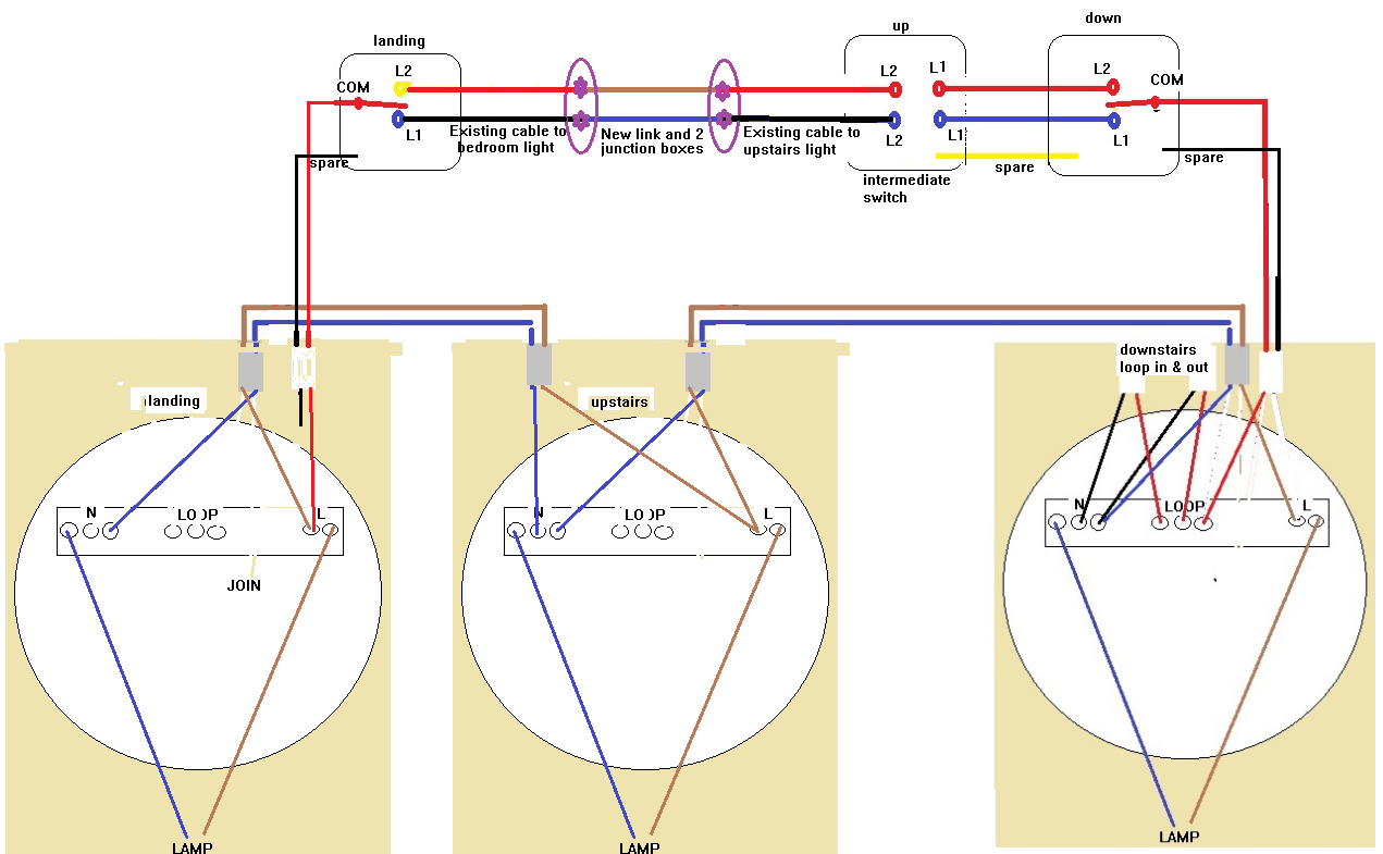

I can't help thinking this is putting it back the way it was before we started. One of the switches I'm using is an intermediate so I have everything I need.
The cable from the landing switch to the bedroom light is long enough th reach to the upstairs light
All done. The cable from bedroom light was even long enough to to reach the junction box by upstairs light and to do the new part to the landing light.
I just need a few cable clips now but they can waight.
I'll get my son to take some pictures for you when he can come in again.
