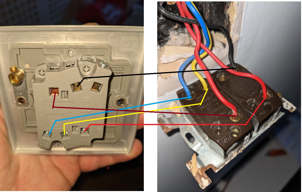

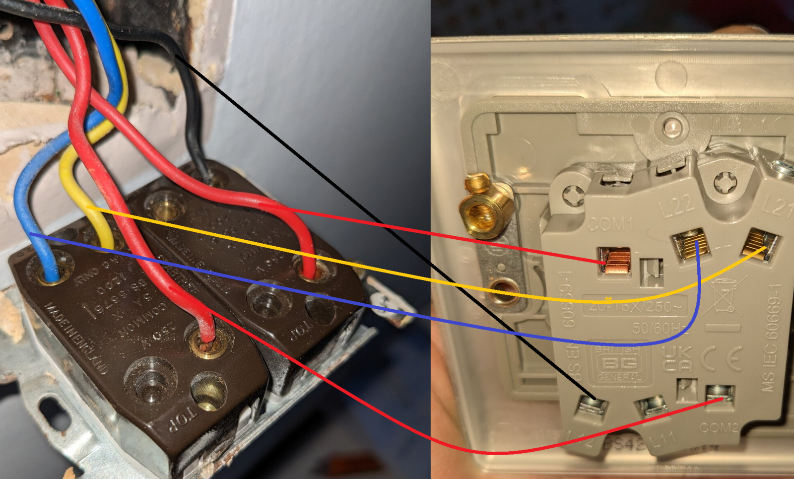

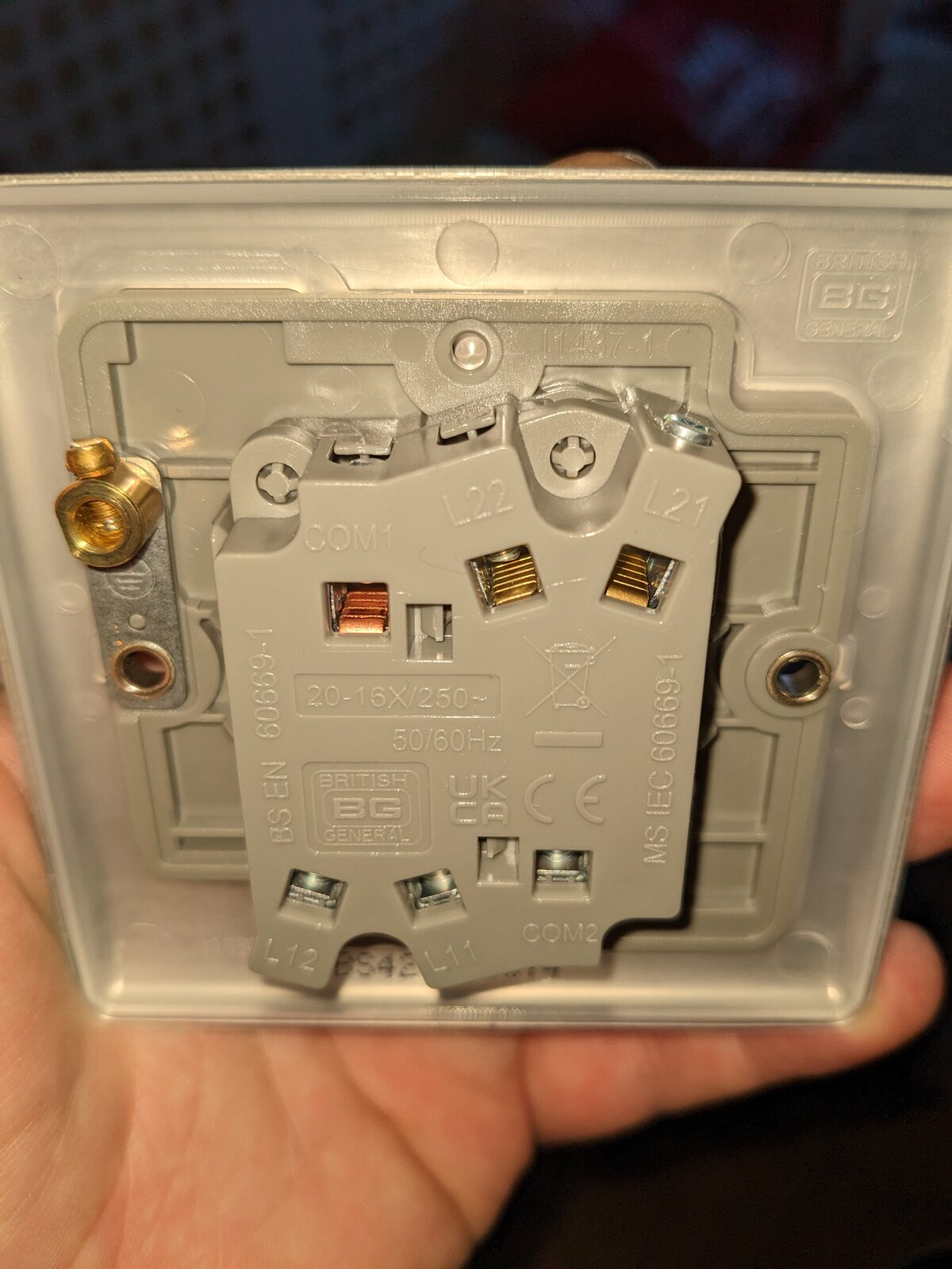

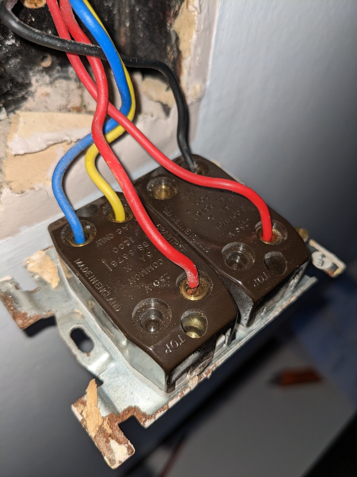

Hi All,
I'm trying to replace a light switch on the stairs. 1 switch does downstairs, the other upstairs. I'm confused by the labelling on the new BG switch (L22, L21, L12, L11), and the enclosed slip doesn't even mention them specifically (just L1, L2).
How would I match the existing labels to the new switch?
Appreciate the help,
Pete

And ensure there is an effective Earth connected to the earthing connector on the new switch, This connection is a safety requirement to prevent the risk of electric shock from the metal switch.
Do not mix up the two reds,
EDIT: the black may need to be in L11 to get 'down on'
And yes agree it requires an earth link if it's a metal front plate

Apologies if our conflicting advice has confused you.
However we have both offered the same advice and both will work except Bernards will transpose the position of the switches.
IE the upstairs light switch is currently on the left and the way he has drawn the wiring it will be on the right.
My first attempt at drawing it I did the same thing due to the way the photos show the switches IE the existing switch appears upside down.

Sunray, I'll admit it did initially confuse me, but even after the edits (thank you), the limit for me comes from not understanding the labeling on the new switch.

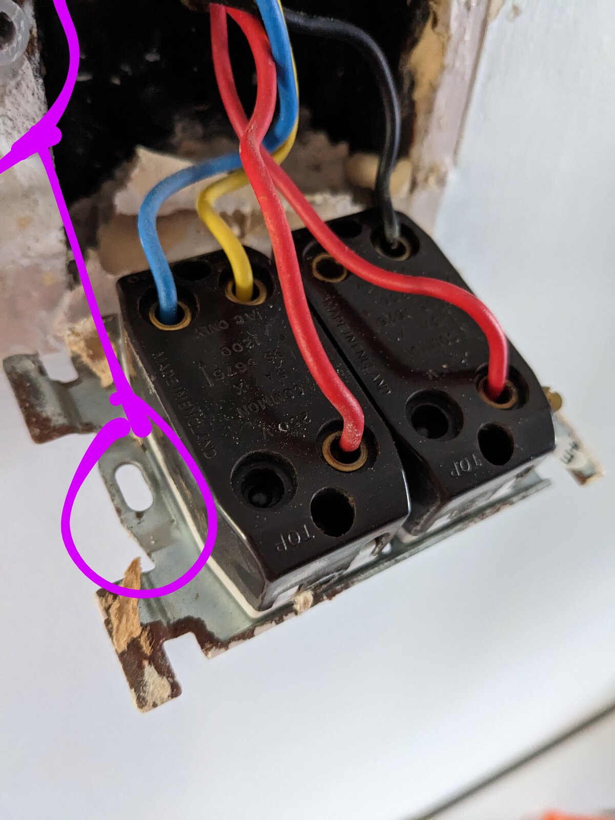

For the back box, this house is 1930s and it looks like the previous owner had already upgraded the switch but the screws nowhere near align and they'd bodged it to hold together. It's about 10mm width and height too small from current backbox size.
Have you got a picture? That sounds unusual, though I do note that the existing switch is a grid arrangement, you are not looking at the centres of the fixings for the cover plate into the yoke are you? because all that will be removed when you fit the new plate switch

Do you now understand the labelling ,and what connects where ? It's pretty simple. With the aid of the helpful diagrams provided by Sunray and Bernard you shouldnt have any difficulty . If you need further clarification ,just ask.
Yep, I'm 100% confident I get it (now)... Now I've packed everything away and looked at it over a cup of tea. Typical.

The 2 sets of markings are essentially the same, the only difference being the old consists of 2 completely independant units labled as COM , L1, L2.
new has numbered the 2 switches by adding a number 1 or 2 in the middle
Just want to thank everyone here for your help earlier in the year. Managed to get around to sorting this now the evenings are a little lighter. Turns out who ever fitted the back box for a single light switch, used a double backbox and mounted it vertically! Had to hammer out the wall and cement fill.
Wiring was spot on, and now have a working light switch again. Thanks again.
