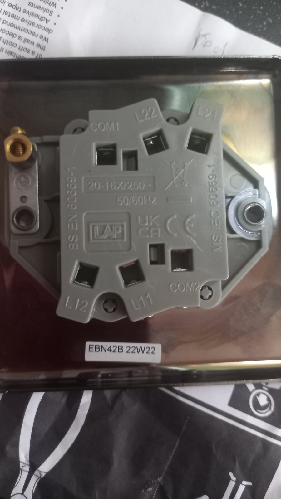

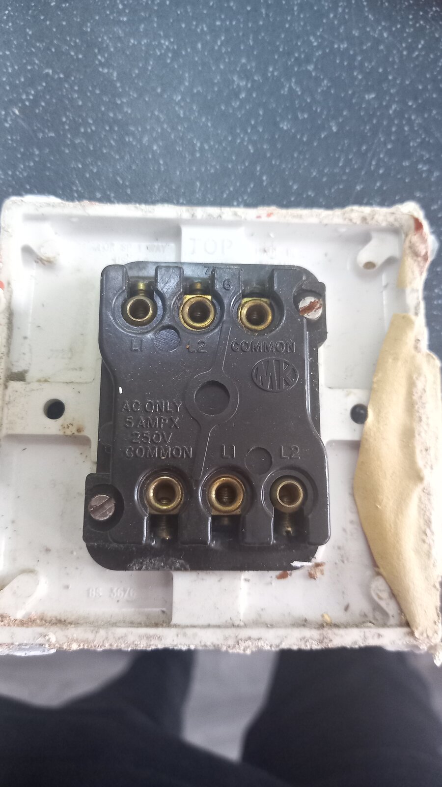

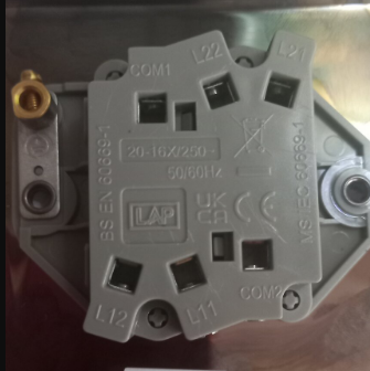

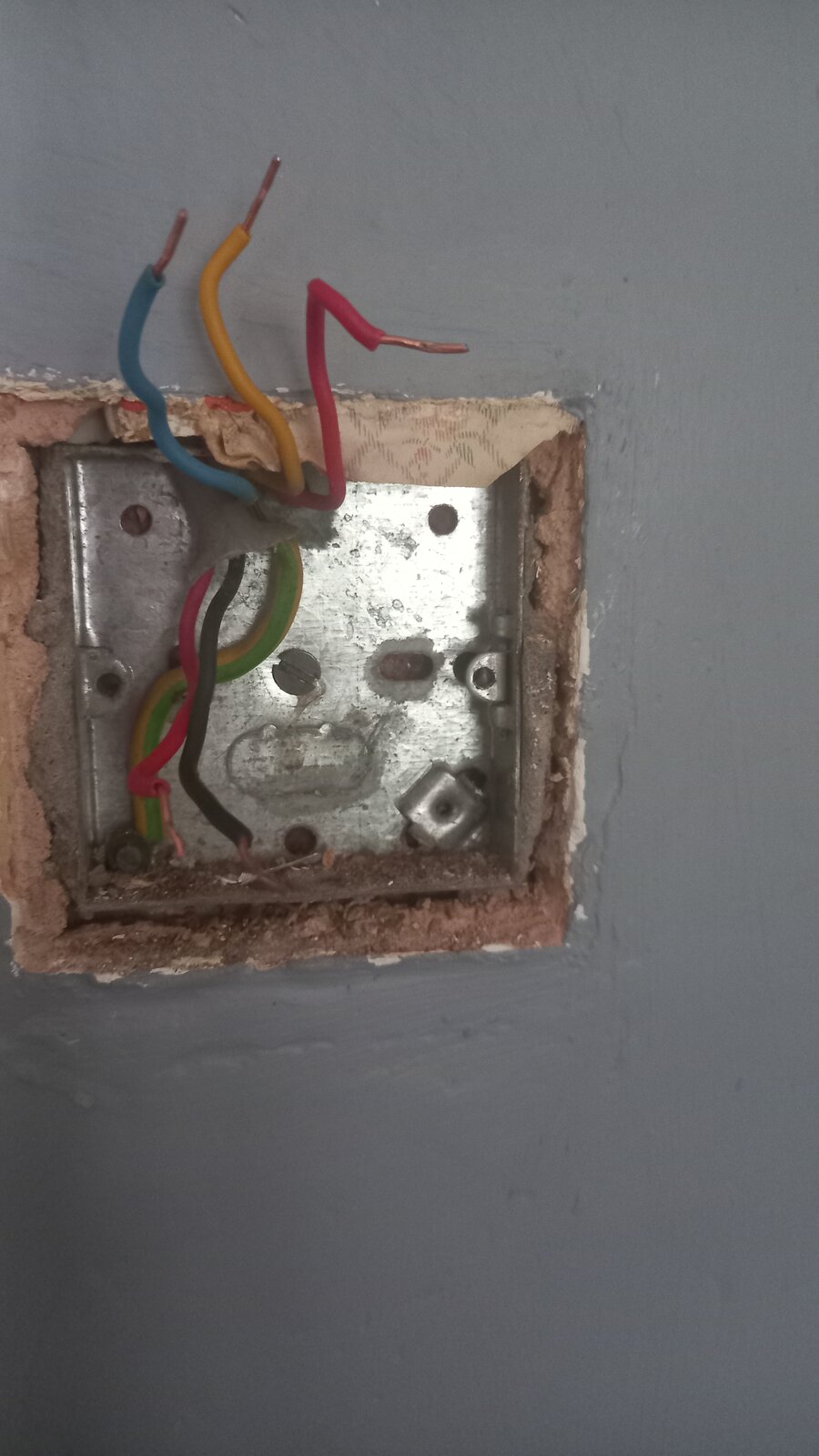

Hello I need some help I took my old light switch off and went to reconnect a new light switch, both are two switches however the old light had on the back just a common L1 and L2. The black/red was in common, blue l2 and red and yellow l1. But with the new switch it has common 1 - l11,l12 and common 2 - L21 and L22 . Can someone advise where to put the wires, I've tried loads now and still not right, thanks!
Do you mean two way, or two gang?
The one you show is a two way, two gang switch and the wires shown seem to be one on/off and one second switch of a two way, or it was the master of a two way system and one gang.
The pair red, black if on off go to Com1 and L11, but if part of a two way system go to L11 and L12 so until it is known what you had, can't really say what goes where.
Likely if a two way switch you will need to inspect the other switch of the pair and copy like for like, most important com is correct, getting L11 and L12 swapped does not matter too much.
Most important to put the green/yellow earth wire in the brass terminal top left.
That's the old light switch

While it is difficult to understand that which you are trying to do, your second picture shows the rear of a Pair of "Single Pole Double Throw" (SPDT) switches.
Each of these two switches can connect a conductor on the common (C) terminal to either the L1 Terminal or the L2 Terminal, depending on how the Switch is positioned.
Because it is almost as cheap to produce SPDT switches as it is to produce SPST (Single Pole Single Throw) switches, in most countries (outside North America) SPDT switches are the "norm" (and L2 may not be used - in many cases which do NOT involve "two-way" switching).
Which of these 2 options are you saying you found when you removed the old switch?

You describe post #1 correctly, the old switch is in post #4
...and that the switches are two triangles; not the top and bottom terminals; which may make the markings used more understandable.
