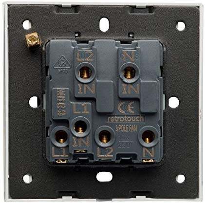

Here are some pictures of the existing switch, the two way one i bought and the intermediate switch. Just to confirm.. if i get this intermediate switch i will then be able to swap over? (still not totally sure which wires would go where). thankyou again.
from top to bottom your pics show:
2way/intermediate
2way 2 gang
3 pole isolator [typical for bathroom fan] which I believe has no relevance to the original post.
To use an intermediate as a 2-way you just wire it the same with the two wires at one end and the one at the other.
It doesn't matter which terminal you leave empty.
Bear in mind a 2-gang intermediate will not be as readily available so you might be better looking on-line first.
Interesting.. the 3rd pic was from an amazon listing (not sure i'm allowed to post the link here???) .. which was described as "Intermediate Light Switch (2 Gang)"
So verrrrrry wrong!
Having looked again,it's even marked as '3 pole fan'.
Ah yes, i didn't see that! Maybe they got the picture wrong on the listing, quite a common thing to happen.. before buying i will contact them to check. thankyou.

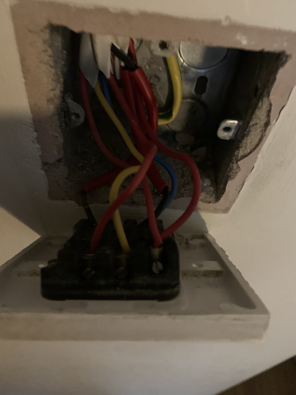

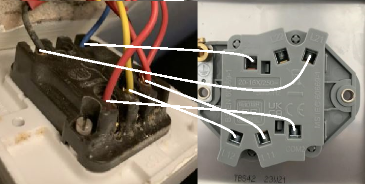

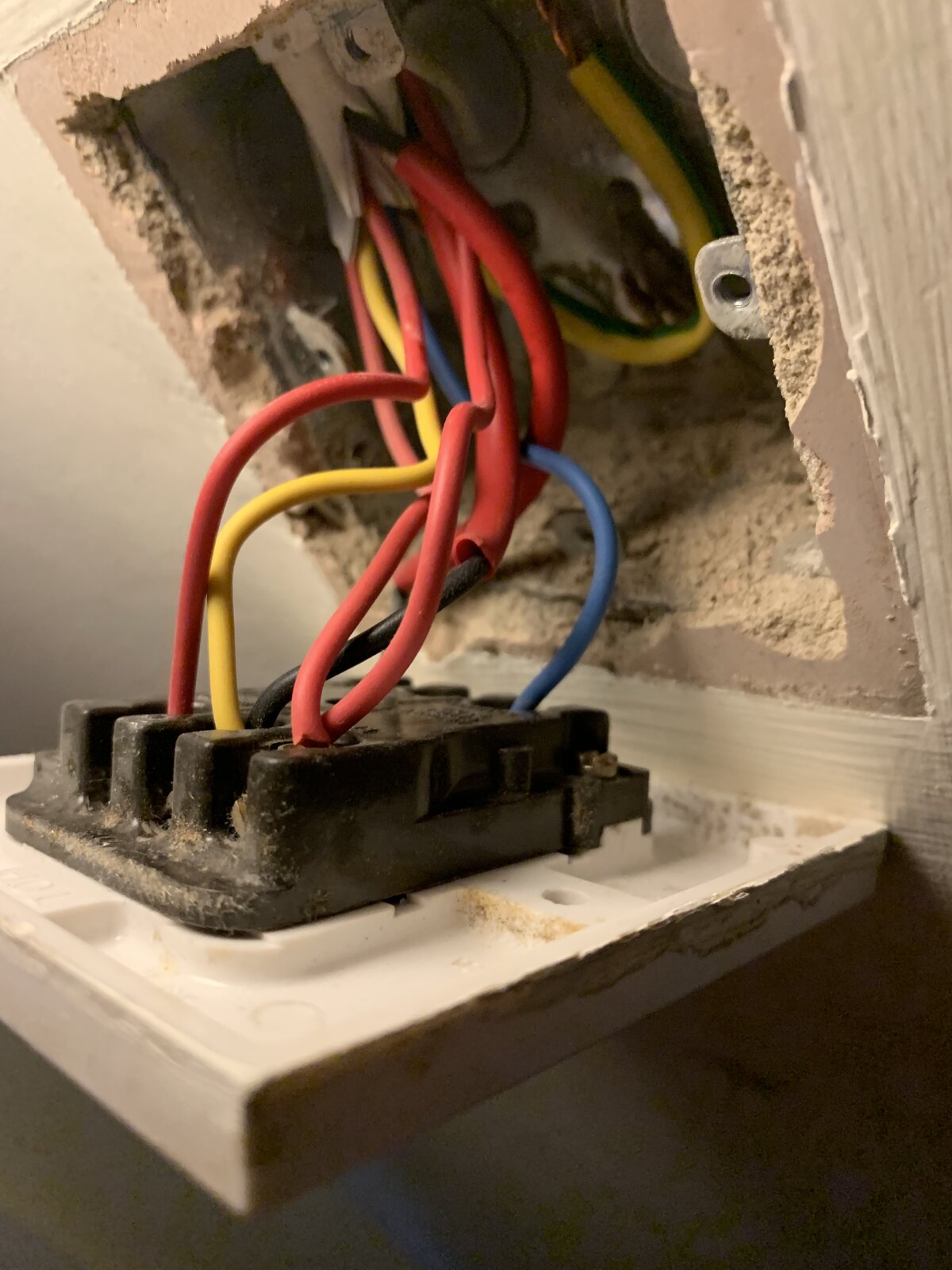

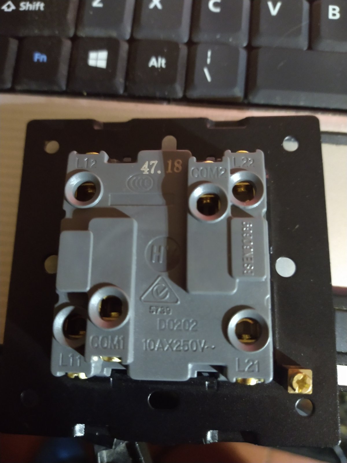

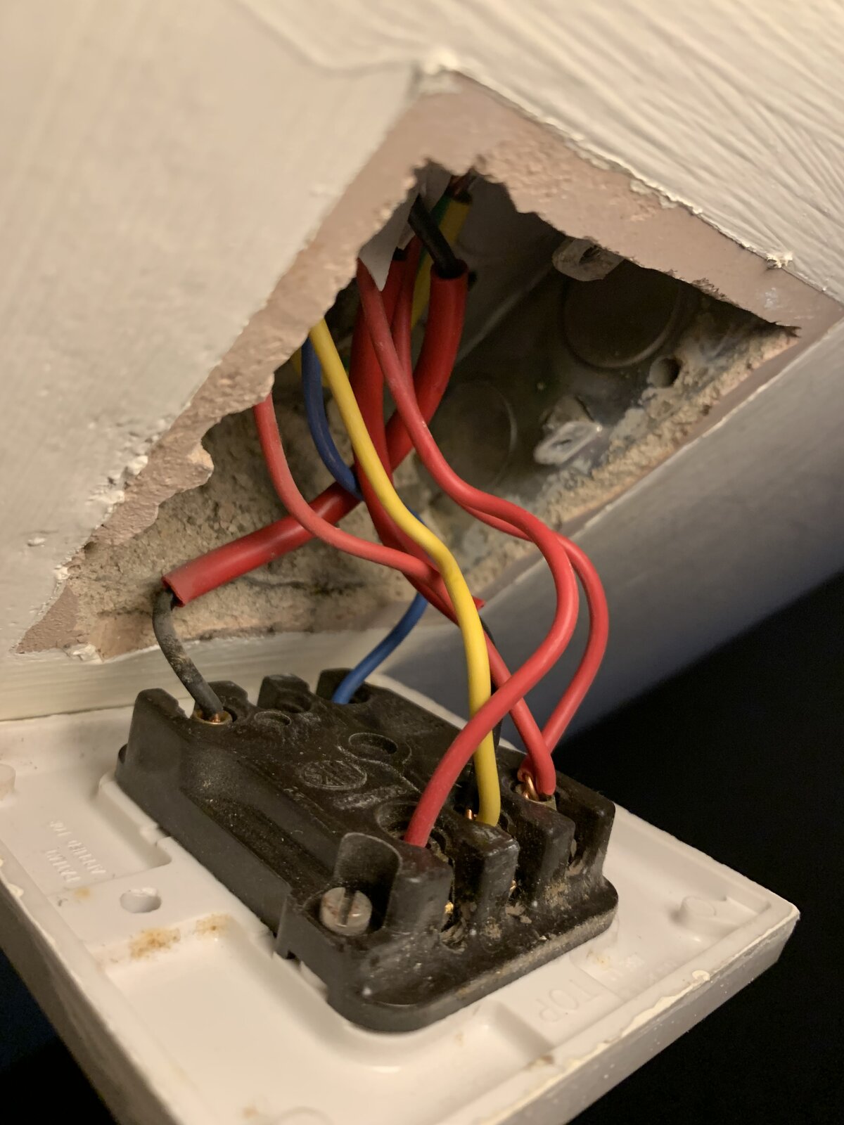

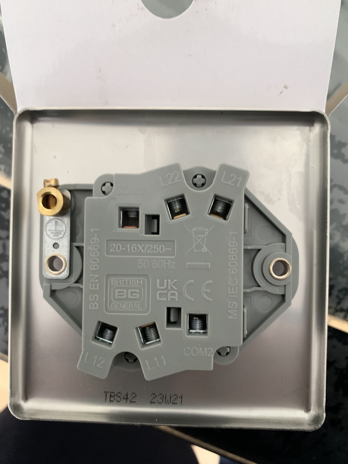

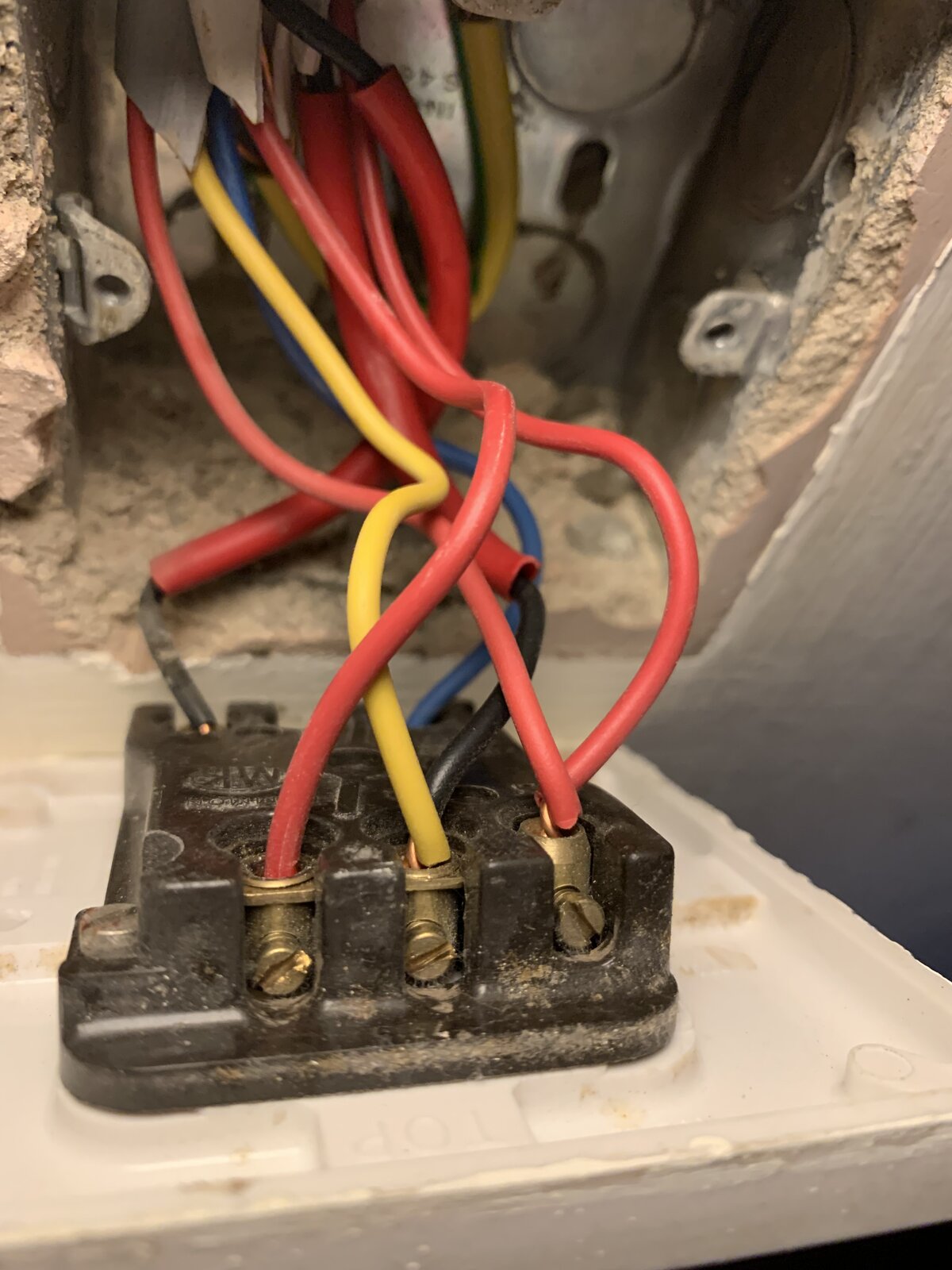

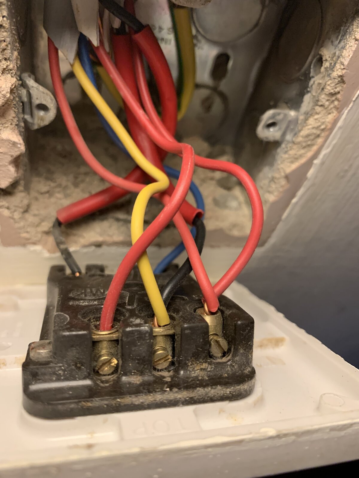

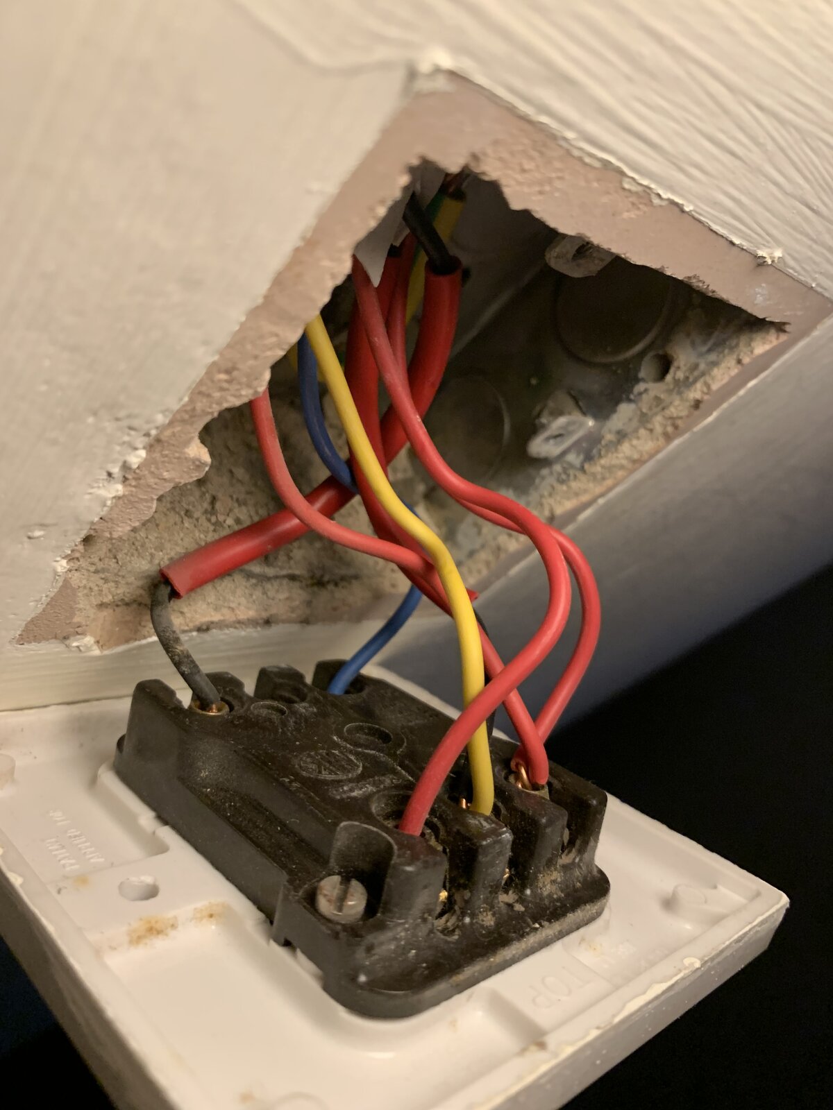

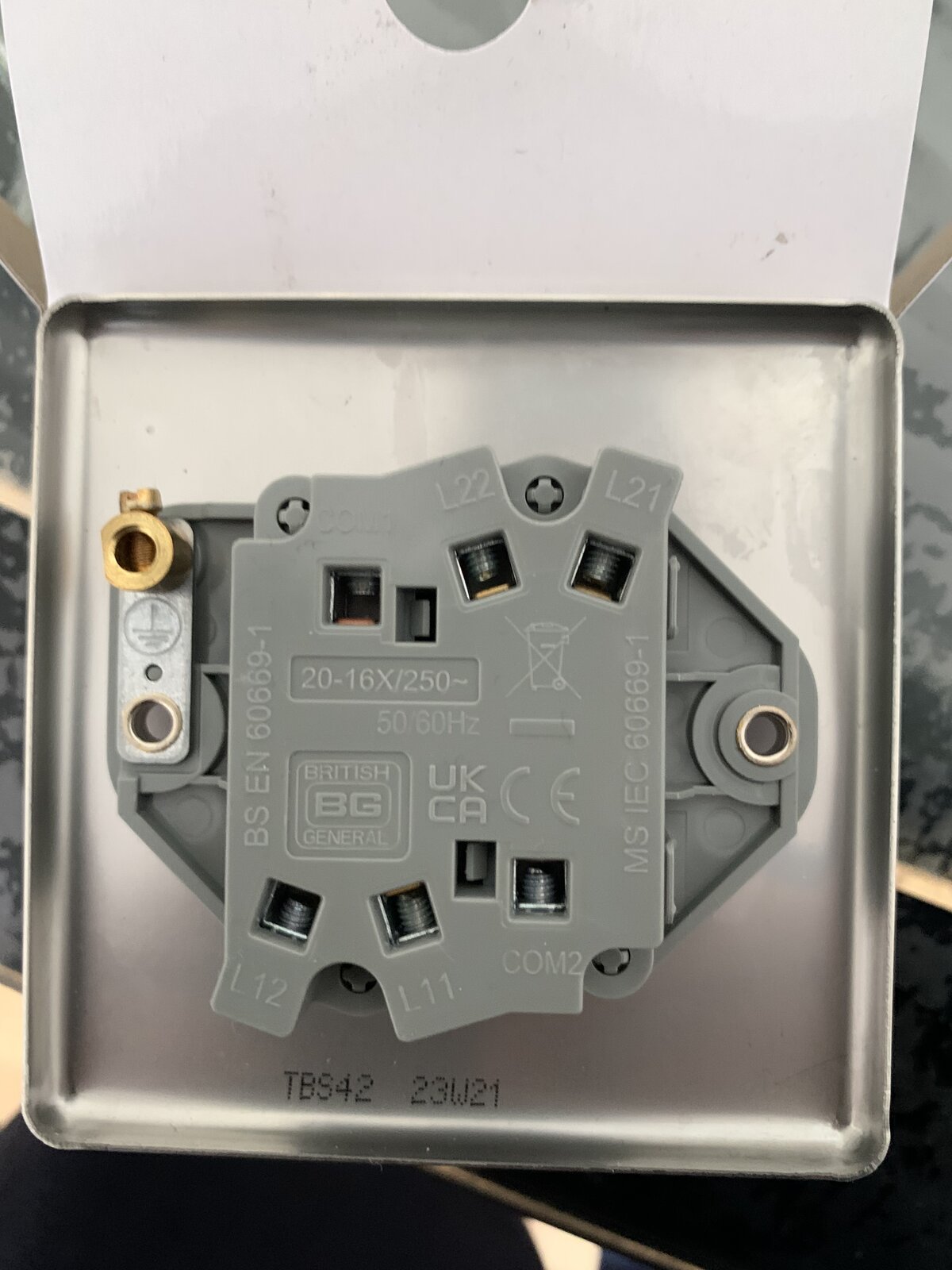

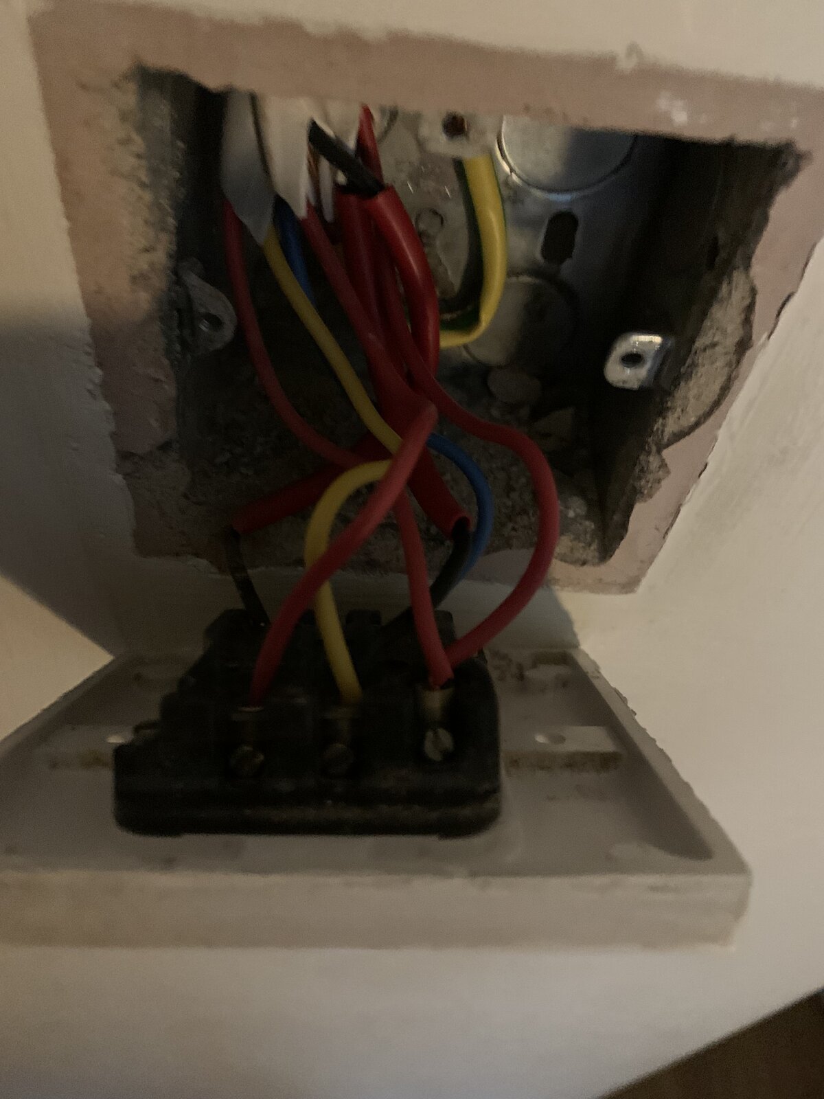

Hi,
I was also looking to replace my 2 way light switch. Can anyone help by looking and pics below of the existing and new light switch and help identify which wires will go where please?

Sleeve the exposed copper of the earth conductor when doing the rest of the work
