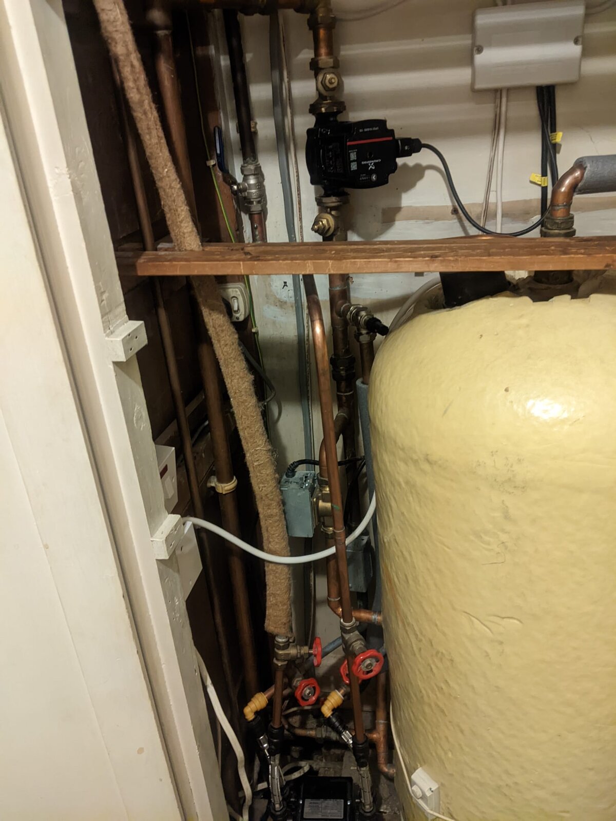

Your engineer said (return pipe) should be replaced from boiler to airing cupboard, does this pipe also feed the HW cylinder coil, either to a S system with separate zone valves or is it a Y system with a mid position valve?
Hmmn my knowledge isn't up to answering that. Does this photo help?
  • Thanks
Reactions: CBW
What is the make/model of the boiler?
Have you separate zone valves for upstairs/downstairs heating? I can see two motorized valves in your photo, one of which is for the HW cylinder coil to control the HW temperature.

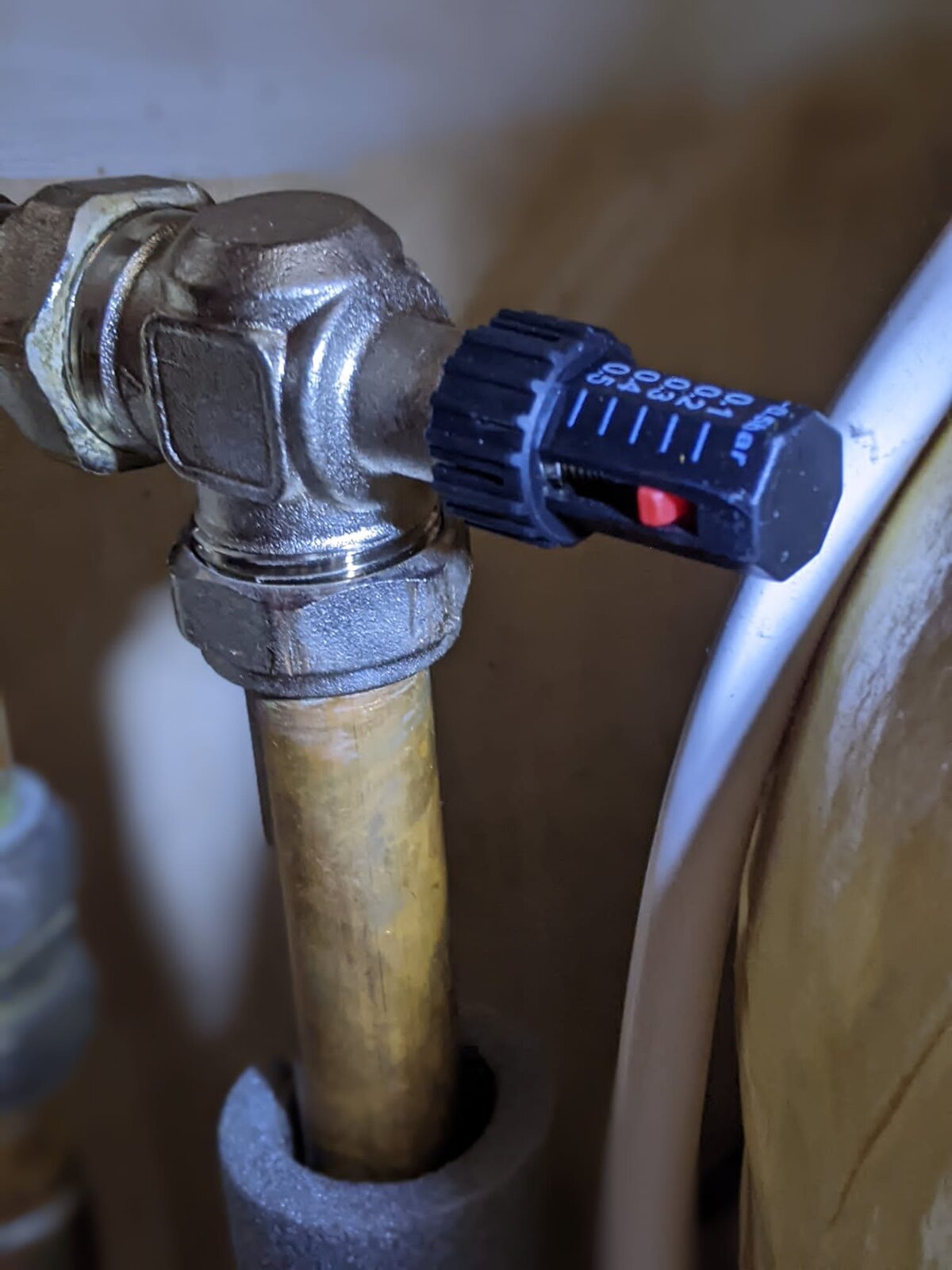

There is a automatic bypass valve located a little further down from the circ pump can you see what setting this is on, it should show a setting between say 3.0 to 4.5

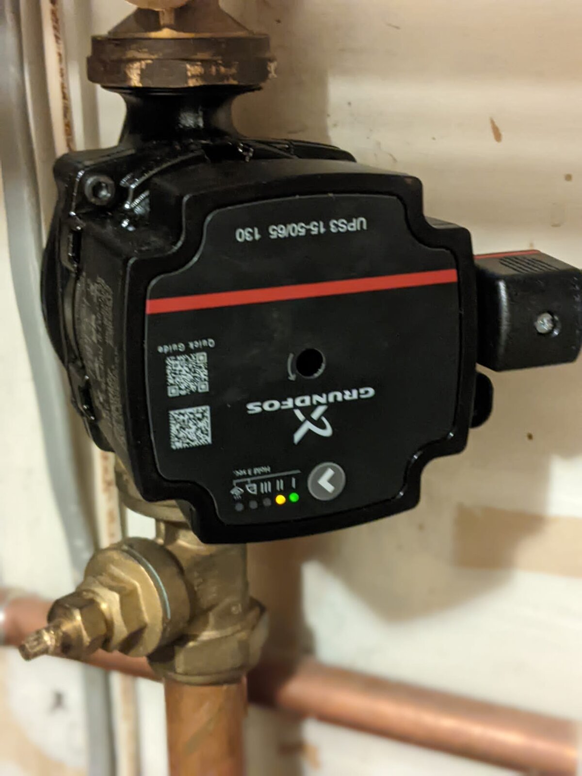

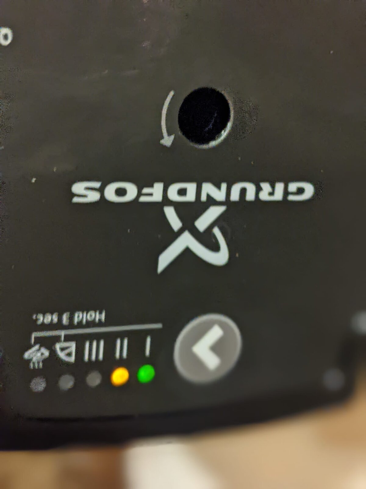

When the pump is running can you take a photo of the LEDs, also pump model.it looks to be orientatd correctly pumping downwards as they didn't bother to swing the head around, check that arrow on the pump body is pointing downwards just to be sure.
Hi so sorry for the delay I was away from the house. It's a Gloworm Energy 18R. I've attached a couple of pics of the pump LEDs
That pump is on Speed2 which should provide plenty of flow as it it will pump up to 28LPM at a 5.2M head.
There is a automatic bypass valve located a little further down from (below) the circ pump can you see what setting this is on, it should show a setting between say 3.0 to 4.5
Yes it is! should have selected it and its clearly seen.
Would suggest to OP that he keepks turning it clockwise (lots of turns) until it reads 0.45, its probably recirculating anything up to 18LPM at that 0.2 setting, a setting of 0.45 with a pump head of > 5M should recirc ~ 5 to 6LPM and should help to circulate the water through the rads.
  • Like
Reactions: CBW
The cold morning this morning helped make a judgement on the change. I set it to 0.45 and there is now a toasty hot first radiator downstairs on the system but the next two are only lukewarm after 3 hours of running while the final is cold (this one has always been somewhat poor).
