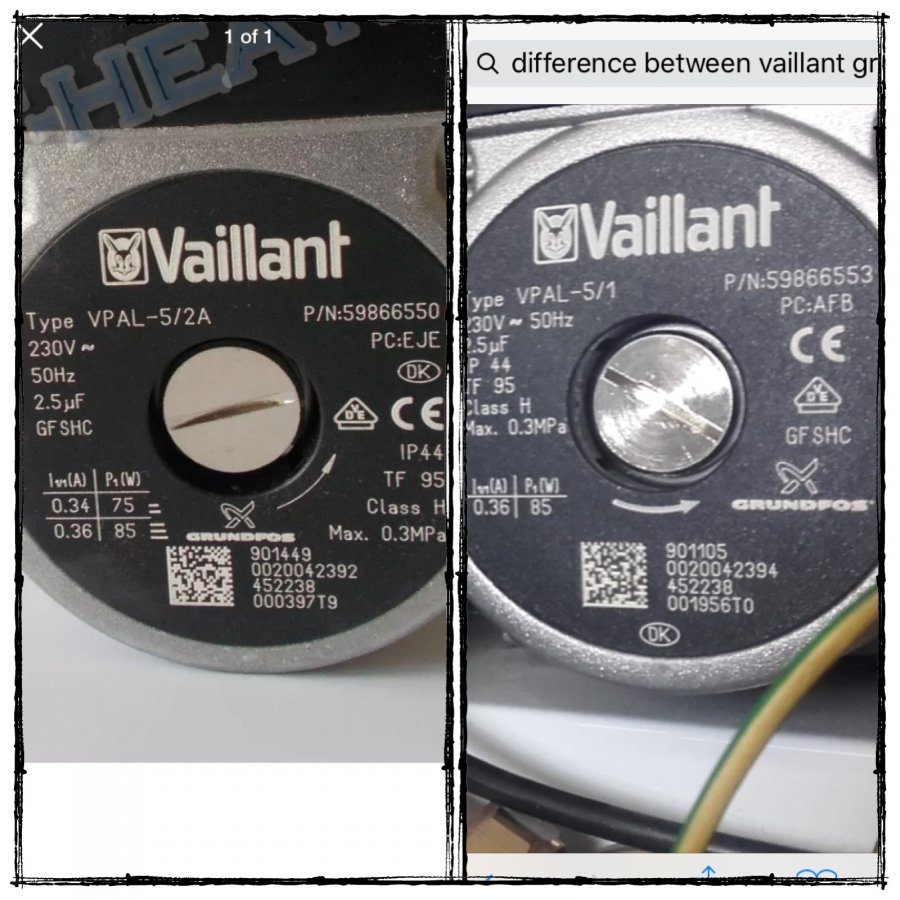

Whats the difference between these 2 grundfoss wilo replacements then?
Which is newest/latest for ecotec plus 824?

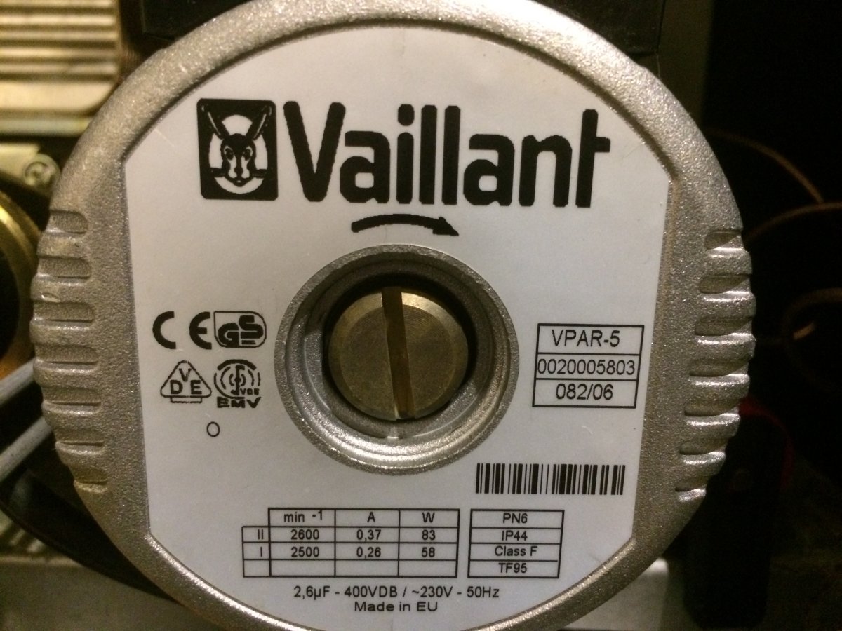

The one on the left, the two speed pump with five wires. Vaillant part number 178983 if it's the one with control knobs. The later version has only buttons and never came with a Wilo.

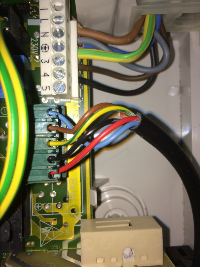

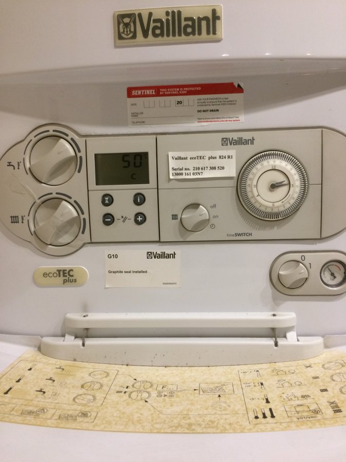

My boiler is the ecotec plus 824 R1 here's images of boiler and pump and connection to circuit board.
So its still the one on the left?
Many thanks
Yes, and you have to change the whole pump, not just the head. But it's quite easy really.
The photo on the left is the pump for the older 2005 – 2012 Ecotec Plus and Pro models. This pump is a 2 speed pump with 5 wire connection. The photo on the right is for the later, 2012 – 2015 Ecotec Pro models only. This is a single speed pump.
The silly thing is they both have the same part number of 178983
