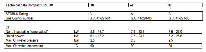

The Intergas 30 OV doesn't actually seem to give out 30KW. Only about 26.5KW.

If someone needs a big open vent boiler e.g. 35 KW, which is the most free flowing and least likely to clog. It look like Intergas OV only goes to 27KW actual output. Is it Worcester Bosch 8000? Someone told me you can actually get the really big Intergas system boiler and remove the pressure sensor and run it OV.

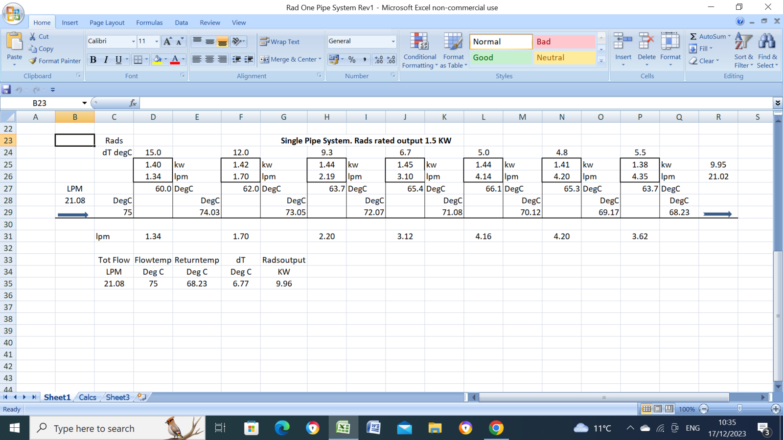

Just looking at it from another angle re need for LLH/PHEX etc from a thermodynamic point of view. I did these calcs below for someone or other who had a problem 7 rad, one pipe system and wanted to know the theoretical flows required to enable every 1.5kw rad to give its rated output, I can't really remember but I think he said that the boiler dT was too low and the boiler was sensing this and tripping. You can see from the (virtually impossible to achieve in practice) calcs that the dT is ~ 7C so in practice would assume that this is a lot closer??.with the rads output reducing progressively down the line. These calcs don't addup either as the total rad output is, by calc, 9.95kw but based on the total flow and dT is 14.96kw, will have another look.
Edit: Corrected now.
JackK might just feel the boiler flow/return to get a feel for the dT (if no thermal gun) and also inform if the 17 rads are all on the one pipe or are say half on one, one pipe and the remainder on another one pipe.
