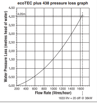

Sounds like one pump is to send the water through the boiler and the other to send it around the radiators and cylinder. With modern boilers, it can take a lot of pump power just to push the water through the boiler. So sometimes two pumps are used. That is probably what "reconfigure pipework for hydronic separation" means. It may involve a low loss header.
If hydronic separation is required then surely another 15-60 pump is quite adequate since the main "advantage" of a LLH is that one pump takes care of the boiler HEX loss and the secondary pump circulates through the system and deals with those head losses.
Depending on the number/output of the installed rads/UFH etc then its quite possible that a 8M pump (like the UPS2) which would still leave 4M to deal with the system losses after the boiler HEX without any need for a LLH or CCTs which may be the proposal because there is no mention of a LLH in the quotation.
Hydronic separation comes in several methods.
LLH (low loss header)
PHEX (plate to plate heat exchanger)
CCTs (close coupled Tees)
I would ask which they are considering and why.
A PHEX keeps the 2 water circuits completely separate whereas the other 2 do not.
It may be that your radiators and connecting pipework is old and therefore potentially sludged up and they do not want to risk this contaminating the boiler HEX and also keep the system side open vent so as to not pressurise old pipework that could spring leaks.

The Vaillant HEX will have a far higher head loss than your old Ideal Mexico one has but that doesn't automatically mean you need a LLH or whatever, if a LLH or a PHEX is the recommendation then they havn't quoted for either, how many rads have you?.
If one pump only is required then, depending on number of rads, you may require a 8M pump, the UPS3 while a very powerful pump has a max head of ~ 6.4M.

The head loss is the pressure loss in the pipework, boiler heat exchanger, radiatore etc, the height doesn't matter, what goes up must come down, you can see from the boiler pressure loss graph in post #2 that the head loss is over 4M at the sort of flowrates that you might require if the 17 rads are all on together, this leaves say 2.4M (UPS3) to circulate this flow through the rads etc, a fairly tall order IMO, you would probably require 3.5/4.0bar, which the 8M UPS2 will comfortably provide.

The head loss in the "one" pipe will be very very low but as the rads are running in parallel with that pipe then I think it would be prudent to install the 8M UPS2, it can allways be run at a 6M (or 7M) head if sufficient and the extra cost of say £200 isn't a fortune bearing in mind that you will be spending ~ £4000 in any event?
