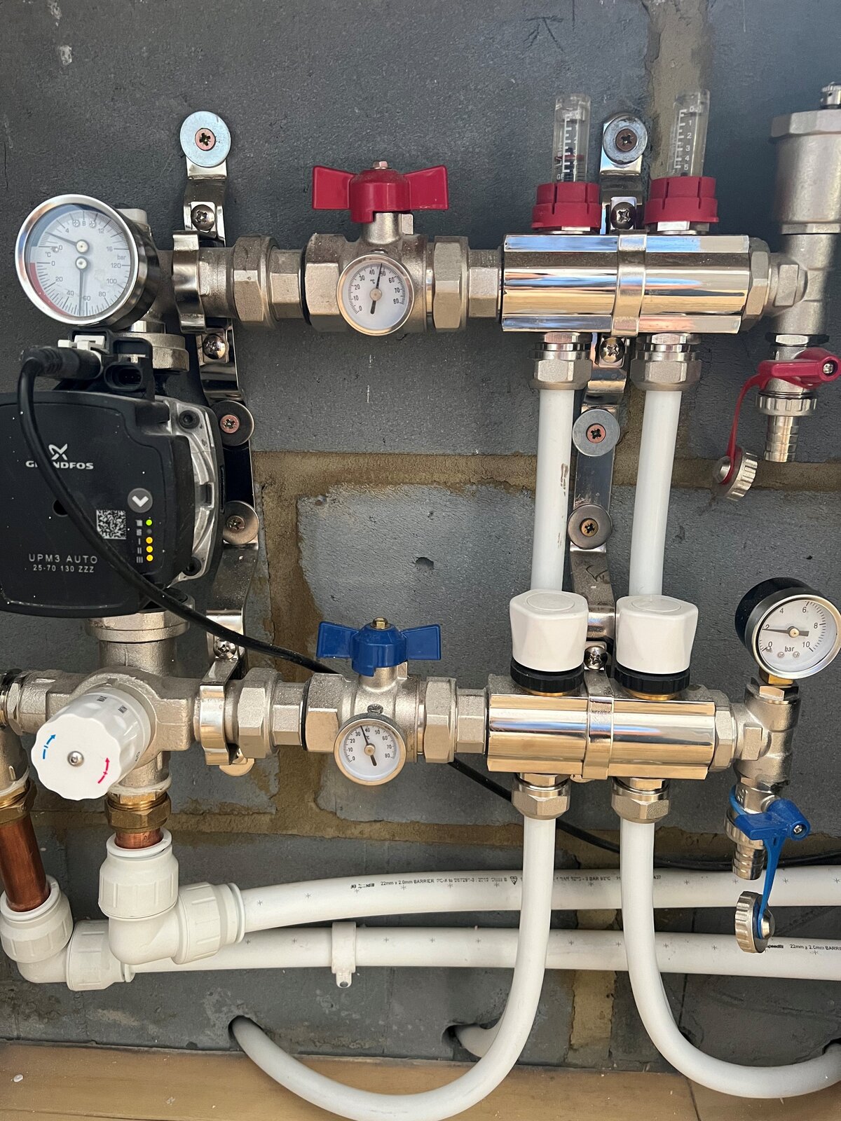

Just put on the UFH with the rads, let the system heat up for say 15 minutes or so.
UFH: there are two flow meters on the top (flow) manifold which read 0 to 5 (L/min), to the left of these, under the red handled isol valve is a temperature gauge, on the bottom (return) manifold under the blue handled isol valve is another temperature gauge. When the system has been on for 15/20 minutes read off the two flows and the two temperature readings and post back.
thanks @Johntheo5. I have attached a photo (taken last October) of my UFH system. As requested, I will take a reading of the flow meters along with the two temperature readings once the system (both, central heating and UFH are both on) is on for 15-20 minutes.
The blending valve temperature is currently set between 45 and 50.
I know a couple of heating engineers have tinkered with the flow meters when observing the UFH running on its own for a couple of minutes.

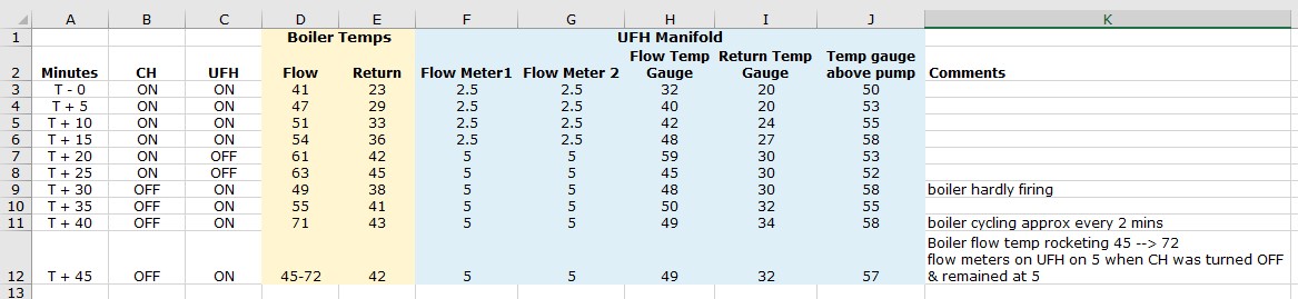

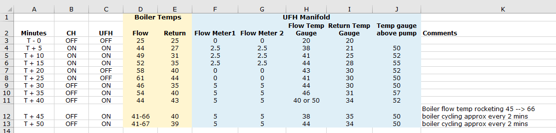

@Johntheo5 - I took some readings of both, the boiler and UFH. The readings are shown below (I also attached a file showing these readings incase the image below did not come through).
I took the readings across 5 minute intervals. What I found is that when I had both, CH and UFH turned on, the boiler was happily firing (without any sound of kettling which there was earlier in the week). The flow meters on the UFH was showing 2.5 (range 0-5). When I turned off the UFH, the flow meters on the UFH went to 5 and these flow meters stayed on 5 when I turned on the UFH and turned off the CH.
After about 10 minutes of the UFH only being on, I could see the boiler short cyling (every 2 mins) and the boiler flow temperature would rocket from 45 to 72 degrees. I hope this helps but happy to do some further tests to get to the root cause of the problem.

Some strange readings there, if you take test 6 (T+15), CH+UFH ON, it shows blr flow/returns of 54C/36C. and UFH flow/returns of 48C/27C with combined flows of 5LPM, this gives a UFH output of 7.3kw but the temp gauge above the pump reads 58C which should be the same as the manifold flow temperature (48C).
Test 11, (T+40) UFH only on shows blr flow/returns of 71C/36C. and UFH flow/returns of 49C/34 with combined flows of 10LPM, giving a UFH output of 10.5kw, however the boiler is cycling, but even if the UFH requirement is only 5kw then the cycling shouldn't be excessive.
Very strange as to why the UFH flow increases to 10LPM and even more strange that with the CH on and the UFH off that the flow was still 10LPM.
When the CH is on but UFH off is the manifold pump off and is there a UFH zone valve somewhere that switches this pump on/off?.
What was the boiler flow target (setpoint) temperature for the above tests?.

@Johntheo5 - I decided to run a fresh test today and the readings are shown below. The boiler temp is set at 65 degrees. When the UFH is off, the flow meters are 0 so I must have taken a wrong reading yesterday. Also, on T+40, the flow temp on UFH was either 40 or 50. I wrote down 50 at the time but I think that was wrong and it should have possibly been 40.
Are the readings still strange? No kettling sound from the boiler when I was running these test readings.

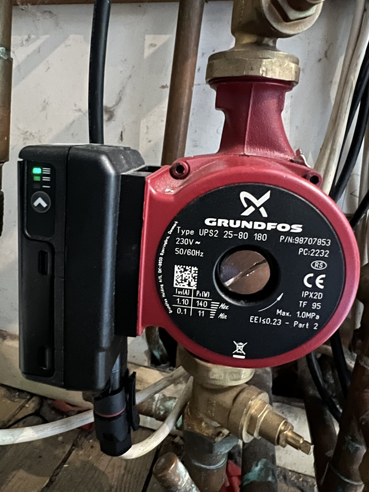

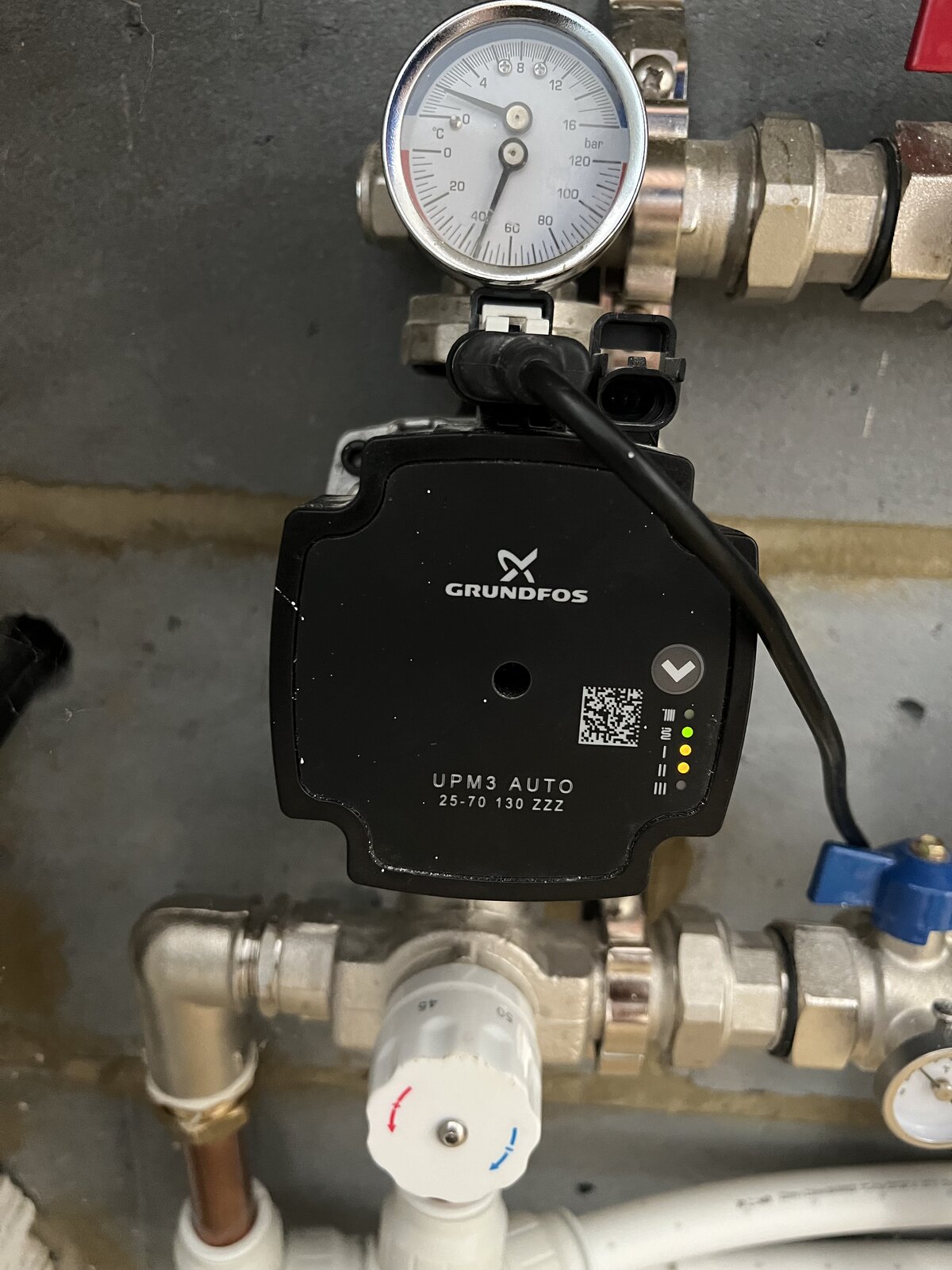

I have also attached photos of the main pump and UFH pump when both, the CH and UFH are on

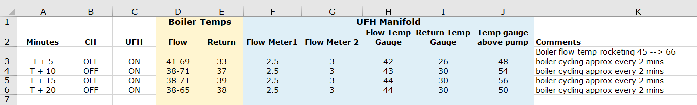

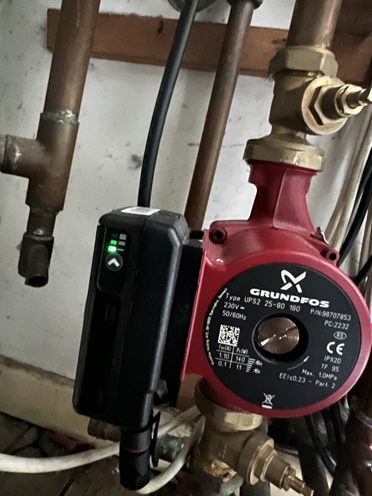

@Johntheo5 - just to run some further tests, I reduced the speed of the main pump to speed (1) from speed (3) (photo attached) and took the following readings with just the UFH on.
