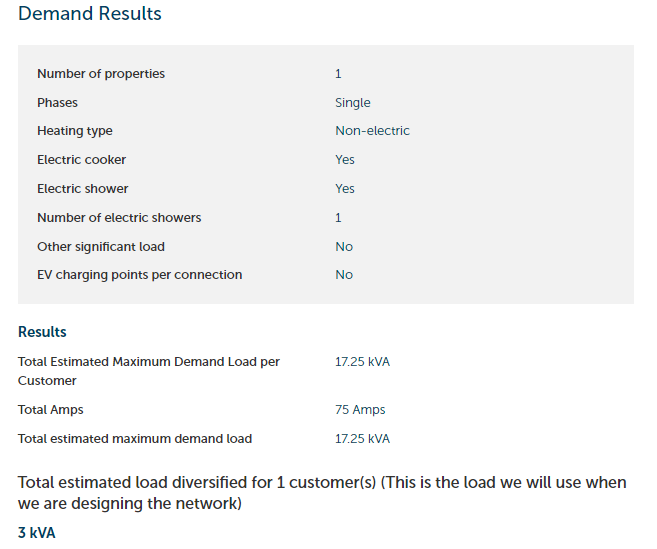

I've just done this with SSENs on-line 'demand estimating calculator'. It's for one domestic property with an electric cooker and and one electric shower, but no other 'significant loads other than the assumed 'baseline maximum demand' of 6.25 kVA per domestic property. As you can see, for a maximum (instantaneous) demand of 17.255 kVA, they design their network on the basis of it representing 3 kVA ('after diversity') load
but bear in mind the vast majority of my work is commercial, where a 100A supply will be expected to run at 100A 24/7,
That's obviously totally different, and irrelevant to participants in this forum. The 6:1 (or whatever) diversity factor DNOs work with relates specifically and only to domestic properties ('dwellings') - where most loads only draw current for a tiny fraction of a day,not "24/7".
