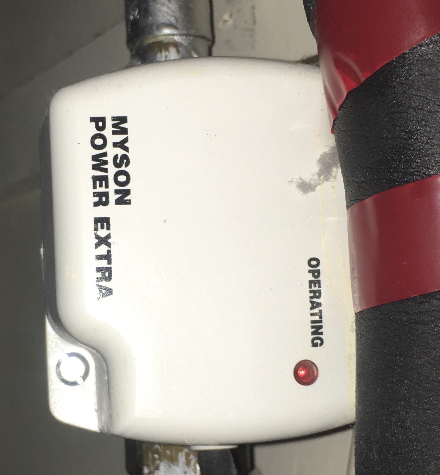

So I have an issue with hot water being slightly hotter than usual. I have checked and the immersion heater is definitely off. I replaced the cylinder thermostat and still no joy. The 2 port is a Myson, but I can’t work out how to get inside it. If I turn water on at the programmer, and wait for it to heat up, then test if the thermostat is asking for hot water after the boiler has gone off, and then also check the 2 port orange or brown wire?
Thank you. Hope this is a good photo
I suspected it would be a power extra, if it ever worked properly you will need a new actuator,but one of the worst valves for being wired up wrong from install
I think it worked properly, and possibly still does. When the water is on, it powers up, boiler kicks in, water heats up, then when water goes off on program it all turns off. Yet hot water is really hot and hotter than when I first moved in.

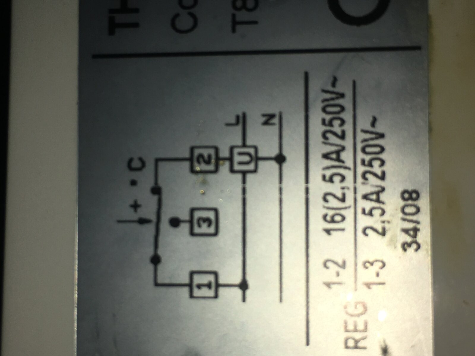

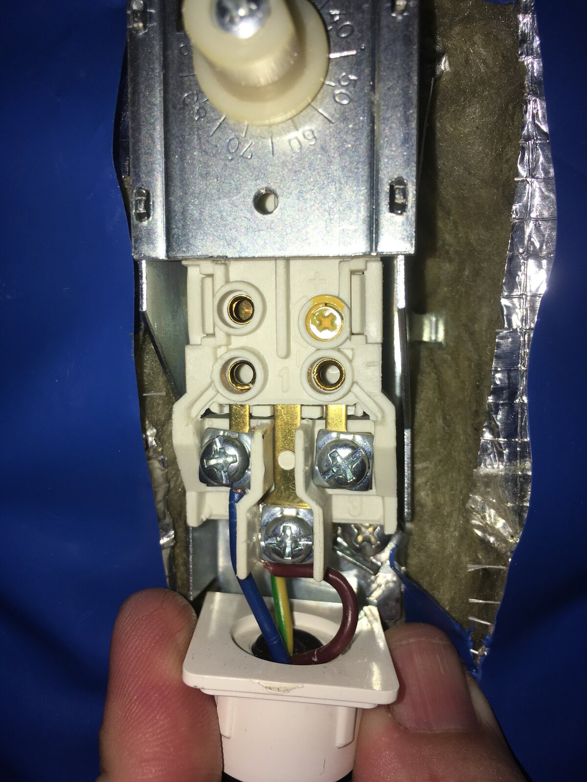

This is my replacement thermostat, does it look wired correctly?
60 degrees is required to kill off any legionnaires growth yes, so keep it at that. Wiring looks ok to me. Might be microswitch or motor inside powerhead that may have failed? @ianmcd will know better than me.

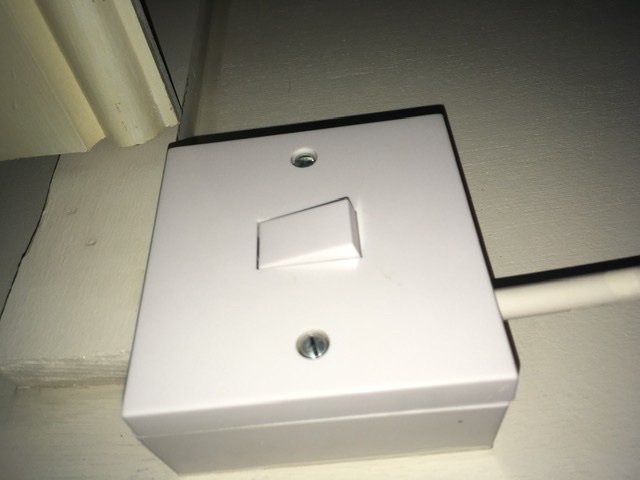

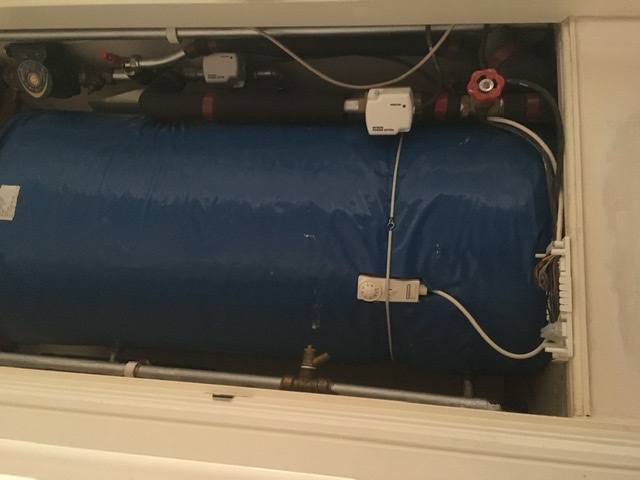

Thanks Ian, yes immersion seems to be off unless the switch is wired wrong? Looked up about the position of thermostat, does mine look ok?
don’t worry electrics turned off and will refit cover
Normally Immersion switches have a red neon to indicate if it is on , are you sure you have the correct switch ?
