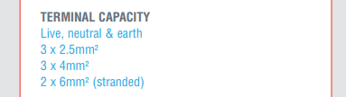

If you read the specifications from the manufacturers (or indeed BS1363) you will see that four conductors isn't acceptable.
I think you are taking things too literally, as you are with (informative) App 15.
This from MK -
Using your logic, you cannot use only two conductors except with 6mm².
Quite rightly you can say that is ridiculous.
As it has the 'capacity' for two 6mm² conductors, then, clearly, it will accept four 2.5mm².
Is your objection to 4 x 2.5 merely that MK have not specifically given you the go ahead or do you think damage will be done, either electrically or mechanically?
There's nothing in BS1363 that prohibits terminals capable of accepting four (or more) conductors, only that they shall accept one, two or three 2.5mm² or one or two 4mm² conductors in the live terminals,, and one, two or three 1.5mm² or 2.5mm² or one or two 4mm² in the earthing terminals.
There's nothing in BS1363 that prohibits terminals capable of accepting four (or more) conductors, only that they shall accept one, two or three 2.5mm² or one or two 4mm² conductors in the live terminals ...
Interesting. When you say 'accept', is the requirement simply that the terminals should be able to physically accommodate the conductors, or are some functional 'tests' involved.
What you say about 4mm² conductors is interesting. EFLI was therefore probably right to question whether there are some (BS1363-compliant) sockets that could not accommodate a branch in a 4mm² radial - and from what you say, it sounds as if a socket could be BS1363-compliant but not able to allow such a branch - is that the case?
Kind Regards, John
