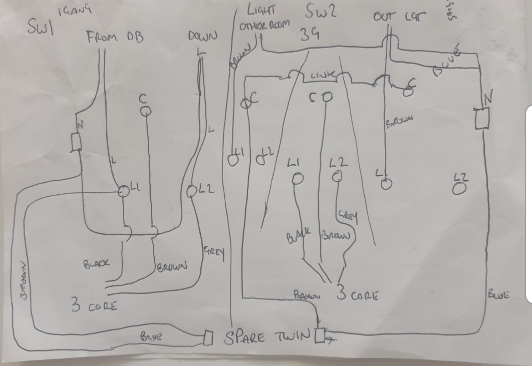

Like this probably/maybe, sorry it's not the neatest I've had a few skoll lol
Work out which are loop in/loop out cables (normally found at ceiling rose but appears to have been looped at the switch which is not uncommon). Three core and earth, connect the live (brown) to Com. switched lives (black and grey) to L1 and L2, as long they are consistent at each switch it wont matter which way round. Then sort out the supply, loop in /loop out in a terminal block shoe horned into L2 live brown and L2 blue neutral. Earths sorted accordingly. You can then work out the wiring for the outside light etc.

Ok,
Apologies for the drawing and lack of labels, it's been done on my phone! :)
It may look something like this.
Earth's excluded for clarity.

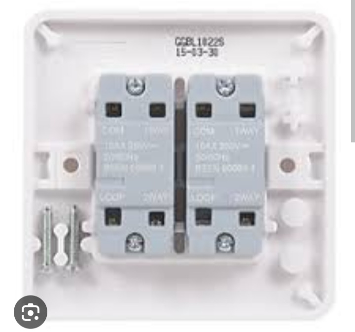

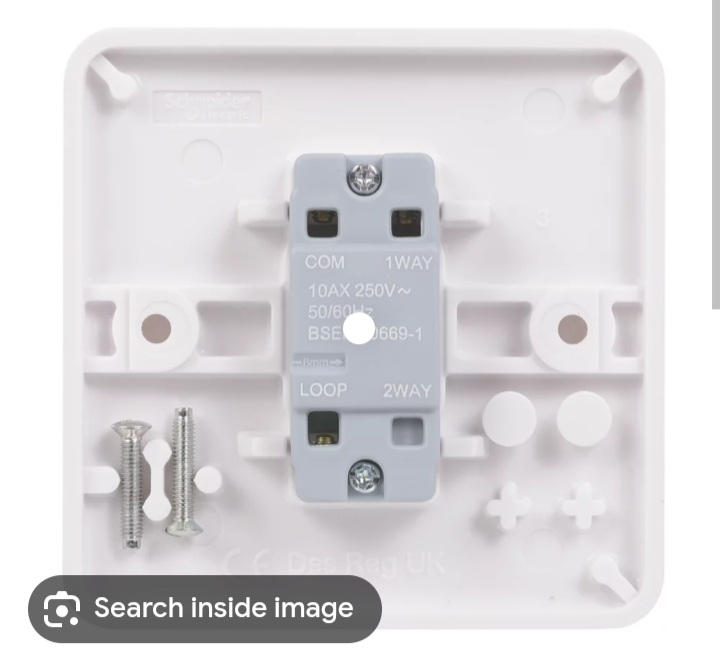

If you get switches with a loop terminal it will be easier...
Edit, added labels!
Additionally, the grey and black wires should be oversleeved in brown, to denote they are switched lives.
Oh I had it as a 3 gang to switch light in the other room, sorry so with 2 gang just put that brown into common instead of L1 as I had it.
