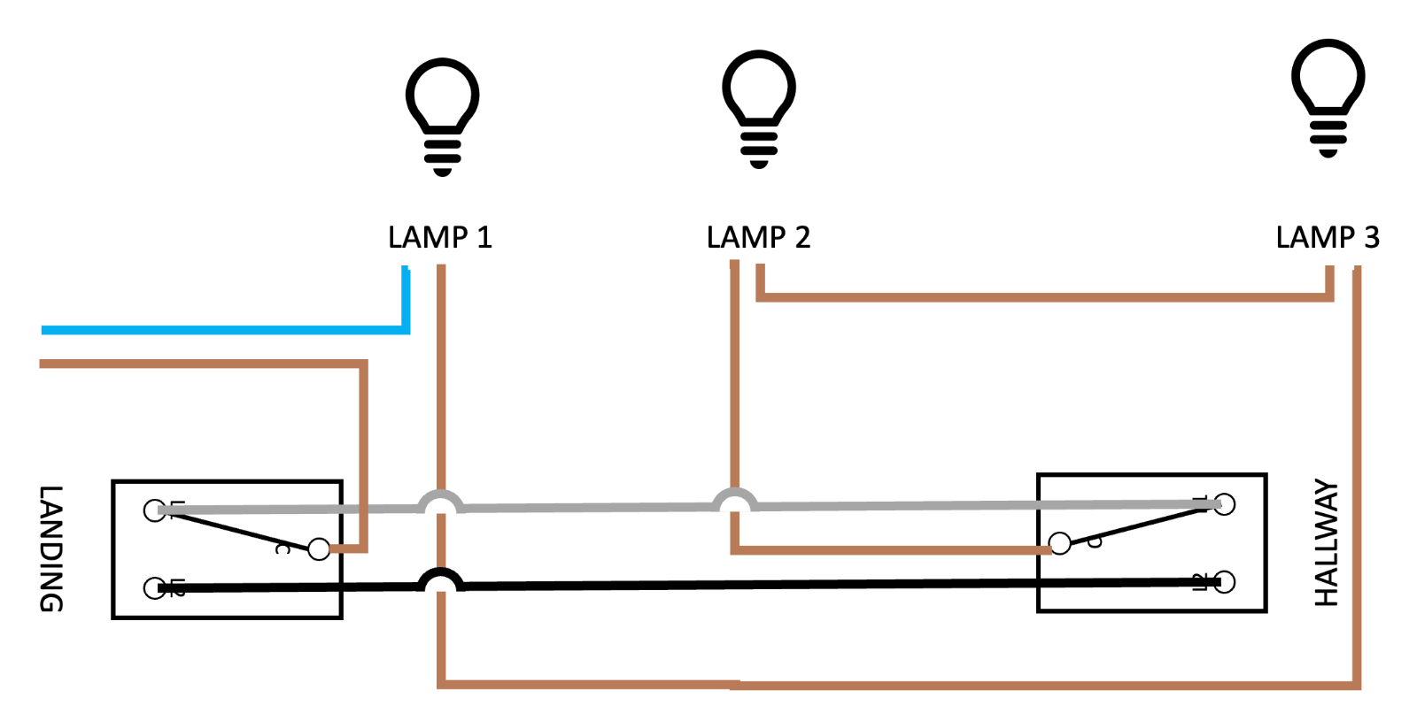

I seem to have confused the hell out of myself so looking for a little advice.

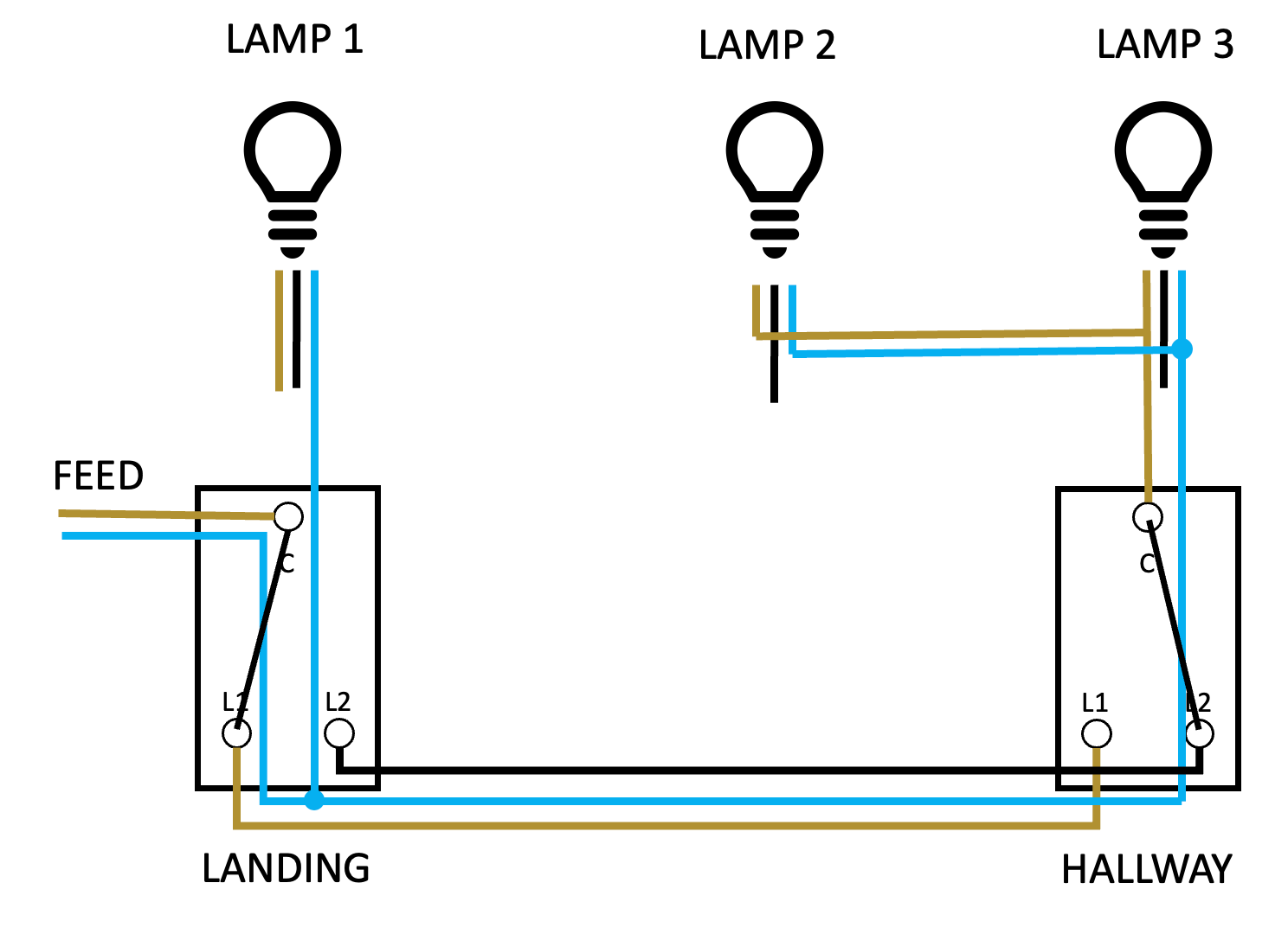

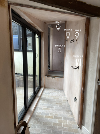

I have 2 x 2 way switches. I need to control 3 lamps as seen in the drawing below.
I have:
2 core + E feed coming in to Switch 1
3 core + E from Switch 1 to Lamp 1
3 core + E from Switch 1 to Switch 2
3 core + E from Switch 2 to Lamp 3
3 core + E from Lamp 3 to Lamp 2

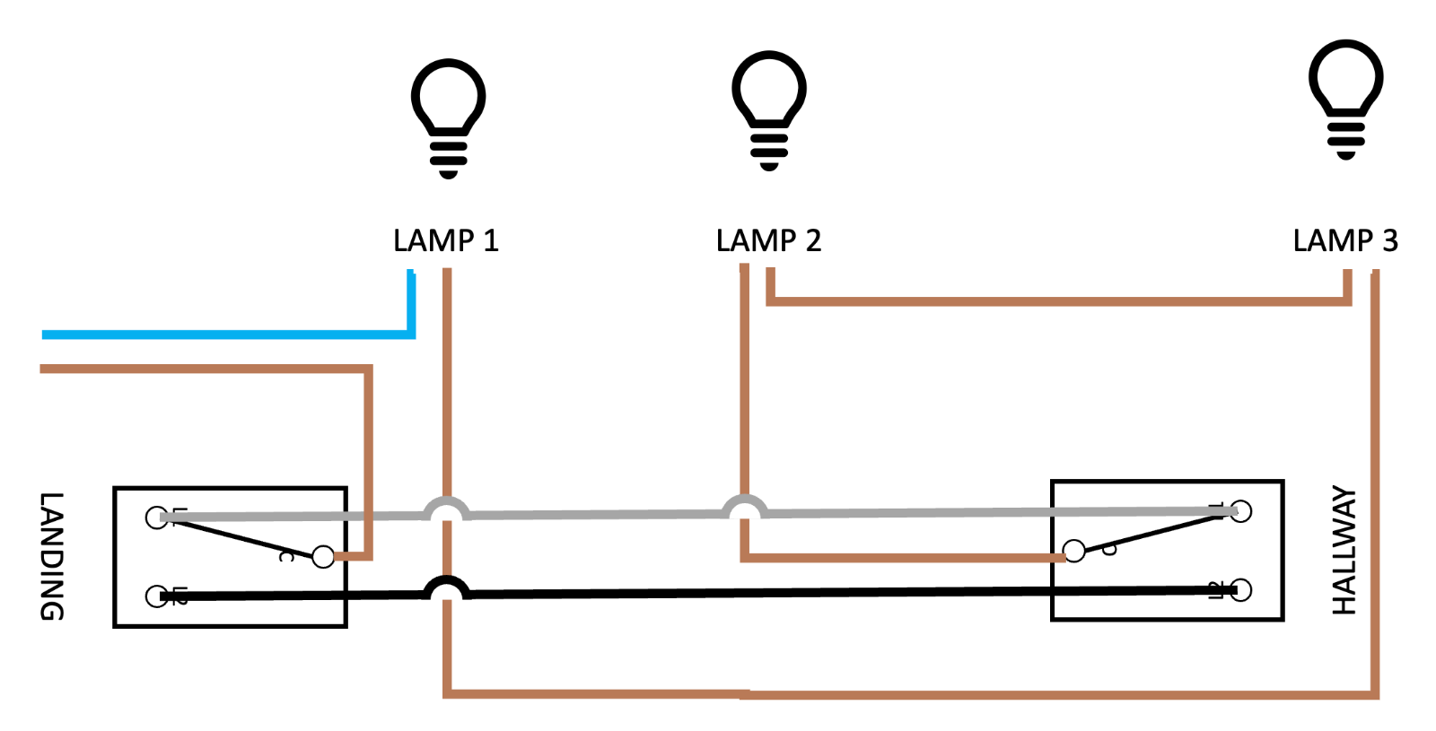

I want all 3 lights controlled by switches 1 and 2 ideally but I'm struggling to work out how to connect Lamp 1. (diagram below)
Can't connect lamp 1 live to common as it will always be on. Any help much appreciated.

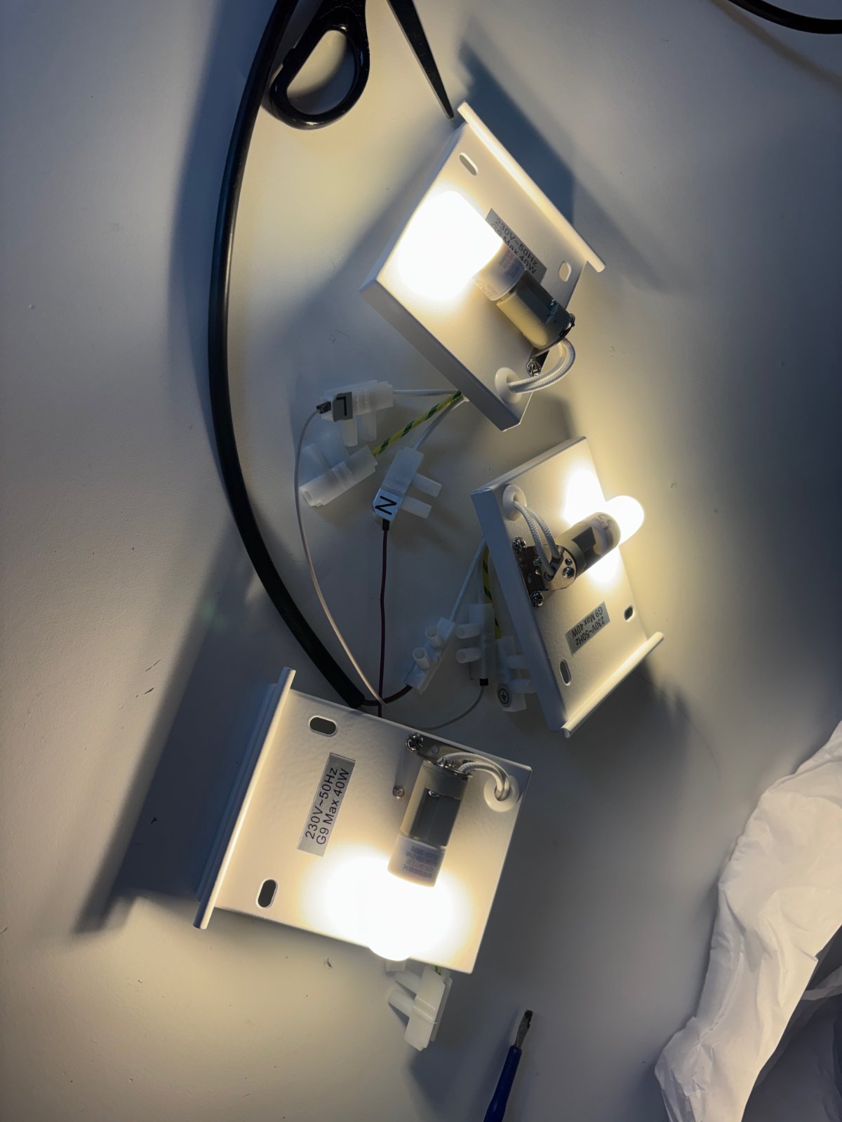

All 3 lights are Knightsbridge PWL1 plaster wall lights with live and neutral connectors and G9 bulbs https://www.mlaccessories.co.uk/products/4356202/datasheet.html
Ok - then you will either need a five core cable (4 core + E) between the switches or another 3 core +E cable from lamp 1 to lamp 2 (or 3).
Another solution would be to install a Kinetic switch/receiver in one switch location and a remote kinetic switch in the other.

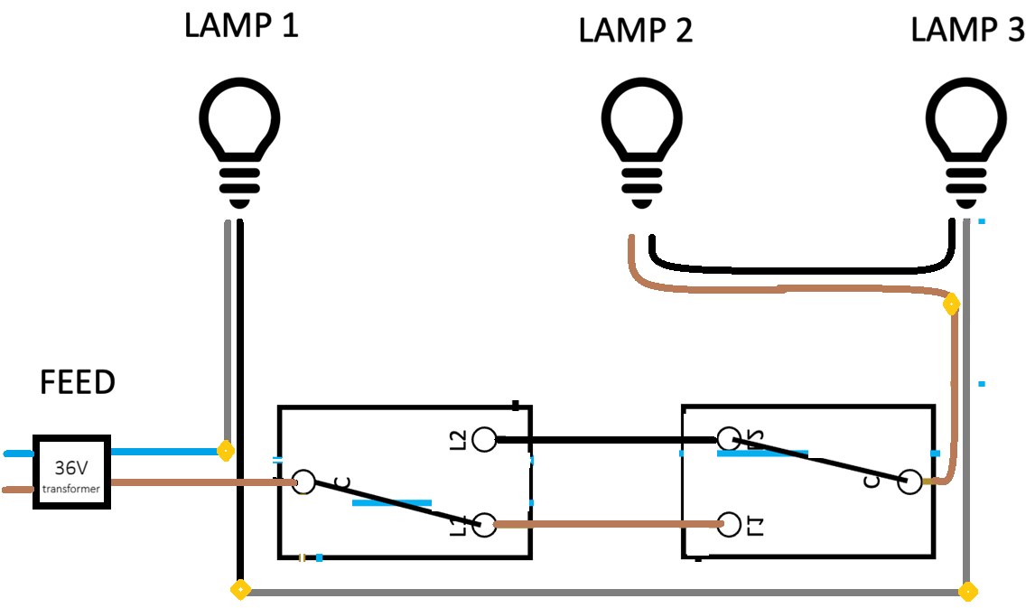

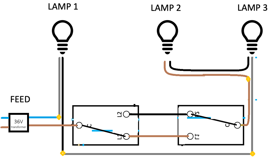

Another could be to use 12V bulbs (which would all have to be of the same rating) wired in series and introduce a 36V transformer

Another could be to use 12V bulbs (which would all have to be of the same rating) wired in series and introduce a 36V transformerView attachment 402767
Thank you. I have a bunch of Quinetic switches elsewhere. The reason I have ruled these out is that switch 1 is a 3 gang 2 way switch. Using the Quinetic euro modules I'd only be able to get 2 gangs in a single back box.
I like the idea of the 12V bulbs but would struggle to fit in a transformer.
I think I am going to solve this with a couple of Shelly smart switches. 1 at switch 2 which would connect common to SW to read when lamps 2 & 3 have power, and another behind switch 1 (but not connected) which mirrors the on off state of the other Shelly.
