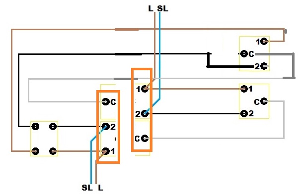

I changed some light fittings prior to a friends house move today then I thought I'd done something wrong in the landing lights and the hall light.
2 gang at the top and bottom of the stairs plus an intermediate in the hall downstairs.
After a bit of head scratching here's the circuit.

Is it me, or have they not just accidentally switched the two greys around in the two gang switch?
Also the intermediate should not connect to a COM terminal. The two wires from the INT switch should connect to L1 and L2 the 2-way switches.

Replacing their 'horrible spotlights' with roses (at buyers request) should have been a POP and in fact it was. This house is under 3 years old and the switches were 'as built', my friend purchased is from new and quickly learnt which switches they could/couldn't use and didn't get round to getting the builder to sort it.
Nearly.
Quite right.
This did take a bit of head scratching, more so because the cable sheath's didn't quite enter the back box and we ended up buzzing out all the wires.
In the end it was a simple grey/grey flip in one switch and a black/grey flip in the other.
