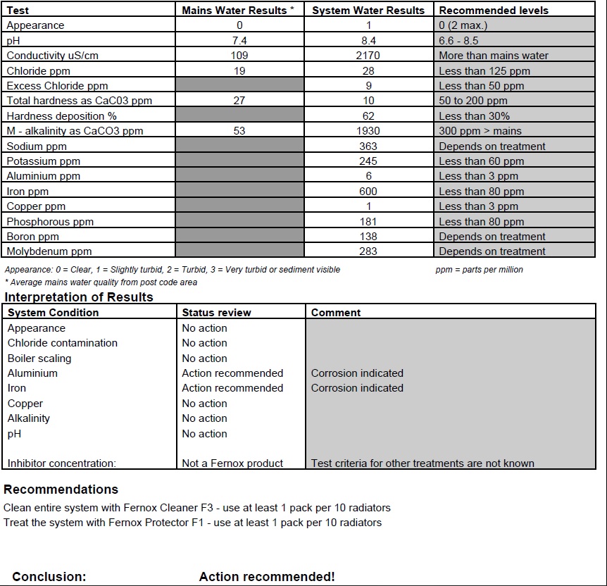

Well no surprises for anyone i think...
Now short of the obvious (corrosion in the system) what do those results say?
Seem to want Fernox inhibitor in the system. I put sentinel in. Surely it's all the same stuff? Inhibitor is inhibitor?
But anyway the guy is due to come back out in a couple weeks to powerflush and magnetic filter install.
It appears those tests were done by Fernox, so no surprise that they recommend Fernox products.
They don't reveal much either - other than there is a certain amount of corrosion, which was fairly obvious just by looking at it.
Different manufacturers use various different chemicals in them. Whether that has any impact on how effective they are is unknown.
Nice that they did the tests for you! The level of detail is good but the real information needed is how much air is dissolved, which would be lost by the time it got there. Even adding inhibitor, if there's air getting in somewhere, it's not good.

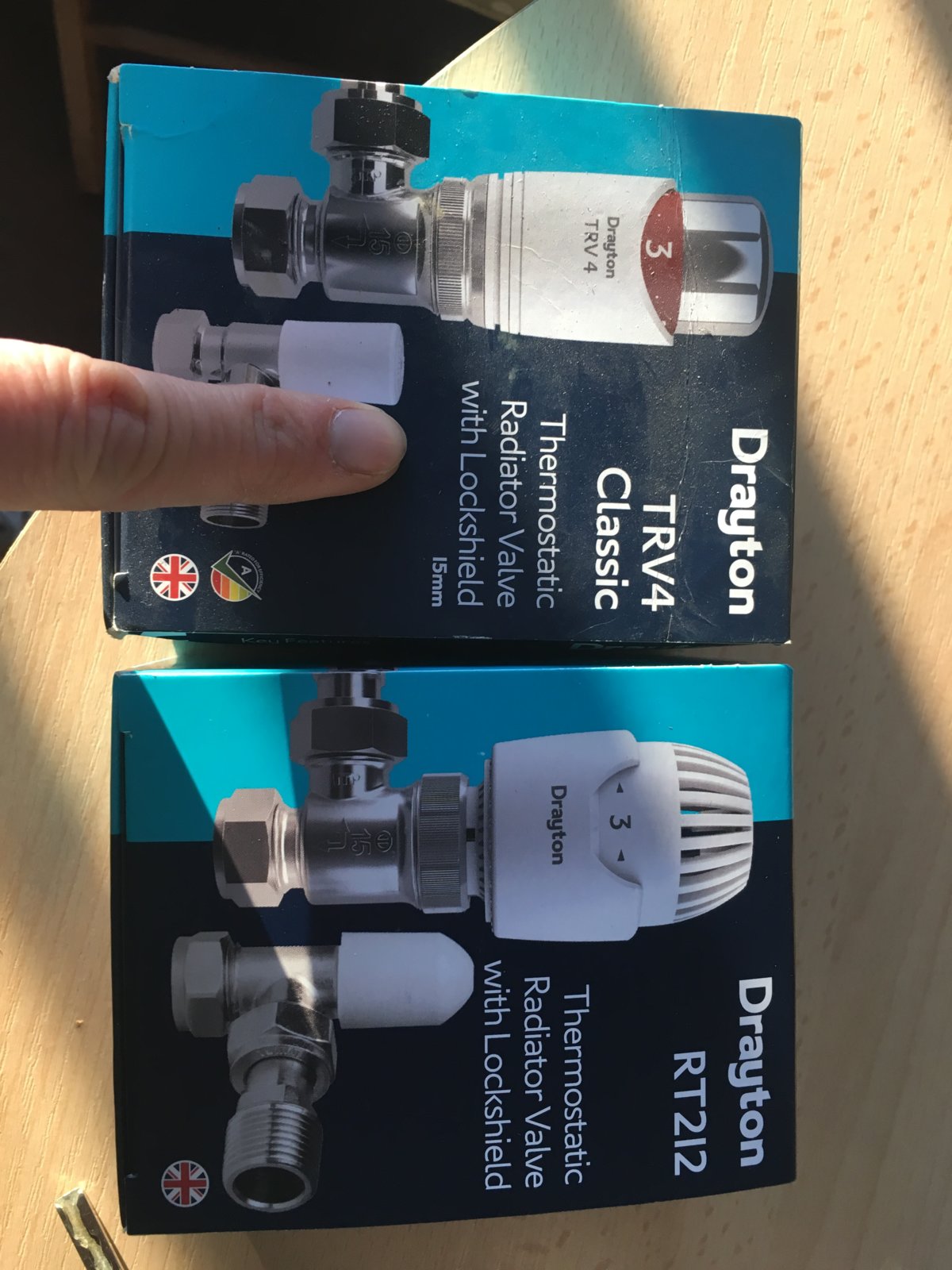

Well since the rad isn't going to be replaced for free i went out & got a new one today.
It's easy to pan Kudox but really the water was crappy and the other Kudox rads are (so far) doing ok. So i can't have complaints really. A big influence was the brackets are already on the wall. The walls have been tanked & when drilling in to them we're supposed to fill them with this certain Sovereign silicone (which we don't have & i'd hate to think of the price for a few holes).
Anyway as part of the deal they threw in a free valve.
The one currently in place is the one i'm pointing to, the freebie being the other.
Is it all much of a muchness and there's really no difference in quality? Would you have one over the other and if so then why?
If there's really bugger all difference then i'll just stick to what's currently in place and look at selling the other one. Even £5 for it is still profit.
