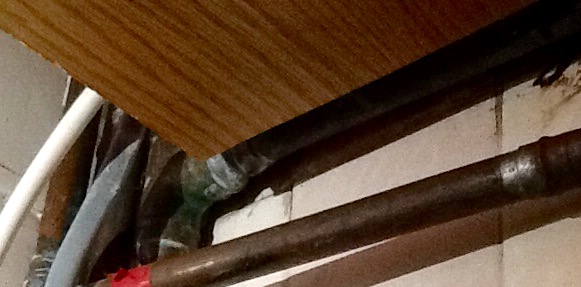

I have upload a picture you can see that the 22mm is reduced to 15mm going into the boiler.
No need for a picture pal. You already know the reason why the pipe needs increasing
Can you repeat the photo taken from a little further away and describe what feeds the cooker?
And estimate the distance from boiler to gas meter?
You can see in the picture that the 22mm is reduced to 15mm going into the boiler, so do I only need to replace the small bit of 15mm to a 22mm?

Basically a 22mm gas pipe goes to the boiler and has t junction, which has 30cm of 15mm pipe going into boiler and the other 15mm going to the cooker.
The distance between from the boiler to the gas meter is 5 metres.
It is basically a 22mm gas pipe which has a t junction, one small 15mm going to the boiler, and the other 15mm going to the cooker.
