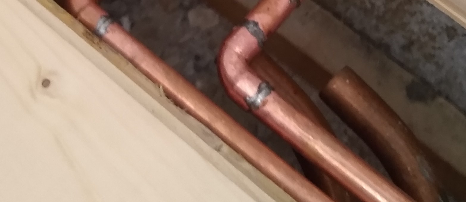

I recently cut and capped some pipe work under my floorboard
However, when you walk on the floor, the pipe below clangs/vibrates
Before they were being supported by the joist
What can I do about this?
Please note that In the pic, the pipe is not capped with the stop end
.... or anchor it securely, or put a scrap of something soft (sponge, foam, rag, underlay etc) between it and whatever it contacts.
