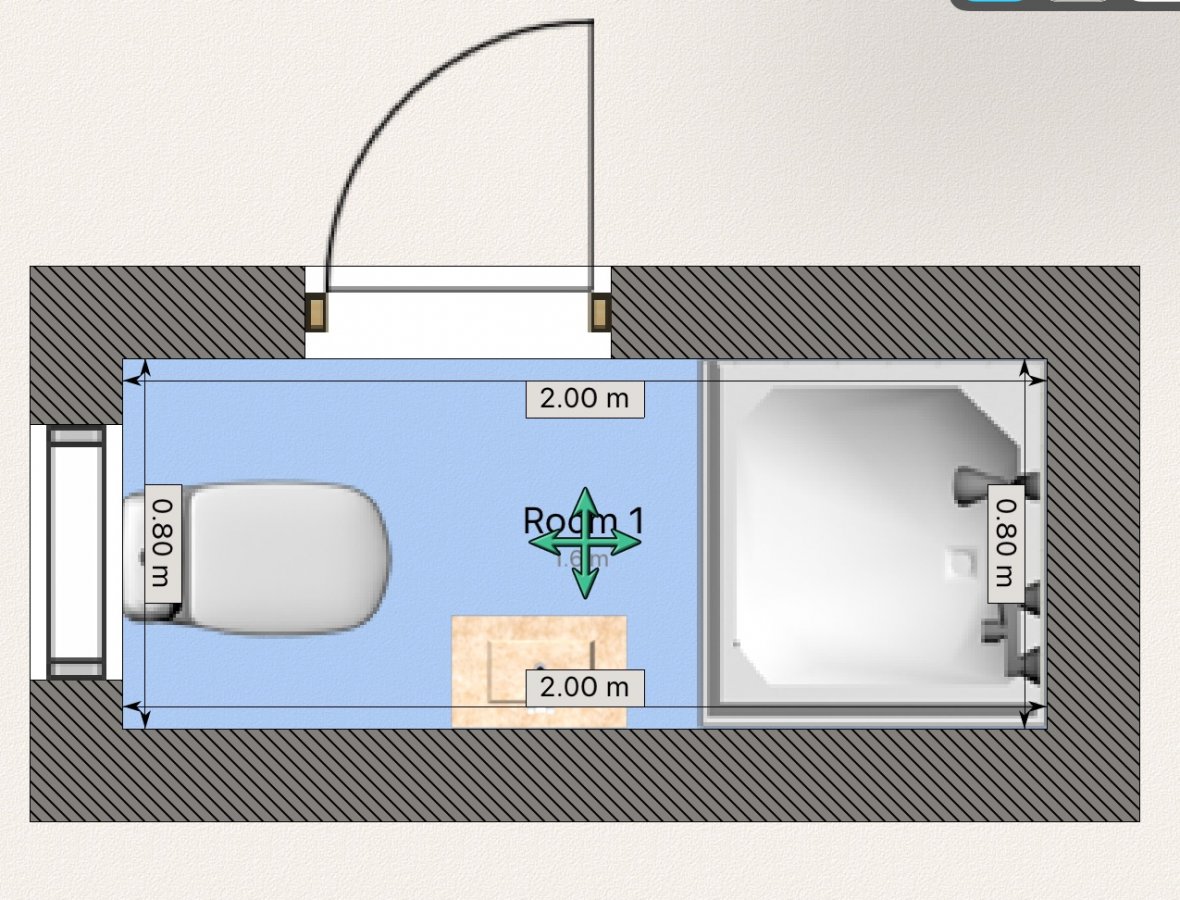

Hi I am making a guest room have a en suite. Attached are plan.
Do you think it works?

It will be snug but functional.
Choose the sanitayware carefully, compact WC etc.
I used to have guest showerroom that small and was ok.
If possible I think I would move the door to the right so the door frame matches the biggest floor space as at the moment you have to goto the room in at an angle to miss the front of the toilet.
sfk
Or hang the door the other way - ie.hinged on the left -or have a slider.
Shower door or curtain? Door may need to concertina or open inwards to avoid basin.
800mm is OK, the length of my en-suite is 2.5m and its OK. Hinge the door very close to the shower. I used a macerator and close coupled suite which I boxed in to give a shelf above the cistern, because the infra red heater was on the wall above the toilet suite. We also used an electric towel rail high on the wall to the side of the suite. the other odd thing was to get a toilet roll holder with a glass shelf over the paper so it could be mounted very close to the basin. Which in our case was full size pedestal.
