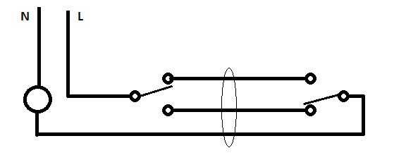

I checked both switches and have the live connected to the com in both switches
If you look at EFLImpudence diagram you will note permanent line is not connected to com. As long as you get the com wire which is only connected to the two com's of the two two way switches, and nothing else connected, then getting L1 or L2 wrong will not stop switch from working it will just mean both switches up, may not be off. Com is permanent line with simple on/off, but not with two way.
It can be wired as
The advantage with EFLImpendance's method is that there is permanent Live at both switches.
With a single way circuit putting Live into L1 and cinnecting Com to the lamp avoids the L2 terminal ( if there ) from becoming Live when the lamp is OFF
Assuming the circuit has been left on, please provide diagrams of how to wire 1-way, 2-way, and intermediate switches such that there are no terminals with live conductors in them when the light is off.
... getting L1 or L2 wrong will not stop switch from working it will just mean both switches up, may not be off.
True (and equally true that both switches down may not be off). However, that is of very little practical consequence in normal use, since someone looking at one switch will usually have no idea as to the position of the other one.

Also with this method, an extra connector is required.
The OP may one day return but at the moment we don't even know which switch (at which end of the diagram) he is working on.
There is no mention of additional L/SL wires, merely -
"I checked both switches and have the live connected to the com in both switches and then 1 wire each going to bothe the L1 and L2 on both switches."
that live will, of course, depend on the position of the switch - at one end at least.
Indeed. Certainly in the past, and undoubtedly sometimes now, some may be tempted to avoid that, and also to remove the need for a 3-core cable, by doing ...
That has at least two problems. Firstly, the lack of paired L/N conductors in the cables introduces potential EMC issues. Secondly, particularly in the common situation of hall/landing switches, it also introduces a relatively high temptation to use L and N from different circuits ('borrowed neutral' or 'borrowed line'), with the problems and potential risks that can introduce.
