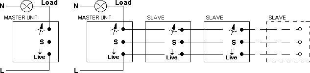

I am trying to replace my switches on my hall and landing with these.
2 Gang 2 Way White IQ Master Remote - Touch Dimmer (I have 1 of these)
1 Gang 2 Way Slave Dimmer (I have 3 of these)
Downstairs I have a 1 gang switch with Com, L1 and L2 controlling the downstairs light
Downstairs I also have a 2 gang switch with Com, L1 and L2 on one side Com, L1 and L2 on the other side controlling the downstairs and upstairs lights
(On this switch there is a small cable that runs from the com on one side to the com on the other side and only one com has a cable going out)
Upstairs I have a 1 gang switch with Com, L1 and L2 controlling the upstairs light
Upstairs I also have a 1 gang switch with 2 x L1 and 2 x L2 controlling the upstairs light
The problem I have is each new switch only has Live, Slave and Load. I can do this for most of the switches by putting Com to Live and L1 to Load and L2 to Slave.
What do I do with the upstairs switch that only has 2 x L1 and 2 x L2. I tried putting both the L1's to Load and both the L2's to Slave but it did not work.
Any help would be greatly appreciated.

This is what the diagrams say but it does not look like it matches the intermediate switch:
Using Master and Slave Units in 2-Way and Intermediate Circuits
2-way lighting circuits have two switches (intermediate circuits have 3 or more switches) turning the same lights on and off from 2 (or more) locations (eg. at the top and bottom of the stairs). In suitable circuits one of the switches will have a live wire connected. Replace this switch with a Master Dimmer and the other switch(es) with Slave Units to allow dimming from more than one location. Note: If your 2-way or intermediate circuit does not have three direct connections between the switches (as in the diagram) the circuit must be rewired using conventional "2-way" wire (red, blue, yellow & earth).
Master Dimmer: Connect the live wire to the terminal marked "Liveo" and the "load" wire to the terminal marked " ".
Slave Units: Must be wired to the Master unit as follows: "Liveo" to "Liveo", "S" to "S" and " " to " ".
Not does not match an intermediate switch
That is not how the IQ/VArilighjt system works. It does not work with conventional 2 way or intermediate switches.
Look at the diagram, It says MASTER SLAVE SLAVE SLAVE.........
Nowhere does it say "intermediate".
I thought that is what I said in my previous post.
You have to install an IQ/Varilight dimmer at each and every switch point.
First of all. follow my instructions. Look at your wiring and see if it is suitable.
Then, go and buy a master and as many slave dimmers as needed.
Then go wire it up according to the instructions.
OK, understand?
good. Have a nice day.
Well it won't, because those master/slave dimmers are wired differently to normal switches. Simpler, really, in the way that you can go from just 1 master to having any number of slaves without changing anything already there.
