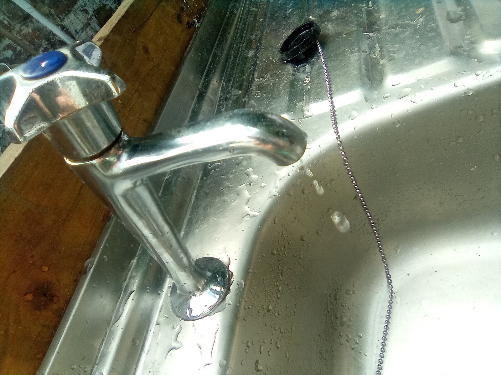

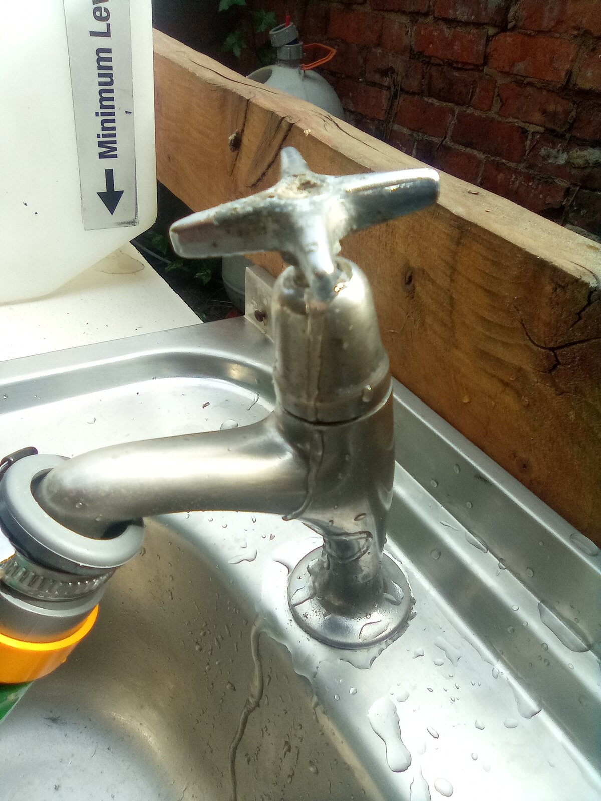

So taps on the same sink, but bough have leaks
Can they be repaired or need replacing
TAP NUMMBER 1
Yes. In both cases there will be a screw in the centre of the tap knob, holding it on (prize off the blue cover on the first tap)
With the knob removed on the second tap you can then unscrew the domed but that the shaft sticks out of
On both taps you should now have access to a valve mechanism that can be unscrewed to reveal the washer (or lack of) that will have failed
Post up more picks of the valves when you've got them out, for further advice

on TAP 1 I took the blue cap off and unscrewed the acrew. But it wont shift! I mean the top of the tap will not come off by threading it or pulling on it
on TAP 2 the head on the screw is in to bad of a condition to take a screw driver
Cheaper than the other option if you can't disassemble them, of paying someone to sort it
Years of limescale will make your life harder, but persevere, perhaps with a remover fluid
It doesn't seem like you have much choice.
Look for some recycled ones if your budget is that tight, but £30 for a pair of taps doesn't seem out of reach.
