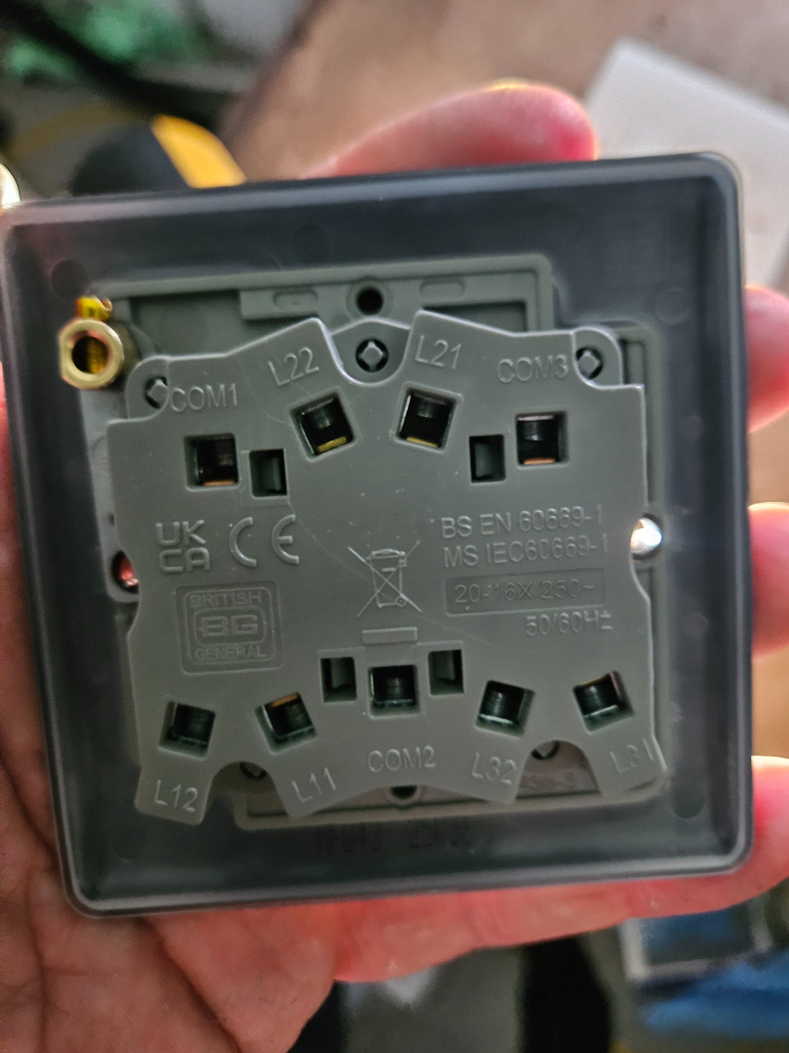

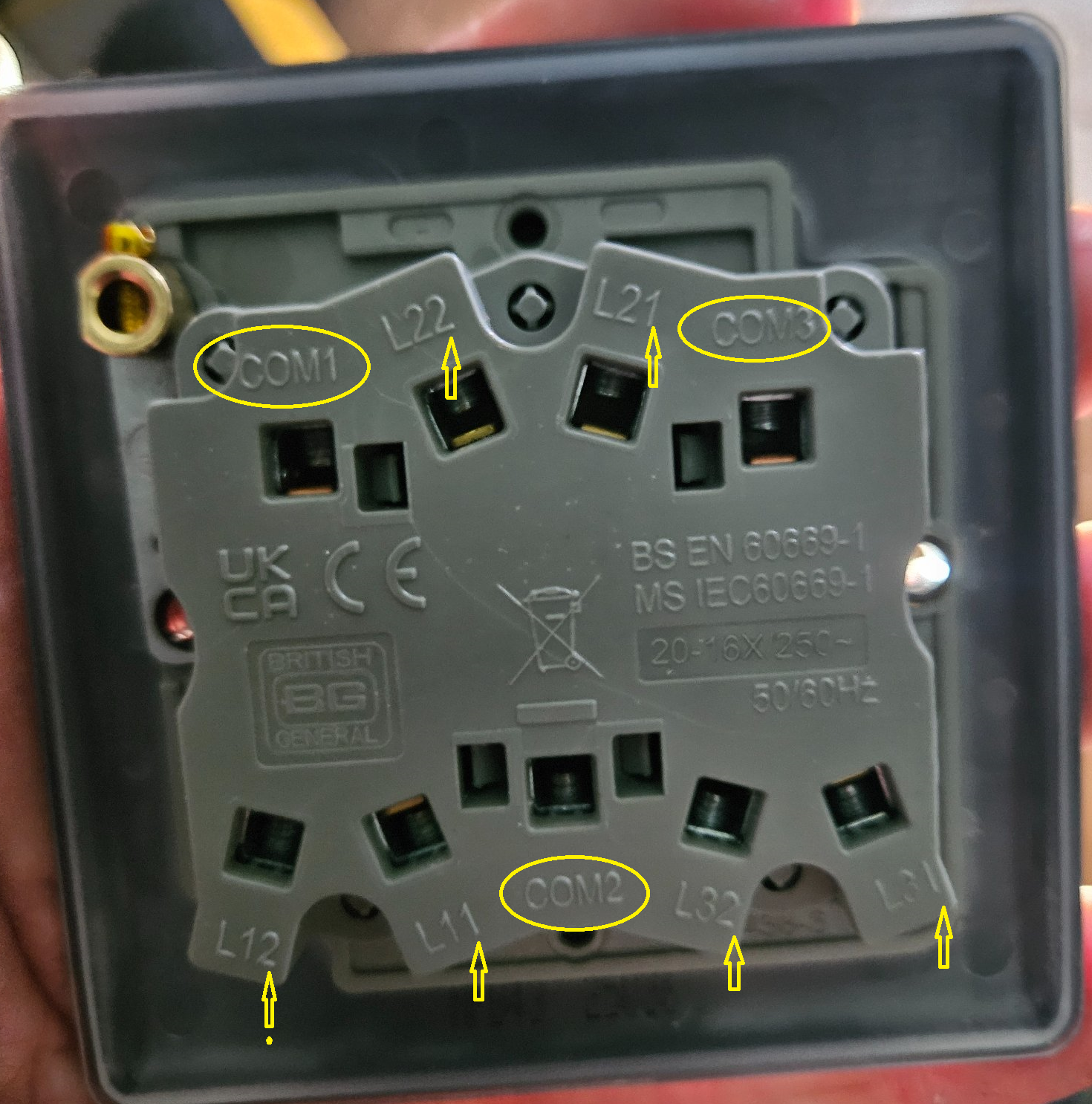

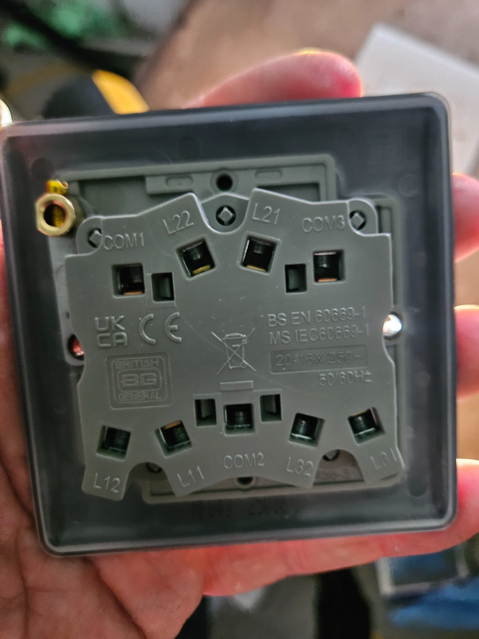

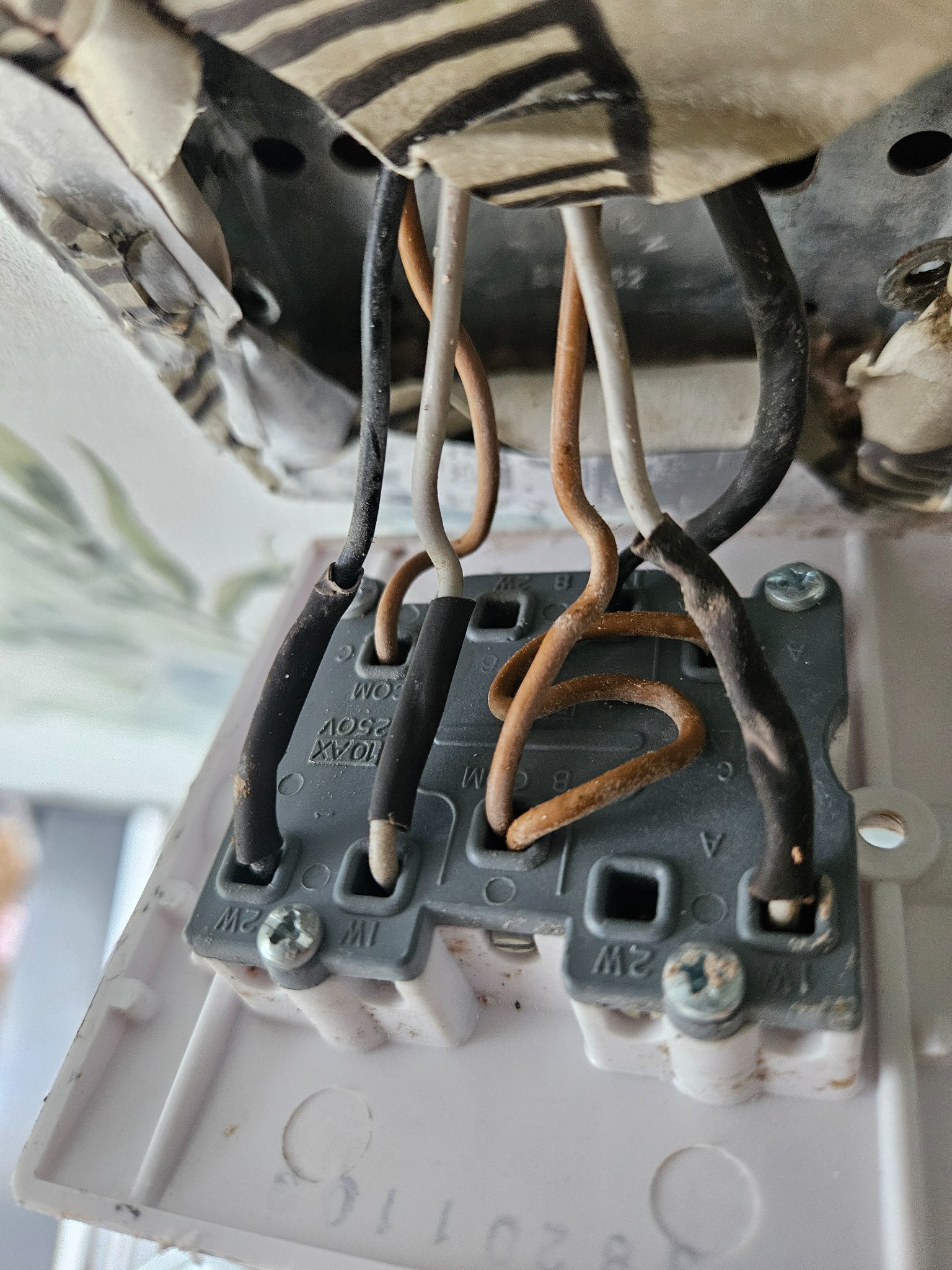

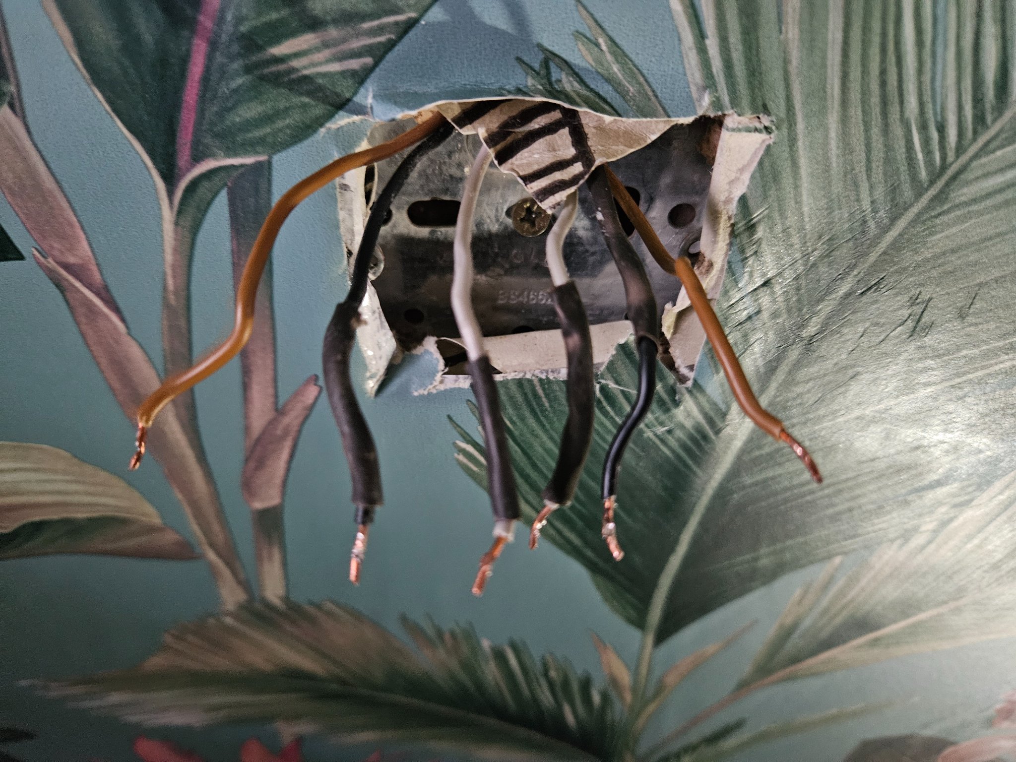

Hi
Needing a bit of help please !
As you can see in pictures i have the old 3 gang wired in and a picture of the new one.
Do i need to feed 2 com then bridge the other one as well like the old socket ?
Any can anyone point me in the right direction of where the other 4 go in the new socket

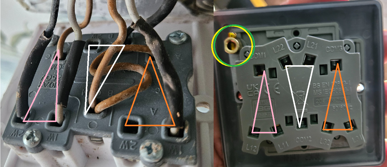

Which one goes in what on the new one though because the numbers are all different
First of all you must provide an earth wire to the earth terminal if the new switch is metal.
There are 3 triangles of contacts on both switches, just transfer the wires contact for contact and you'll find the number start making some sense.
What are you looking at? They are both exactly the same.
Ignore the lettering - although even that is similar.
Think the first numbers and letters threw me from the old one .
There was no earth in original think its earthed to back of the wall do i earth it to socket ( its plastic )

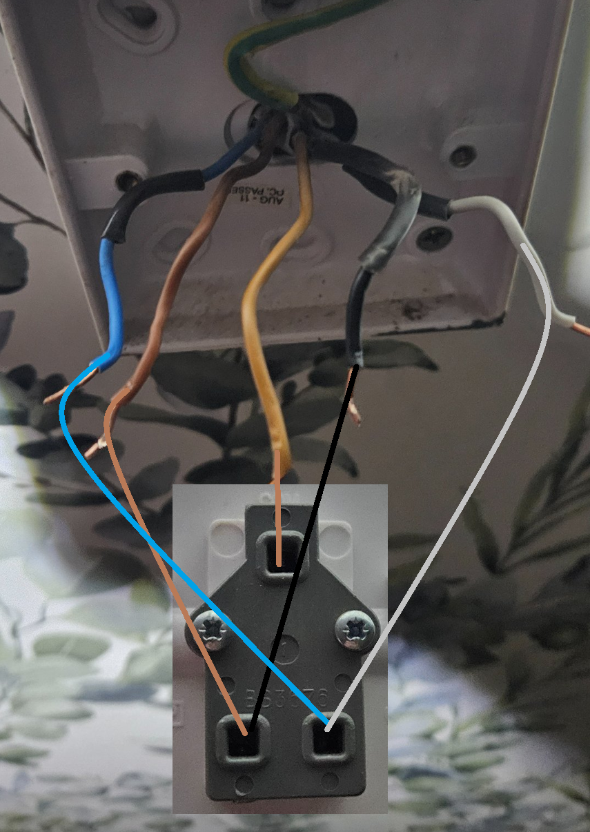

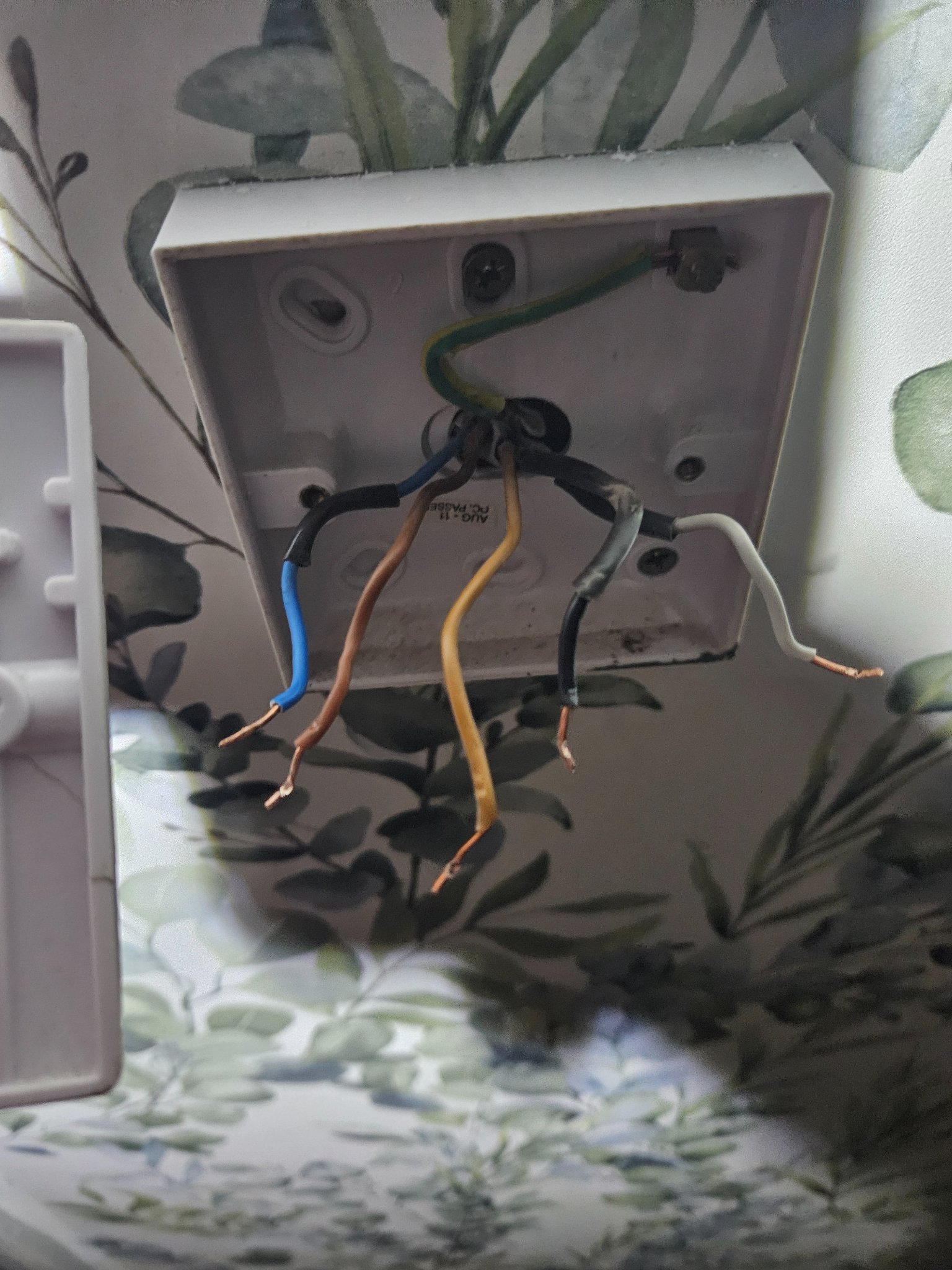

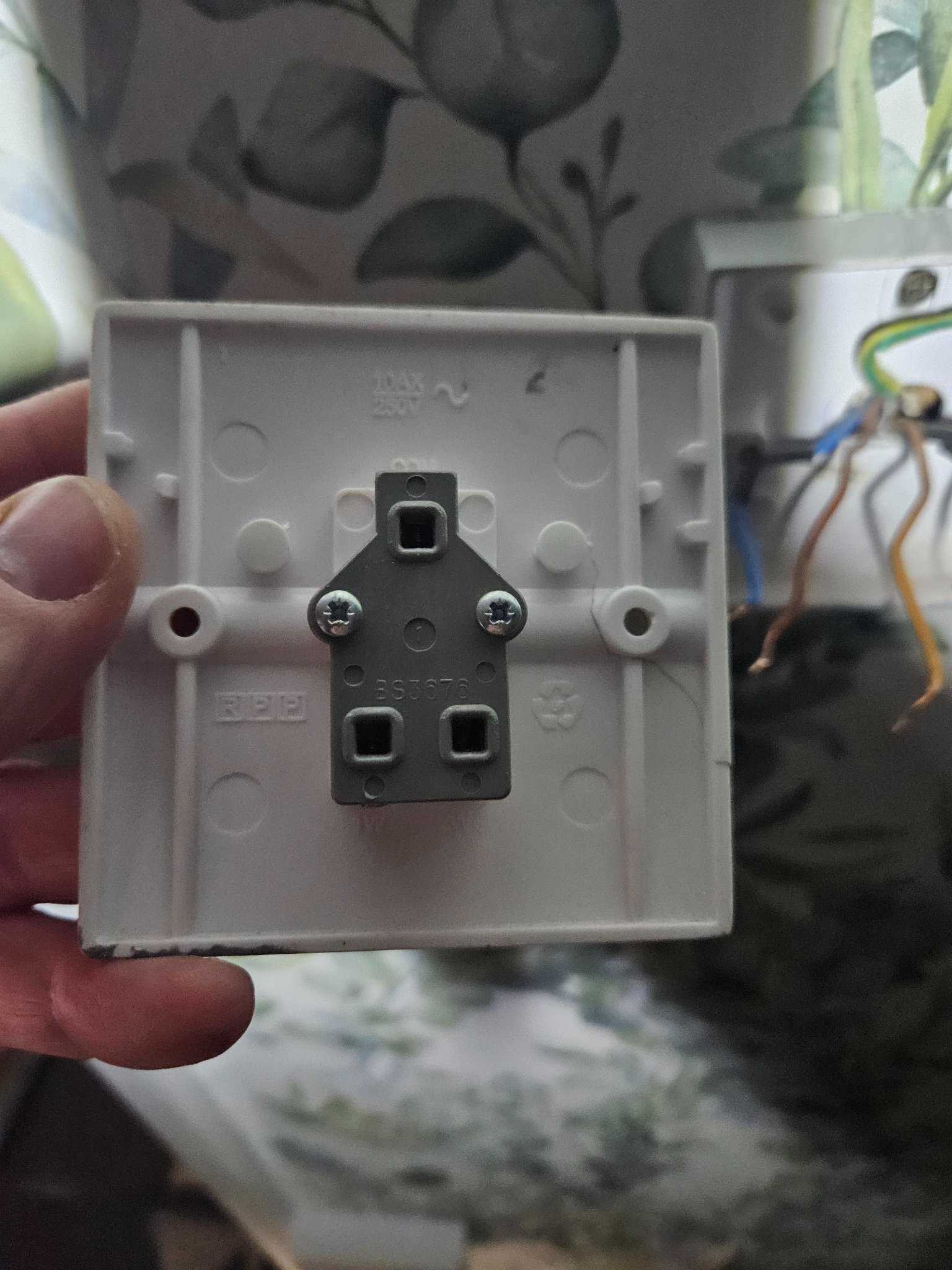

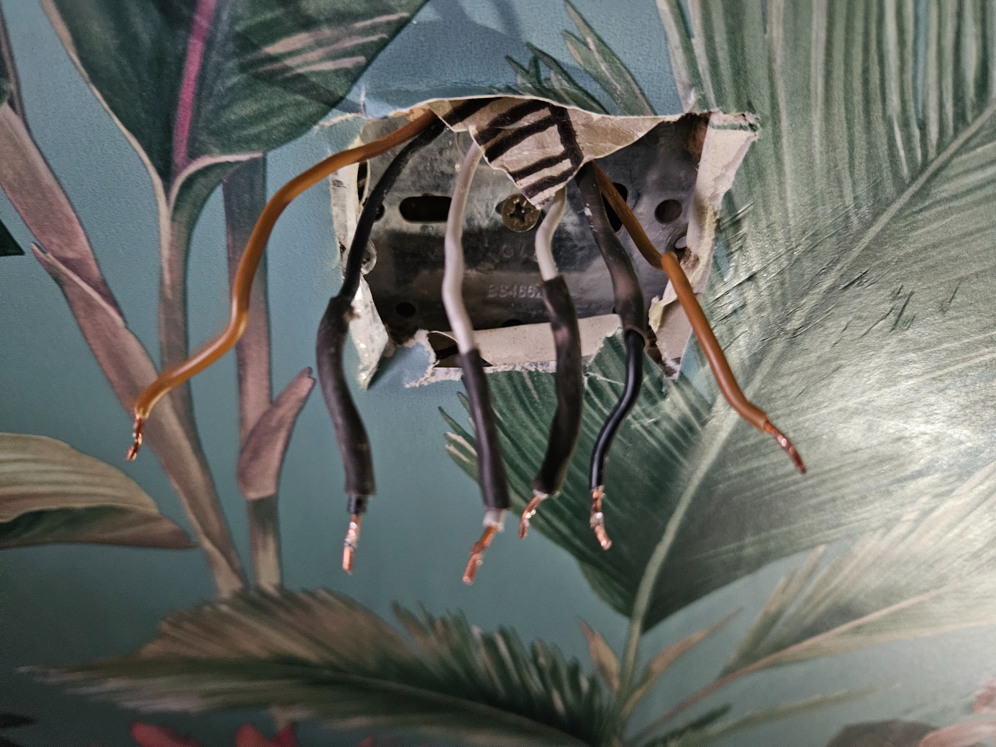

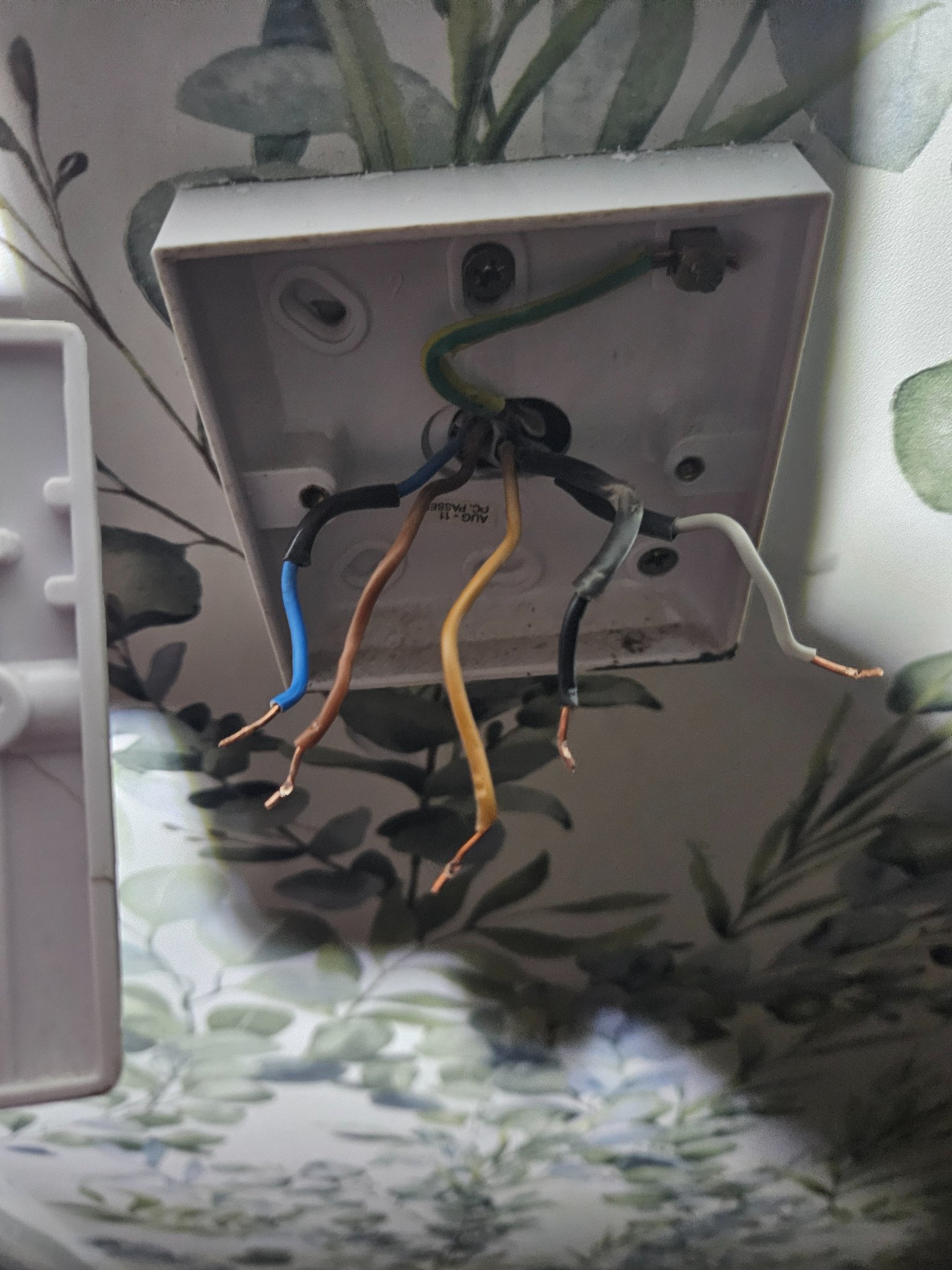

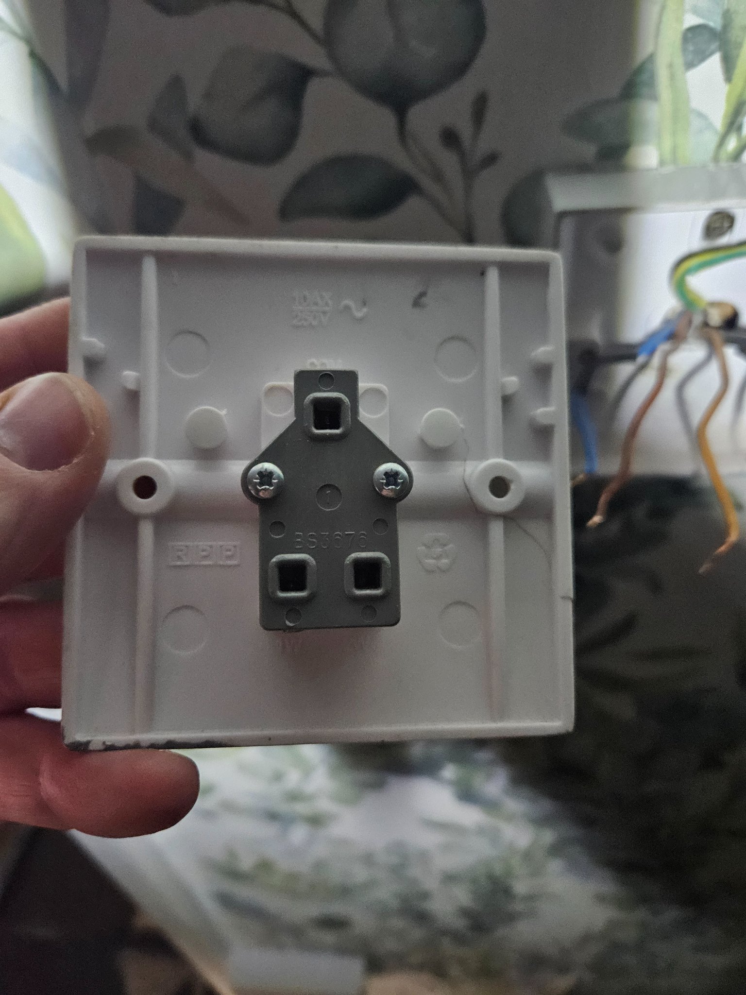

All sorted with the other one now iv made a absolute error and took this off without taking a picture any ideas from anyone ?

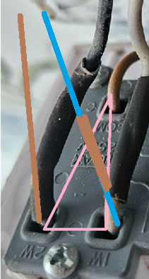

If this is the other 2 way switch to the 3 gang already posted then this
Thanks mate seems to be working but cant turn it off from downstairs now for some reason but can turn it on.
So if its on upstairs i cant turn it off using the downstairs one.
The brown in com is from the same cable as the black and grey
The brown and blue I've drawn are from the other cable
You have got an earth connection sorted to any metal switches?
