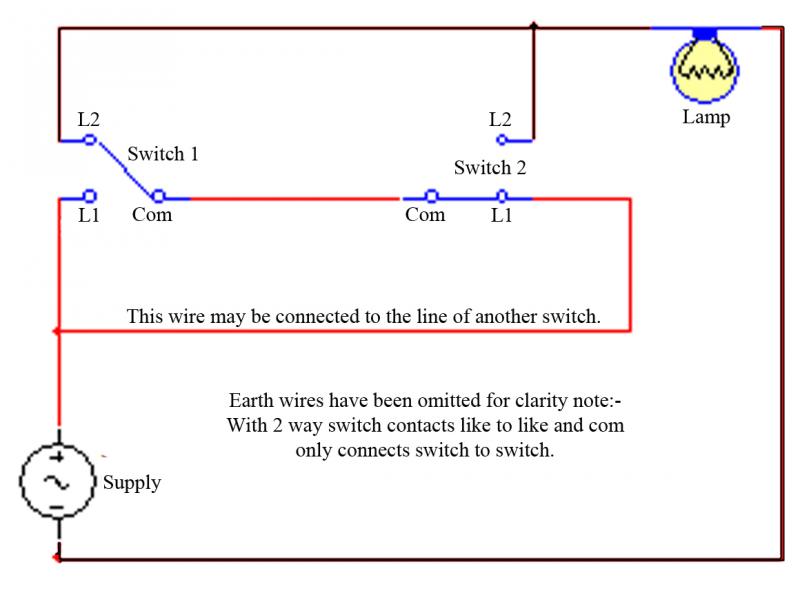

On a two way switch used as two way switch the line supply and switch wire go to L1 and L2.
On a two way switch used as on/off switch the line supply and switch wire go to L1 and Com.
With a two way switch the other switch of the pair is wired like for like so Com to Com, L1 to L1, and L2 to L2.

Shown above is the basic circuit diagram for two way switching.
