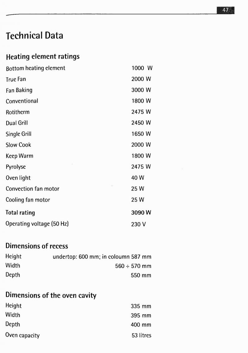

3090W oven flex
Europe and the UK standardised their declared residential supply voltage as 230V +10%, -6% nearly two decades ago. It's only the fact that the average voltage of supplies with a declared voltage of 230V must be somewhat over 240V that some incorrectly think that the UK still supplies at a nominal 240V. The typical voltages in the UK and Europe are now similar.
The tables of cable sizes etc. are for use with a nominal supply voltage of 230V (unless noted otherwise). They include the assumption that the actual voltage will vary by ±10% or so at the point of use.

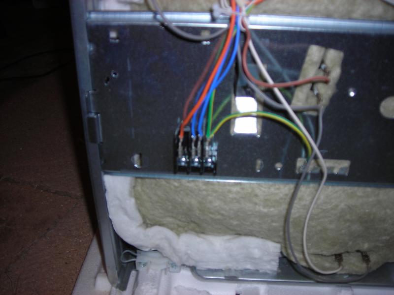

Why does it have to be such heavy flex when the singles used inside the oven look rather thinner ?

Surely if anything a larger cable should be used in Europe, as they are on 230V and we are on 240V(ish).
Should draw 13.43A at 230V, but only around 12.87A at 240V, more than within the capacity of 1.5mm^2 flex.
Colin C
Here we go again..... The load is resistive, so the power will INCREASE if the voltage is increased :roll:
The resistance is constant, not the power.
D'oh! That's what I get for posting at half 3 in the morning! I should know better too, being an electronics student lol.
Let me try to redeem myself...
Drawing 13.42A at 230V, gives the appliance a resistance of 17.14R. At 240V this will draw 14.00A, possibly damaging a poorly assembled 13A plug?
Colin C
13A will also damage a poorly assembled plug.
BS1363 requires plugs to be able to withstand 14A.
