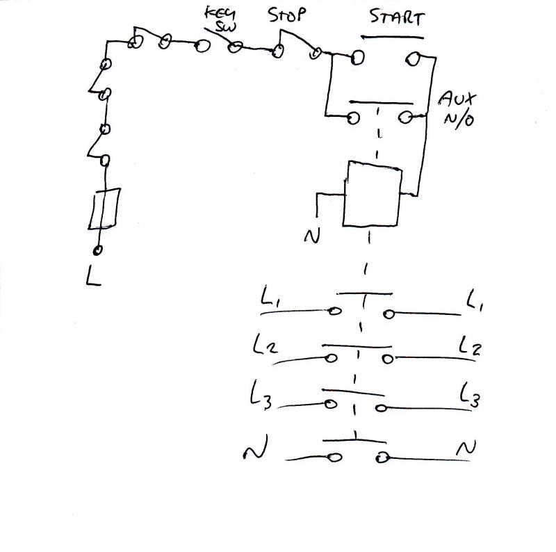

Hi, Im looking for some connection diagrams/pictures of 3phase and neutral motor start/stop connections, would anyone in here have any links I could have a look at? I have tried google with little avail.

As the motor is a ballanced 3 phase load there is no need for a neutral, however a neutral may be used in the control side if it is 230v. The control side may be any voltage sufficient to drive a contactor i.e. common size contactors I come across are 24v, 48v, 110v, 230v and 400v.
What type of motor control are you talking about, direct on line (DOL)? If so there is a similar diagram here:
As you don't need the neutral ignore the neutral contact at the bottom, the normally closed contacts on the left hand side are stop buttons.

Yes its a DOl starter. The manual says It needs a neutral, I can't remember off the top of my head what its for but I think its an air brake. Aswell as the 3 cables going away to the motor it has a two core flex. Its a second hand machine and it looks like the starter is not standard. I wanted a picture as Im not sure if the neutral should go into the top and through the contactor aswell as the 3 phase supply.

Getting back to the O/P: I'd say that the DOL starter needs a neutral simply because the hold-in coil is 230 Volt - as they often are. But this doesn't mean that that neutral has to be taken to the motor itself......

The O/P, Chris-the-Scot, hasn't actually implied that the motor itself needs a neutral. He's surely on about the control circuit of the starter and perhaps, the wiring of remote start/stop buttons.

Thanks for your help. As you can tell Im not as familier as I would like to be with motor control. I dont think the neutral is for the coil, I think the neutral is for something to do with dust extraction and I think the saw motor will work without the neutral connected. The neutral does not go to the motor itself but it is terminated inside the starter.
I think the neutral is for something to do with dust extraction.
Could be a single-phase extractor.
I believe that sometimes motors have single-phase anti-condensation heaters.
Or as others have also said, single-phase components in the control systems.

as others have said, the neutral is most probably required for the coil in the start/stop gubbins.
It may also be the case that the 2 core flex you refer to is a thermistor or other thermal device. If it is (which you need to find out) then it should be included in the control wiring
The two core flex is probably a thermistor which should be incorporated into the stop circuit. It's purpose is to stop the motor if it overheats.
