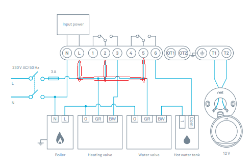

We've just had a new boiler put in and an unvented cylinder, while they were doing that we thought it would be a good time to have a Nest installed.
We had one in our previous house but had to leave it when we moved.
Anyway, it's in and appeared to be working okay but I've noticed the hot water doesn't come on, even when scheduled, unless the heating is actually on.
I've taken a picture of the wiring, and the guy who fitted it is coming back but thought I'd ask for advice on here in case it would help him.
Your Nest installer should be able to figure out that the Commons have been left out and doubt it would have worked at all, other than the green light.

So is it wired incorrectly?
What works at the moment:
Heating comes on if I rise the required temperature
Hot water comes on if I press the boost button (this worked earlier with the heating not on)
Hot water doesn't come on based on what the schedule defines (I added a test schedule earlier and watched it, with the heating not on, the water didn't come on)
Ah, by commons do you mean T1 and T2? Just checking the install guide. The thermostat hasn't been fitted to the wall, we're using the stand.

Yes wired incorrectly. The commons are the live linked to 2 and 5.
Unfortunately this is only half the story. To give a definitive answer we would need to know what the other ends of the wires are connected to.
You actually have wires in the correct terminals for an S-Plan system with two x 2 port motorised valves, (some installations also require a wire in terminal 4) However, It all depends upon what is connected to the other end the two wires in the common terminals 2 and 5. If they are both connected to a permanent live at their other end it would work.
However, as has been pointed out it is usual to link 2 and 5 to the L terminal as I've highlighted in the diagram from Nest below. But there is more than one way to skin a cat. (if I'm allowed to say that these days :))

Thank you, the installers are coming back out tomorrow to take a look at the wiring. :)
