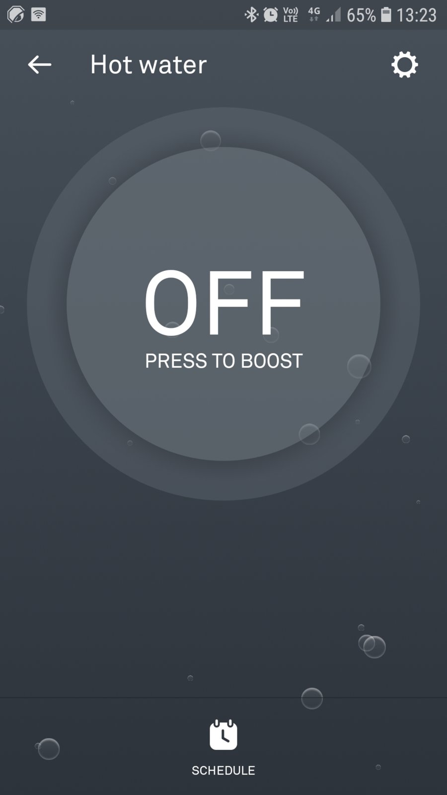

Ok, set it up as a system boiler, just testing it all now. Hot water control has appeared in the app, however I can't turn hot water on/off? If I turn on hot tap & drain the storage tank in boiler, the boiler kicks in & reheats it, this is what I want to stop it doing when I'm away.
In the app it looks like dhw is turned off.. but it's not. Presumably this is because the boiler is wired to have dhw always on, so engineer needs to change this back?

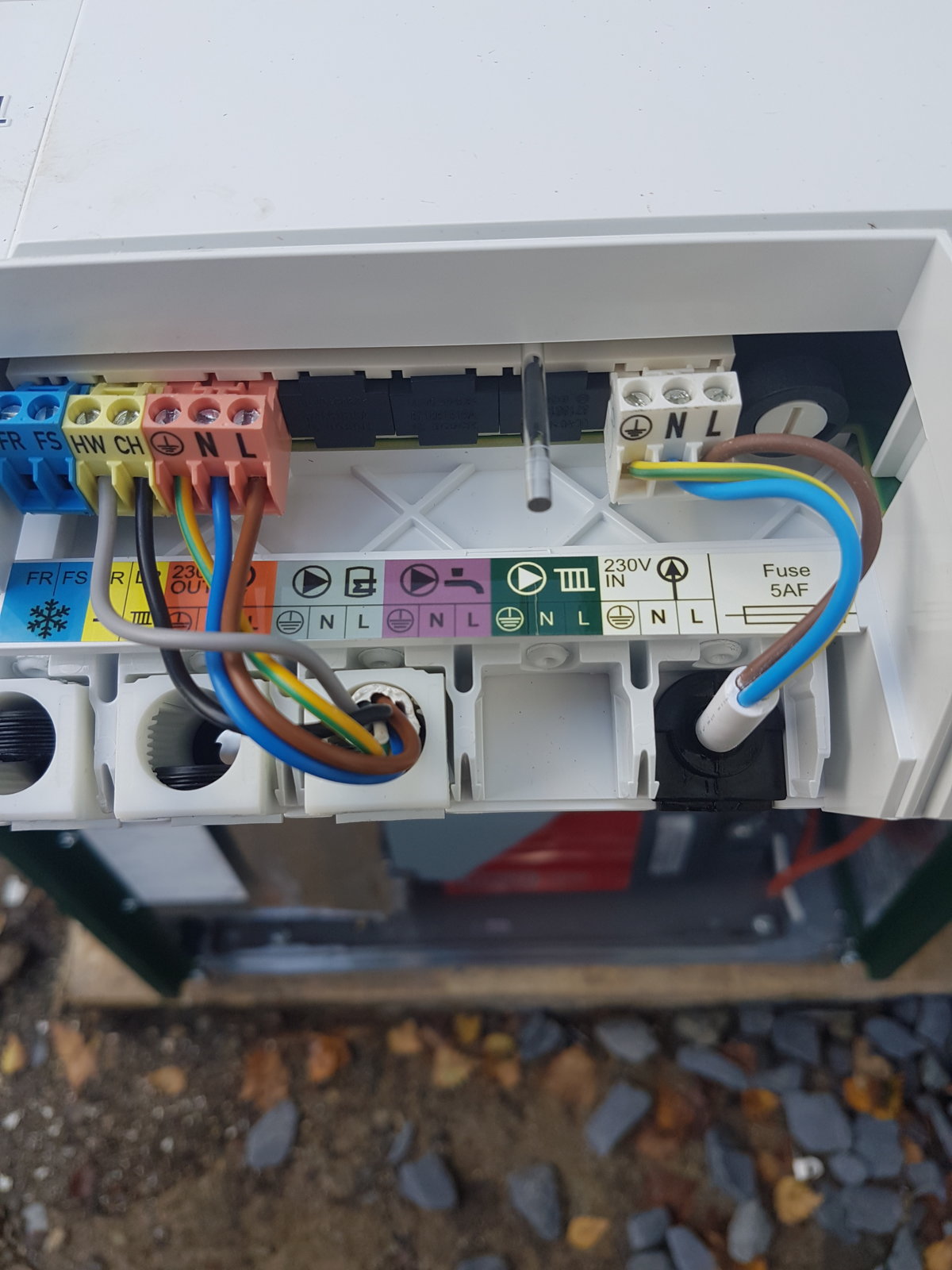

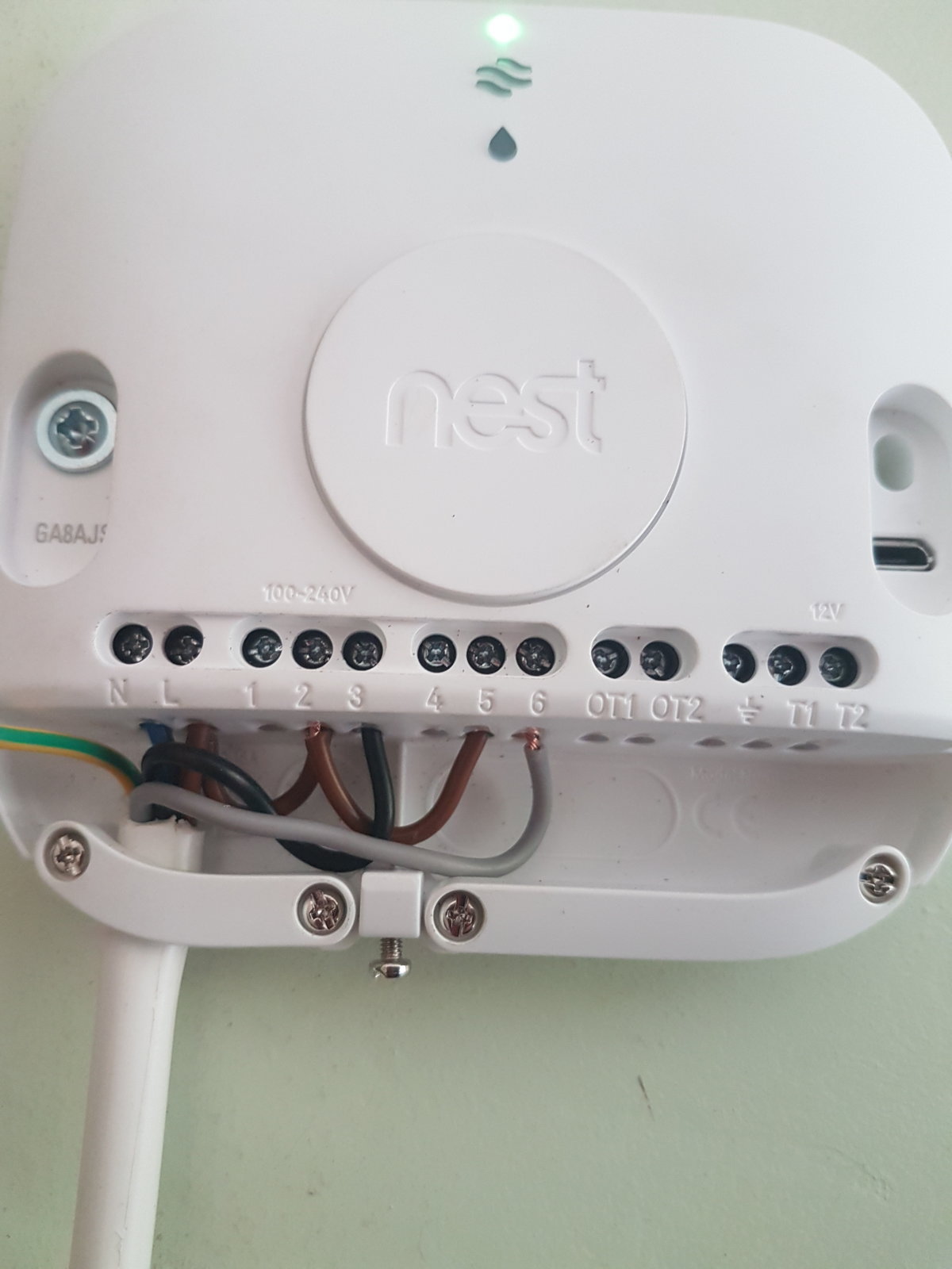

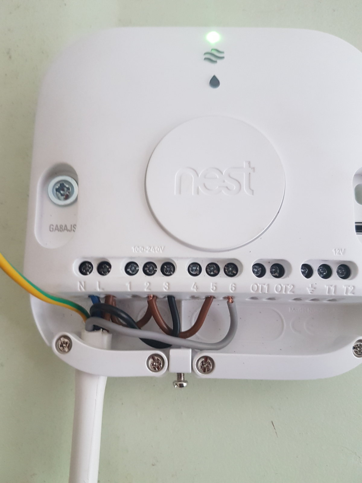

Ok, got it set up so that the hot water isn't 'always on' and is only on when called for by Nest... however its still always on??
In the app/stat I have hot water turned off, yet using a hot tap causes the boiler to fire up to reheat heat store.
Assuming that is a continuous cable from the boiler to the Heat Link then the wiring is correct. The boiler will always fire up when you use a tap though, as there's a flow switch inside which tells it to do that. How long does the boiler continue to fire after you've turned the tap off again?
I ran the taps for a good few minutes to drain the heat store, the boiler fired up during this and continued to run for a minute or two after I shut off tap, I think it ran until heat store was up to temperature again (it read 63° on display).
