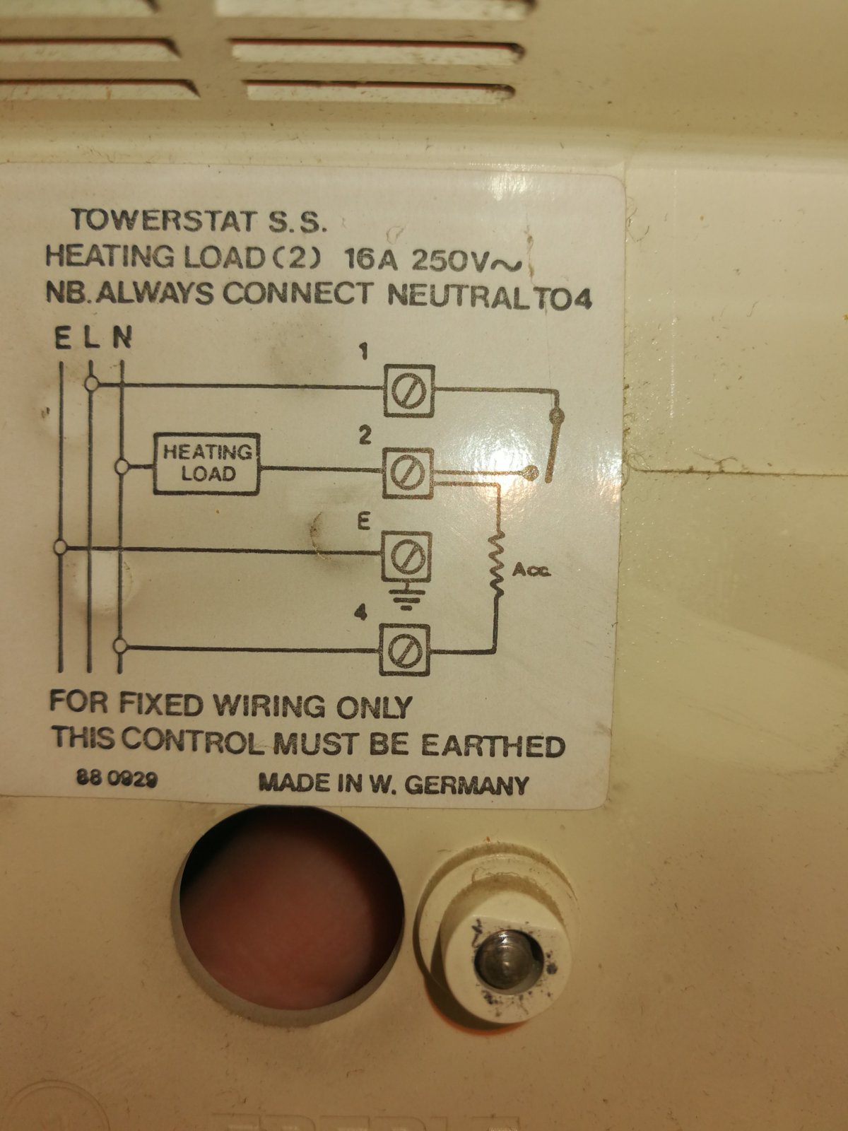

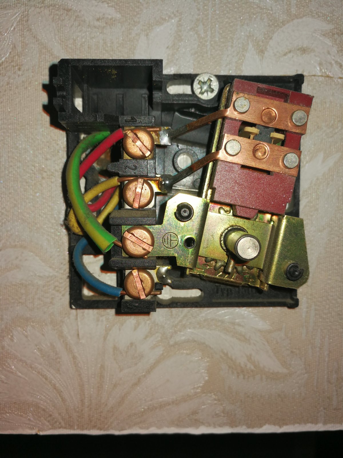

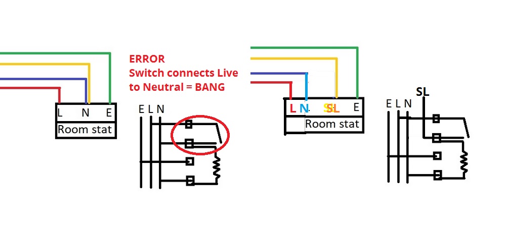

Hi all I need to replace my room stat on our central heating
our current one is a 4 wire stat and the new one is going to be a 3 wire stat
the old one (towerstat) has a live earth and by the looks of it two neutral wires
Am I right in thinking the two neutral wires just need to be connected to the same point on the new stat (honeywell T6360B)

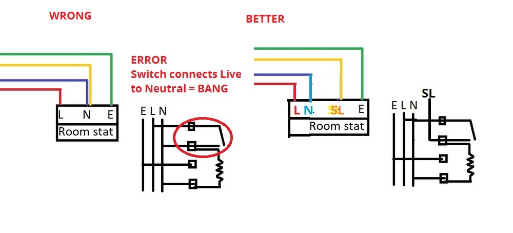

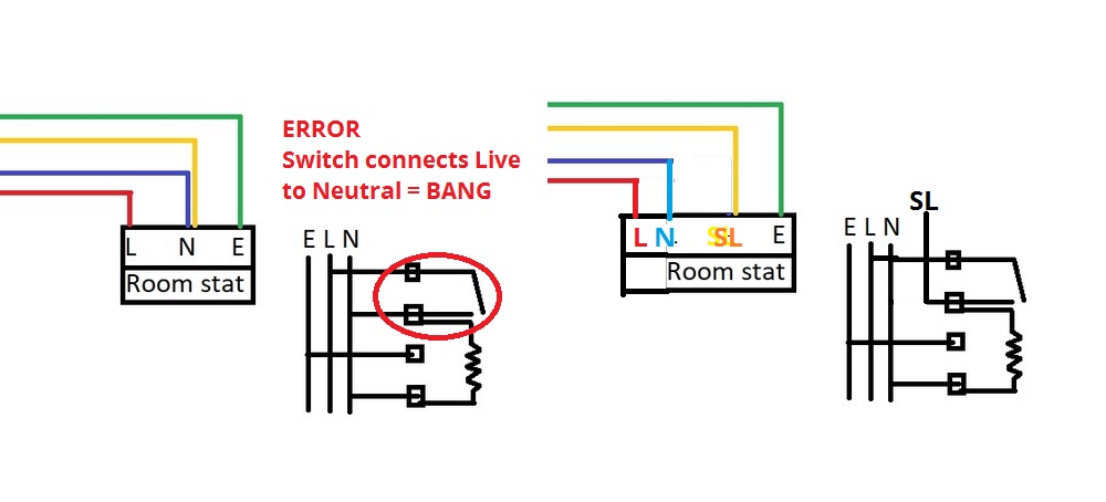

Here is an awesome wiring diagram of our set up if it helps at all :mrgreen:
Don't you just love microsoft paint!!
Thanks.
The Red Live Wire in 1 goes into the Honeywell 1
Yellow Switched Live in 2 goes into the Honeywell 3
The Green/Yellow Earth in 3 can be connected to the earth tag in the Honeywell.
Blue Neutral in 4 goes into the Honeywell 2

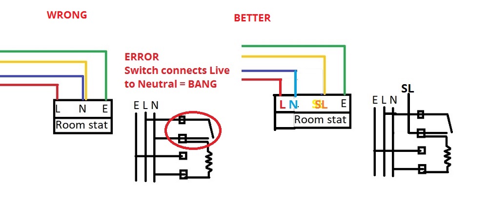

The only sound advise being to have these works carried out by someone who knows what they are doing (term 2 is not a neutral).
Do not switch the Live to the Neutral but instead to the Switched Live
That wiring diagram is how its wired now
The LN and E terminals are what's just taken off the wiring diagram on the old stat but the terminals are just numbered inside
After posting I soon realised one was a switched live

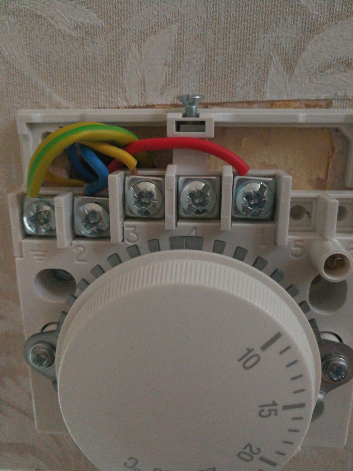

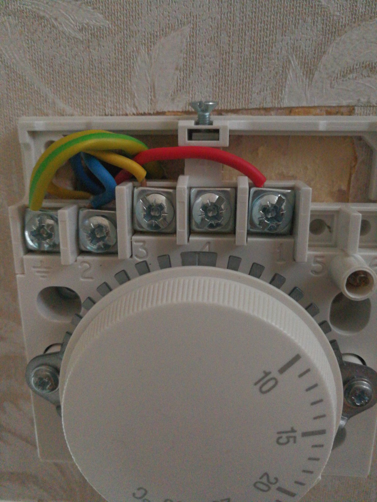

Can you post a picture of the new thermostat wiring just to make sure? Plus confirm that no other connections in the system have been changed.
Sure thing here ya go
Just to point out I missed a S/L in my first wiring diagram on the first post this runs from terminal 10 to the boiler if that helps at all
Thanks for all the helps so far
Looks good.
With the power off... move the yellow wire in 3 over to join the red one in Honeywell terminal 1.
Power up and check that the heating comes on permanently.

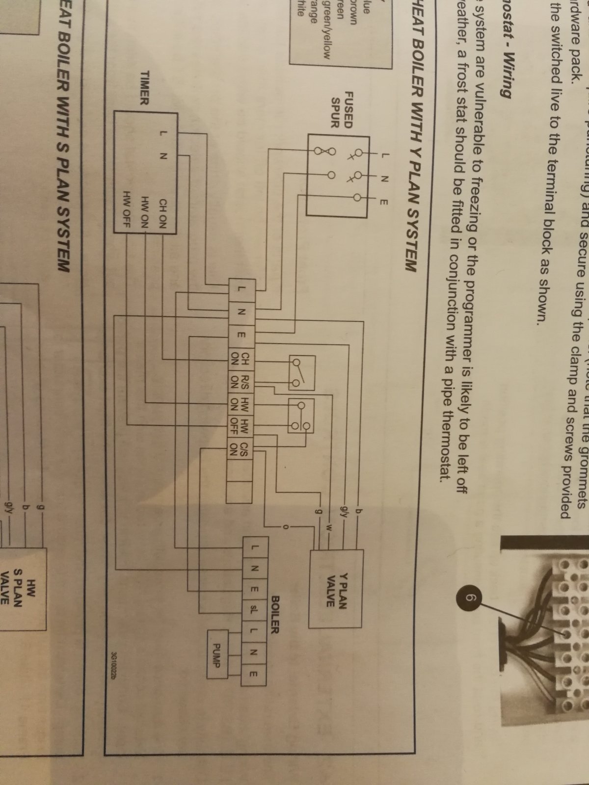

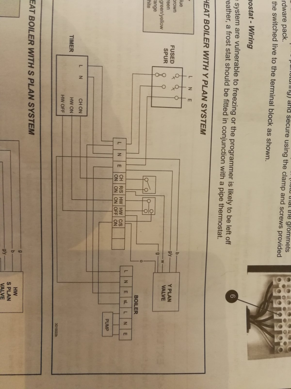

Or I could just pull it all out and wire it to this what's in the manual for the boiler!
