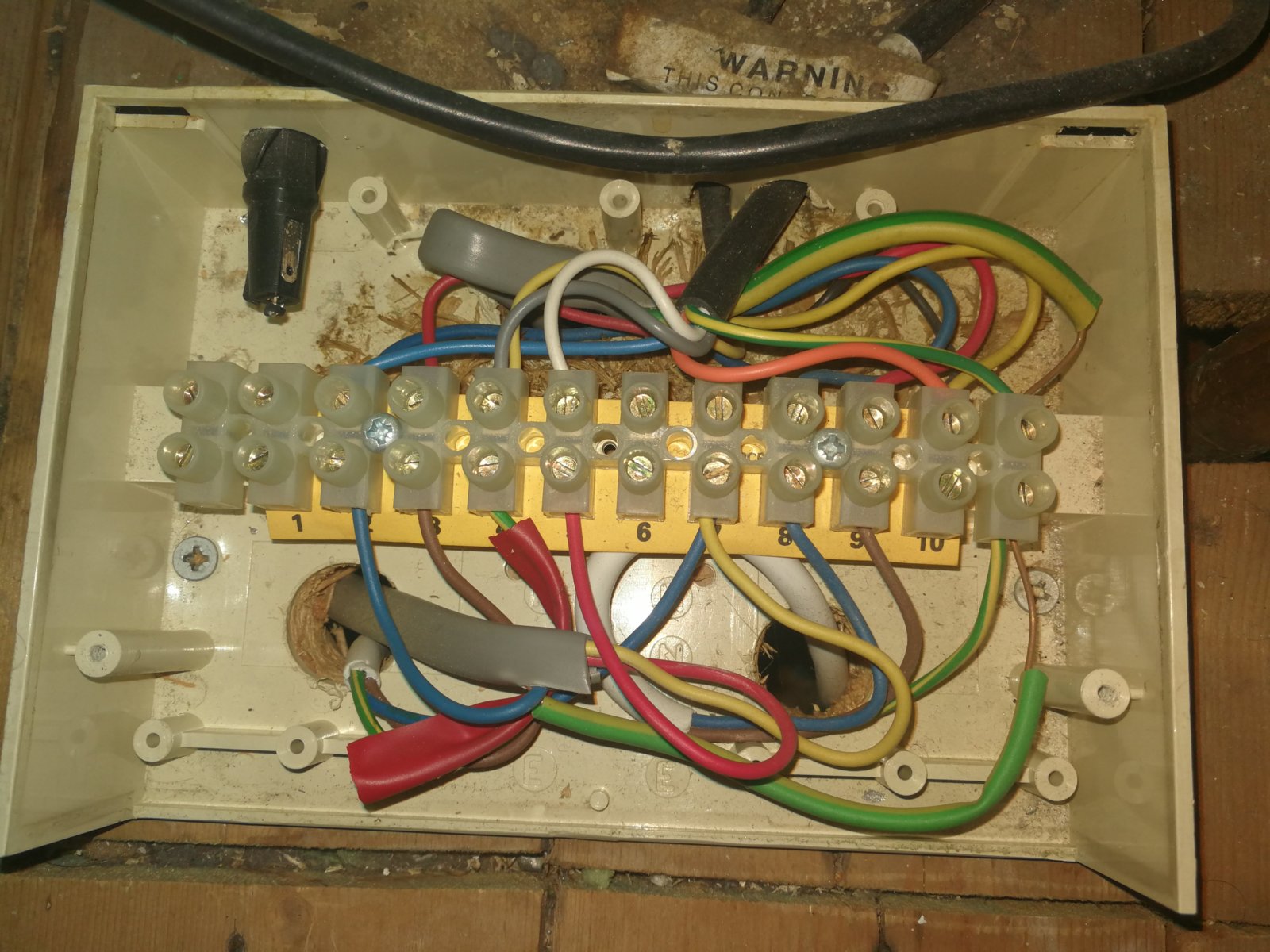

Can you post photos of the wiring centre?
I can indeed but be warned its a bit of a mess if you ask me!

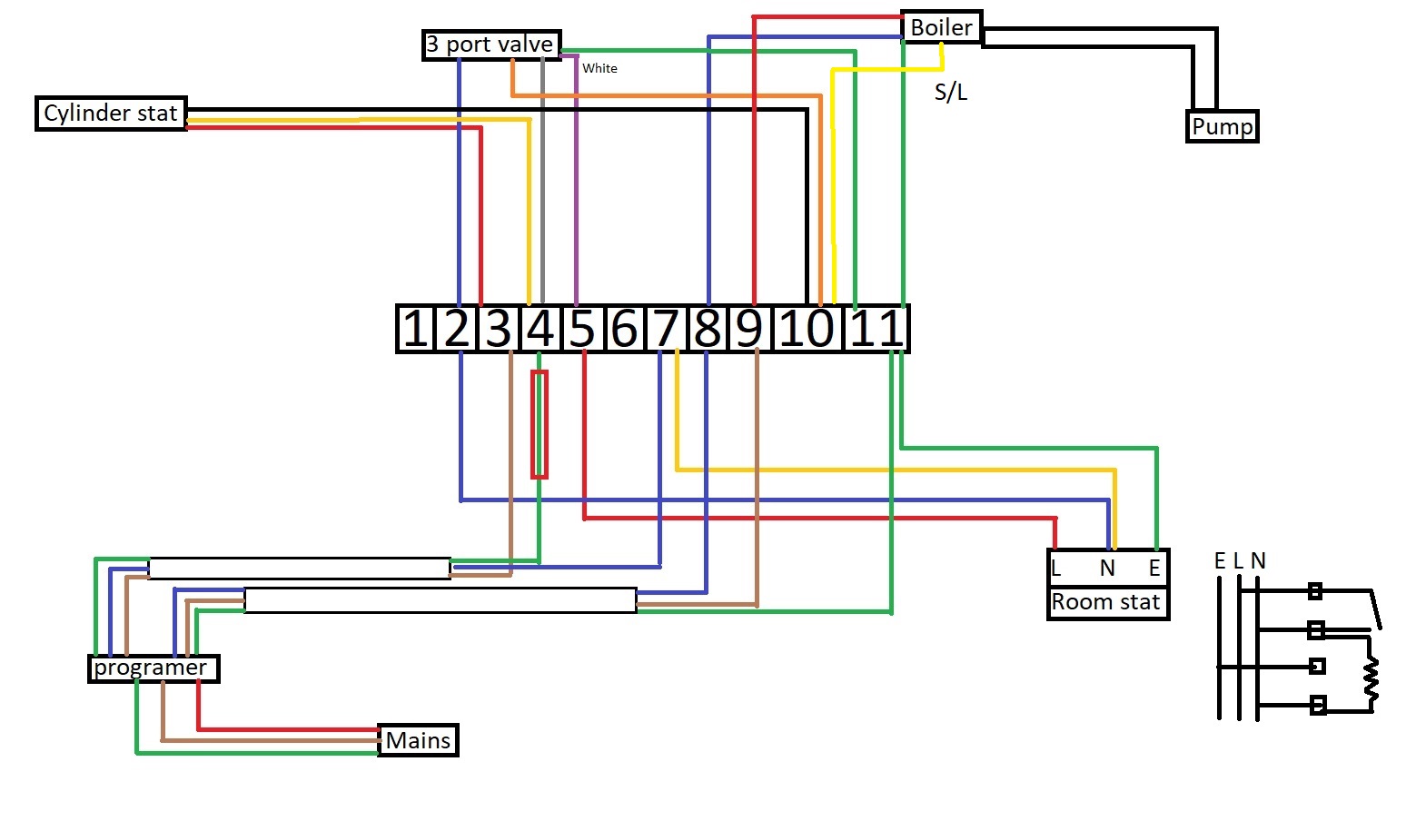

I did draw a diagram with paint to make it easier I have attached it to this post

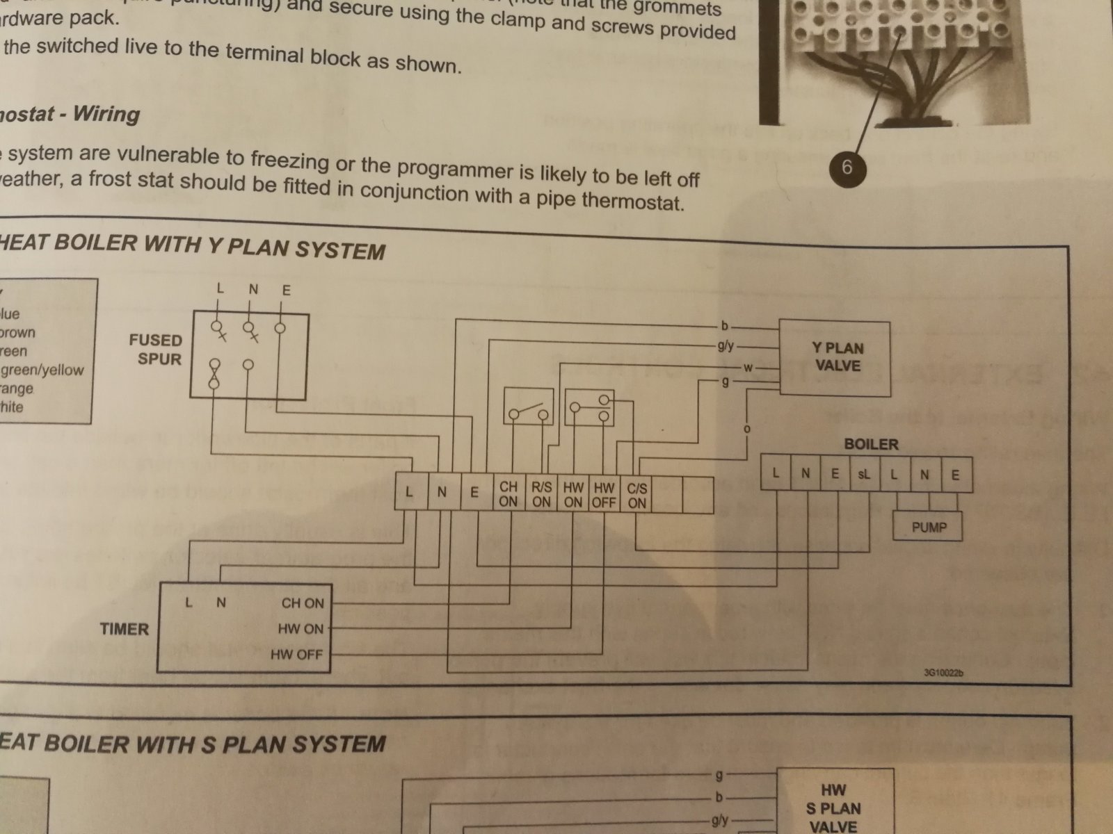

I have included a wiring diagram from the boiler too (ideal logic heat 15)

You are right about Yellow being Live to the Thermostat. Overall the colours of wiring in use are confusing and the wires could do with some coloured insulating tapes to identify each end. You wouldn't normally expect blue and yellow/green wires to be at 230V unless clearly identified as potentially Live.
Hard to tell from the photo but is there a blue link between 2 & 8 so the valve and room thermostat get a Neutral connection from 8.
Yeah I spotted it and just been up and double checked!
